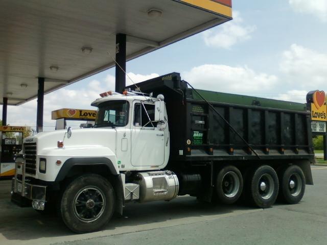

I'm really starting to think it is the harmonic balancer, its just that no one ever suggested that. I have a guy that works with me and he has a 01 427 and complained that he had a bad harmonic balancer and described it to me as just getting louder as the rpms went up and more vibration It was enough to make it annoying for him.. He said it helps keep it quiet. I don't have that problem i just have that shake as i was demonstrating and i think i almost have as much power as his 427. On that same pull in my video i asked him to track his speed and he got to 50 by a certain spot and i got to 48-49 and another guy with a Freightshaker 350 got 42 lol

Here is another video from today. It's just to show you i think the truck is making power, maybe you will hear the miss maybe you wont. That shake at that rpm band annoys me though, its only in the 3rd and 4th gear loaded is when its most noticeable.
Give me your expert opinion if it seems like a good runner.
