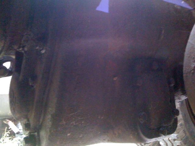

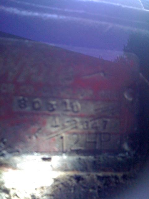

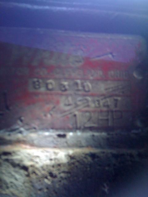

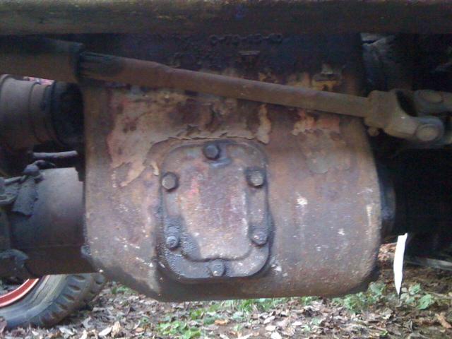

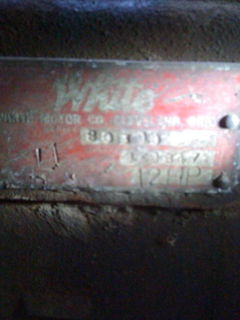

I happen to look at the auxilary transmission in my LJ tonight, i always thought it was a spicer turns out its a white transmission. White Motor Co.
Anyone got any info on these transmisiions?
First number is 80310 or 80310.
Second number is 4?8847 or 4?0847
And at the bottom is has 12HP stamped on the tag.
Its a 3 speed devorced auxilary.
I believe if the tag in the truck is right it is a lo direct and over trans.
Any help greatly Appreciated...
Thanks Paul

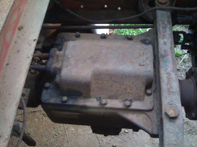

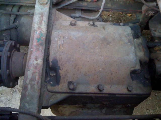

I`m going to get info off of the main and photos of the auxilary tomorrow on the LJ. And double check the main and auxilary on the B81 for any numbers.
While we are on this subject can anyone send me a photo of the cross section of the 8031 case?
And i found a 6041 spicer would that hold up as a od trans behind a quad box?

Are you sure it's not 8031C. That would be a Spicier number. There was a time when White put their name on anything they sold. Like "White" Freightliner and "White" Western Star.
Guess im going to try and find one of these transmissions. 8031C
