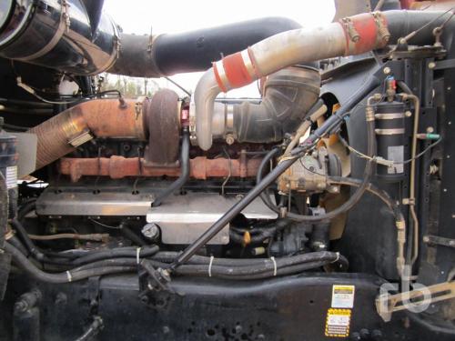

The air quit yesterday on 80 R-model. Disastrous! I tilted hood late in the evening, and checked wire to compressor and it looked ok and was intact on compressor. I could find no pressure switch anywhere under hood, on dryer, near dryer or anywhere. I traced compressor wire to where it goes through grommet in firewall. Grandson got on top of engine and I had him gently push and pull wire while I lay inside in floor looking under dash, (it is cramped too!). Lo and behold, wire had come loose! It is a factory installed Red Dot under dash unit, and i cant for the life of me find where that wire came loose from! Would that wire go to the actual AC switch? There is a switch on front of unit that says heat and AC. Would that wire go to cage motor? Im figuring pressure switch is under the unit somewhere, gonna go back this morning, (didnt have flashlight with me yesterday). Yall gots any ideas? It hit 107 here yesterday. Thanks all,,,randyp
Does the wire look original or like an after thought? I've never seen the pressure switch inside the cab. Usually it's close to the dryer.
I havent either David. The wire had been spliced into the compressor wire about a foot from compressor. It doesnt look like the original factory wire, but is only wire going to compressor. The dryer is mounted on right side frame rail beside engine, and no switches anywhere. Im guessing pressure switch has to be inside cab with unit or sumpin. It definitely is not anywhere under hood or on outside condenser. Its kinda puzzlin. Thanks, randyp

Could pull power from the switch or the fan. Here's a pressure switch pic.
Thanks David, well, my dryer is plugged off where the pressure switch should be. I dint work on it today, went out to jobsite early this morning with intentions to, got busy motorblading, it got hot, I came home and busted a ice cold watermelon open, now am gonna take a nap like old folks are posed to. randyp
Well part 2 of this saga. I got up from lil nap, went out to jobsite, found me a small shade tree and parked truck under it and had hood tilted up and scratching my head. The landowner Im working for now lives in Houston, bout 6 hrs. away. He drove in, and after small talk, asked what was wrong with it. I explained it. He asked if I minded him checking it for me. I said no, have at it. He then told me he had been making a living doing air conditioning for the last 30 years. Wow!! He explained where wire went, hooked his gauges to unit, hooked wire up, and all is working fine now! He said I was just a tad low on R-12, but he had bout 100 pounds of it back in Houston and would bring some next week and fix it all up for me. He didnt charge me a dime, wouldnt take anything. He said it wasnt missing a pressure switch, it has the lil probe inside on cooler, and all that controls the compressor. I think he was kinda glad to work on one that old,,80 model. Oboy, Im cool again!!!! randyp
