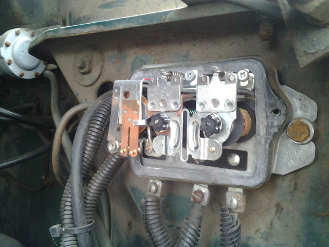

Truck not charging!
I take the back generator cover off mine, spray lectra clean in it, blow it out, and while its running, hold a stick of commutator cleaner on it and clean rust off commutator. It usually perks up and goes to charging. Also check all other stuff they mentioned above. randyp (the cover I mentioned above is to the brushes)
