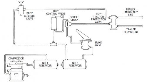

3! Thats what I was going to ask now.. do I cap that extra line?
You don't. One line is the service, (blue). The other is the emergency, (Red). The last line is the actuator which connects to your dash valve to operate the valve.
Rob
The TP-3 valve uses only two lines...the push button on the dash not only charges the trailer, it opens the valve so that the service chambers on the trailer work when you step on the brakes...I dont think you are supposed to use a flip style switch with the TP-3
