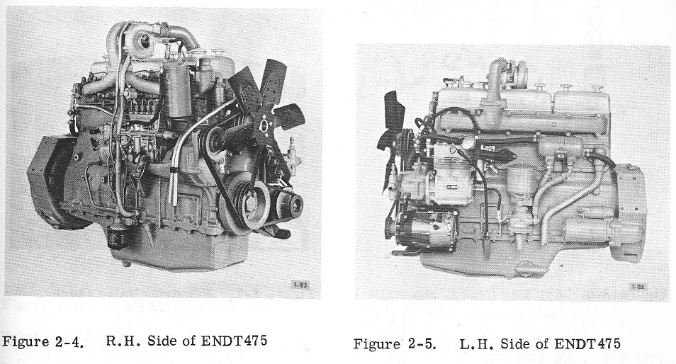

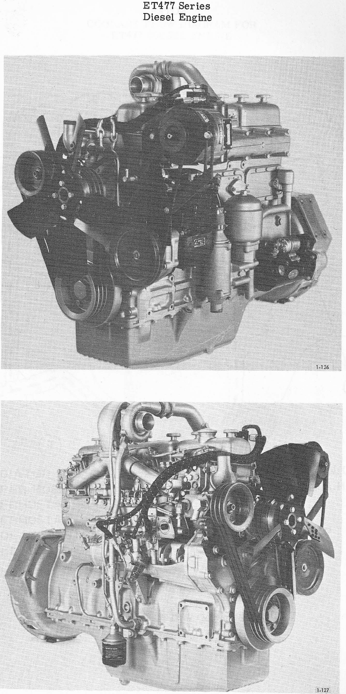

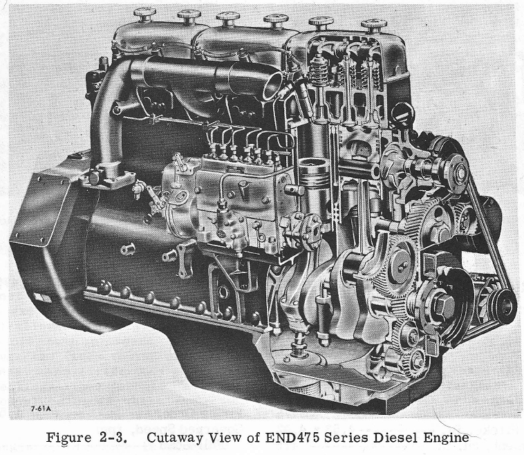

Mack made the END465 & END475 in conjunction with Scania not sure which was in the R-400 series. It was about equal to the Cat 3208 that Ford used. Paul
There were two small cu.in. Diesels Mack used in the R400 & the MB 400 one was a mack END 465 & a END 475 the 475 I think was the Scania built motor the other was a Mack built, the one I saw looked like a mini 673 with a rotor style inj. pump
BULLHUSK
The same one as on the J Deere 404 diesel.
This is from the Mack Catolog for the R-400 series
R401 END475 Mack Diesel
R403 END465C Mack /Scania Diesel
R411 EN414A Chrysler Gasoline
R482 3208 Cat Diesel
R483 6V-53N Detroit Diesel
R487 ENDT475 Mack Diesel
R493 V555 Cummins Diesel
