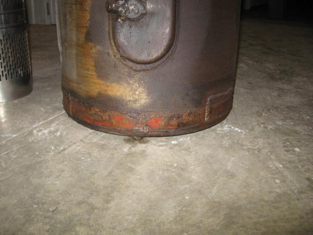

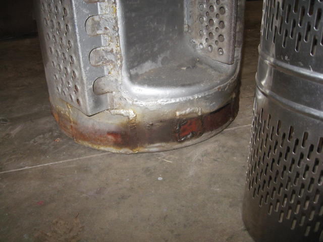

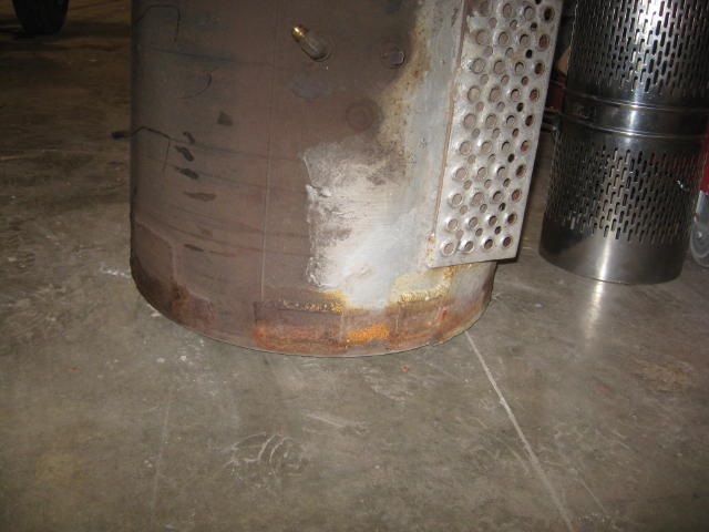

Hi Herb. You mean like someone did seven times to my passenger side fuel tank?? There are also three patches on the large air tank, but I don't have photos of that.
Rob

Yeah, something like that, although it would be better to form a band & do the entire strap area with one piece!

Yes, this was kinda comical when I pulled it from the truck. They are sound welds, but look terrible being so many of them. My son actually bought me a duplicate tank in very near new condition to replace this one, but I've not mounted it yet.
Rob
