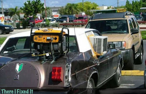

I think Rowdy Rebel may have tried it in the past so check with him to see how it worked out.
I shouldnt reveal this rhasler, but i did remotely consider the generator, window unit deal. When I worked in the coal mines, we actually had one shovel equipped that way,,,Corp. Randy

Dammit boy! i can really feel the love today! LOL! sometimes my wife says she thinks i'd be better off with a hammer and chisel, stone tablet to send messages!..Mark
I think that's Rowdy's car.
I've seen a lot of guys do this with a truck,cut a hole in the back of the bunk,put a window unit in,but NEVER seen anything like this! thats some real "artful" engineering right there!........Mark
Thats right Mark, now some you gurus correct me ifn im offbase here, but isnt there something about a window unit ac that must always be level or the compressor will labor or burn up? I have run lots of different equipment in mines that had roof air, course the compressor was mounted on engine, RVs have roof air, the compressor is mounted inside roof air unit, but I think it has to be level to be efficient. The direction im headed here, LOL, is it seems like I am always bout to slide out the front window or fall through back glass, or standing on my head on excavator, shit, never get to work anywhere flat! One durn way or another, am a gonna have me some cool air in that hot SOB real soon one way or another. Heh,,I even saw an ad online for a box that you fill with ice, (says it takes 20 pounds of ice a day), it has a circulating pump and fan, but good grief it cost over $700.00!!! I get paid to move dirt anyway, not haul ice,,LOL,,,Spec4 Randy

Nope. Don't have a generator OR an AC window unit laying around here at the house. If I gotta spend money, I'm gonna fix it right. I only redneck engineer the stuff I can fix WITHOUT spending money. :thumb:
And I don't have any cars, either. Got 3 pickup trucks (with a 4th on the way), a motorcycle, and the Mack...but no cars. :banana:
For AC, I just roll the windows down. Mother nature does a good enough job conditioning the air for me. B)
