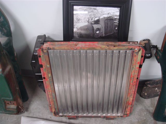

I'm still trying to get the paint removed from my shutters. Been using this spray can of Carbon Off and it has a $13.00 price tag and is primarily used for pots and pans that are used in the kitchens of resturants to get the burned residue off. Believe me when I say it works. But the paint on my shutters are a different matter. I think i've used 5 cans of this stuff and a small portion of paint is still hanging on for dear life. The end results I hope will be to get the shutters to be a natural finish and will spray a coat of clear over the aluminum,unless this clear turns the finish a yellow tint. If anyone has something to say about the possibility of not using a clearcoat please tell me.

if i remember right... i used "dad's" paint stripper. i can go to the barn and look tomorrow to see if thats it. i had 4 coats of paint on my shutter and it worked really well. it didnt take all the paint off the pivot rods on back of shutter but i am going to paint them. i just painted the outside shutter frame today (by chance) and will paint the rods this weekend probably. i took a pic of the new paint i did today but it is still loaded on camera in barn.
paint stripper easily cleaned up the aluminum but it didnt clean up the weatherstrip on back of the shutters that closes them off when they shut. does your cleaner by chance work on the rubber weatherstrip? i figure i may have to paint the rubber strips if nothing else can be found as the old paint on them is quite stubborn.
Don't hit the rubber with methylene chloride which is the main ingredient of commercial paint strippers. It will soften and destroy the rubber. Use something like 3M safe strip or one of the citrus based paint strippers which is much easier on the rubber. It doesn't work near as fast.

AJ,
I'm trying to keep any chemical off the rubber shutter weatherstriping. Thus far i've done well. And yes I had about 4 layers of paint on mine also. The product i'm using (CARBON OFF) don't know if it is safe on the rubber but have used chemical strippers on cars before but had all chrome and other parts covered and was careful then. When I saw your shutters they look just like the stage mine are in. In fact they look identical as mine are.
Rob,
I'll look but very sure this is not a chemical strip by my favorite company as 3M. 99.9999% sure.......not ready to buy large quantities of stripper yet. This stuff is bad but it has taken many cans to strip this paint off shutters. My finger nail has been used on stubborn places that has not been coming off. I just don't like the results from using a scrapper. Scars them too badly. I have been using scotch brite on the aluminum.
