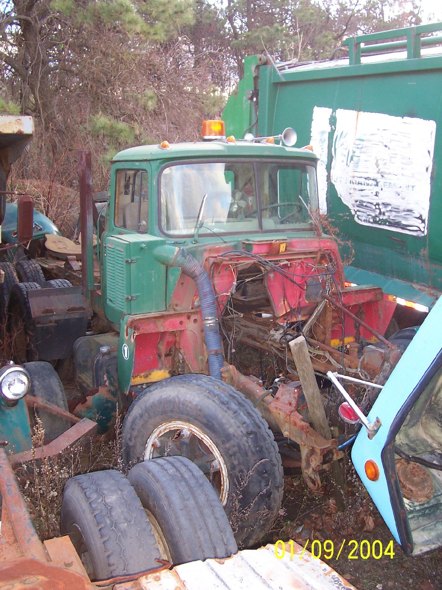

  16. Hows this for a New York flame wrench (AKA engine removal) hack job? The cab and nose were mint. Notice the firewall cut out in order to remover the tranny? Gotta love cheap labor

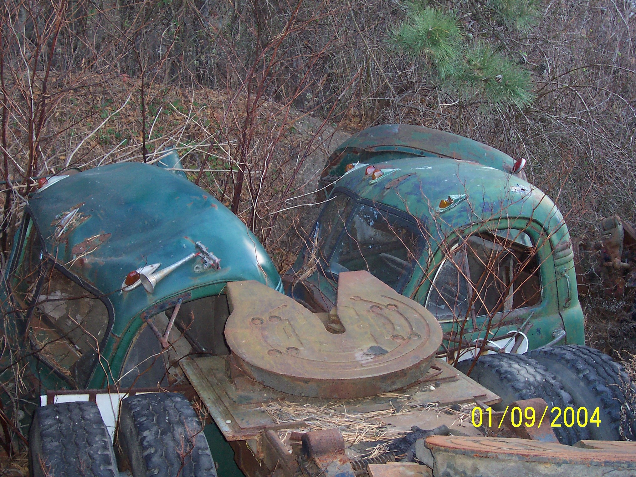

  17. 78 steel nose RD for sale, parts or whole. 58 rears / 20 front
