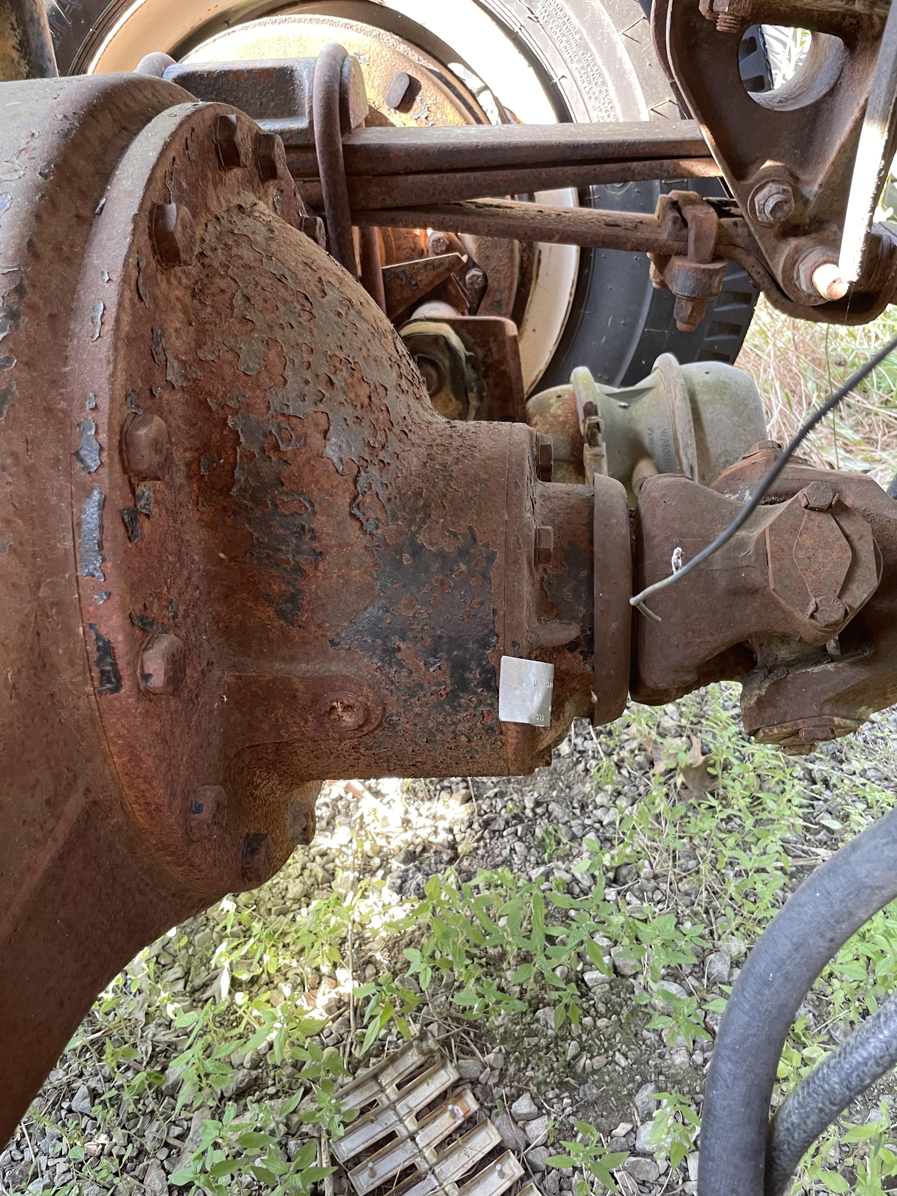

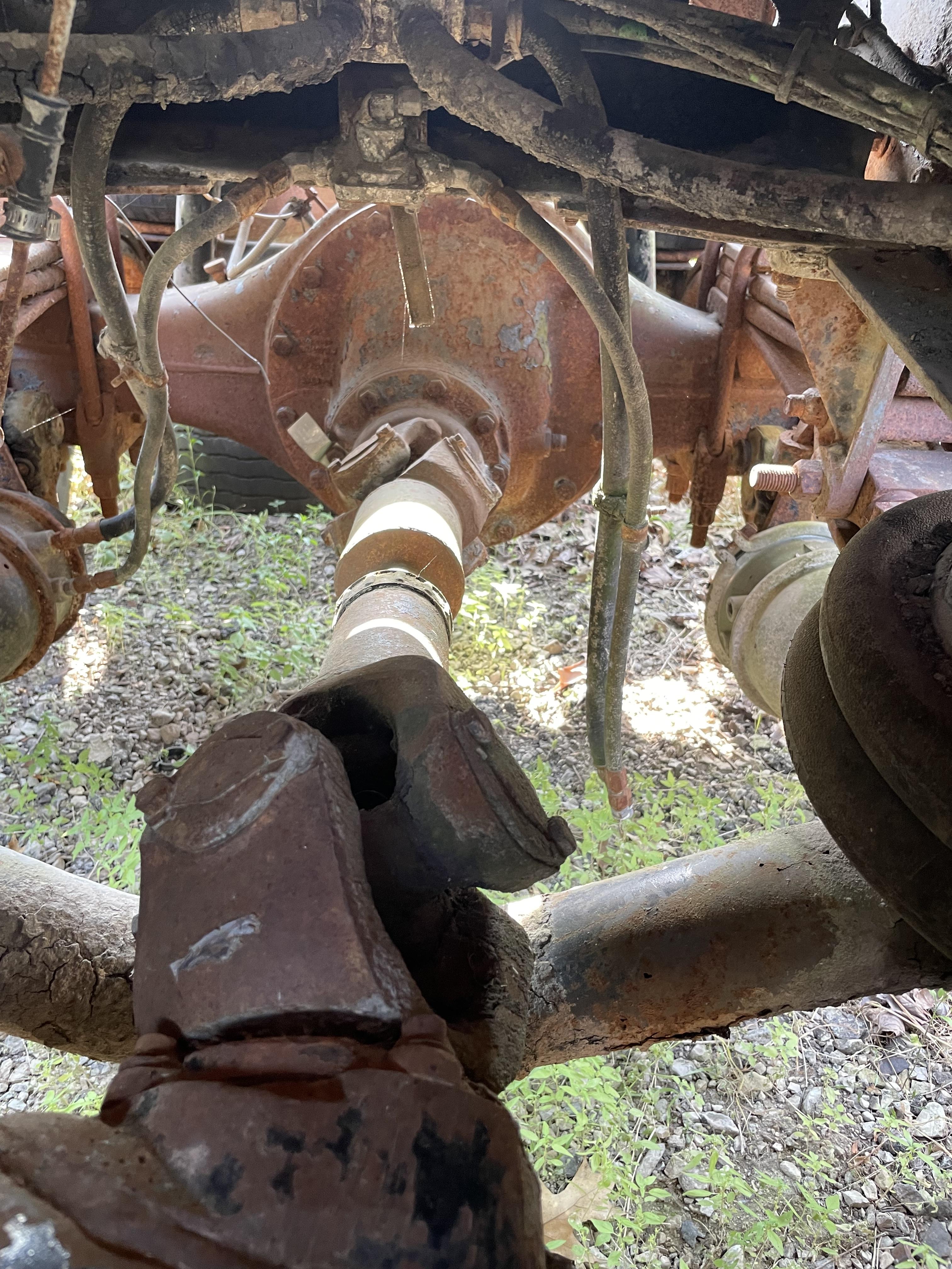

I would change all the rubber items for sure, they only last so long. Brakes and shocks as well. Is this a SQ100? My drive line angles would work because I’m going to install it closer to the rear of the truck for more wheel base. My truck doesn’t have front brakes so I’m going to have to add those too.

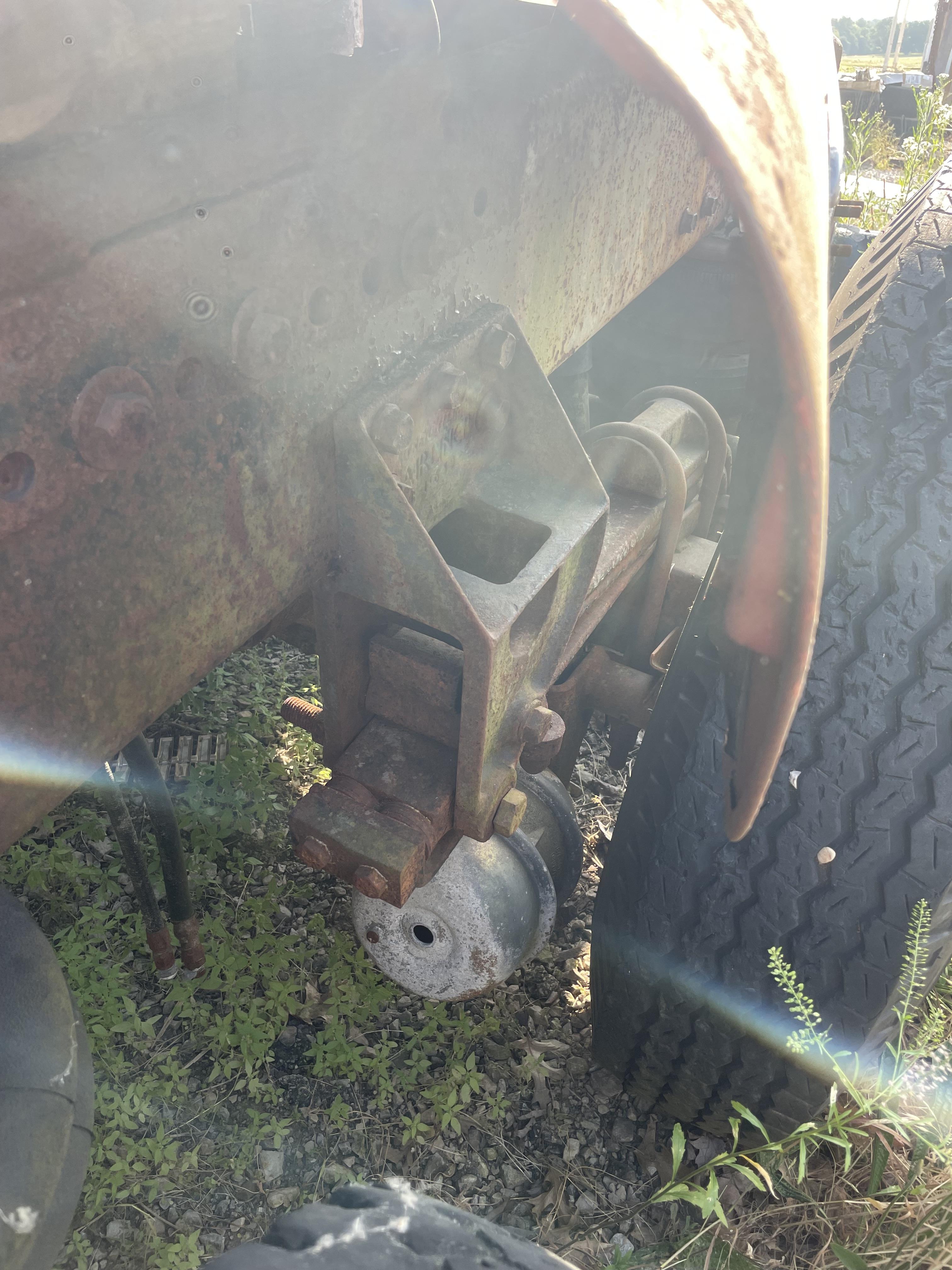

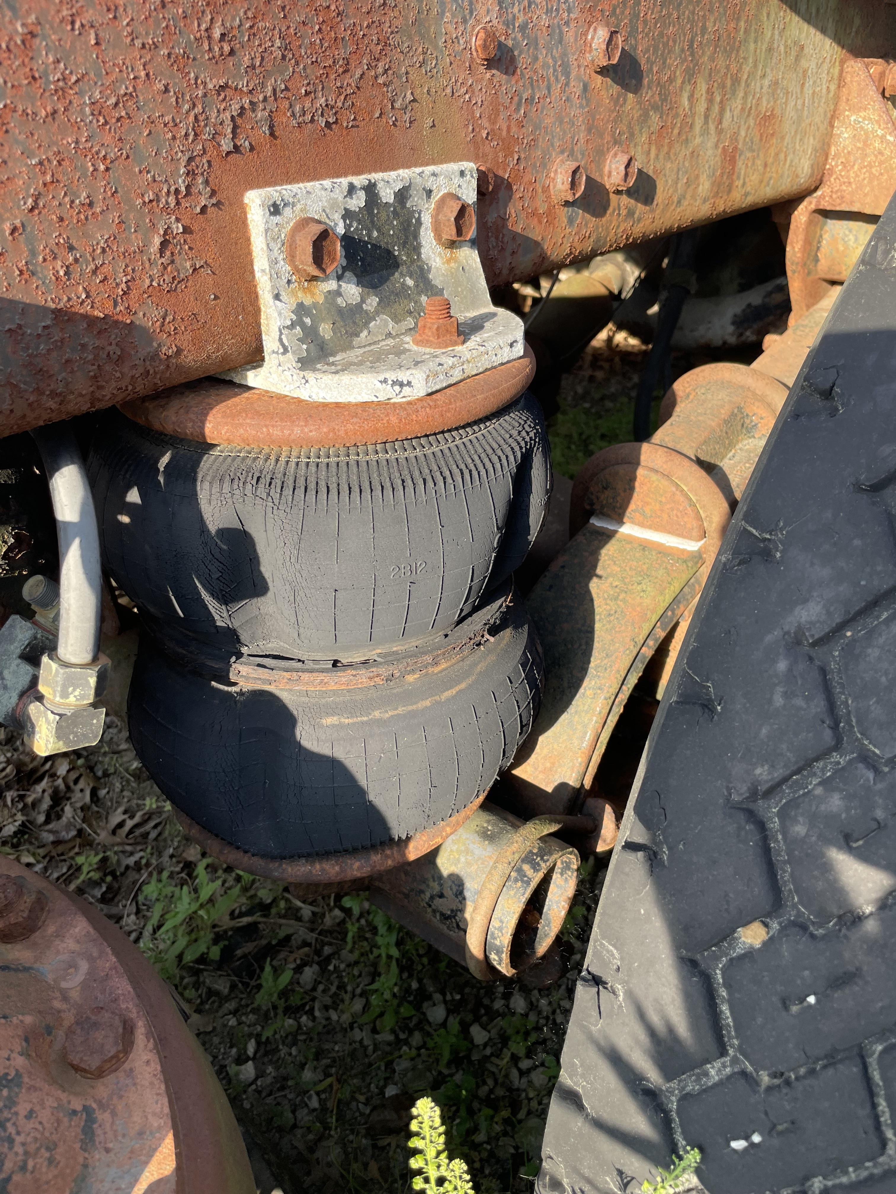

Went out a got some pictures of the axle I want to use. I think it’s a sq100 axle. I think the rear unit will work well, it even has the same series driveline as the b model. I think I can use 1/4 inch fish plate on the sides of the frame to take up the difference on the frame width. The airliner suspension on the tandem is in theory two independent units working in parallel. Here are some pictures…
I agree on the gearing, don’t see much over 40,000 lb GCVW with truck, trailer and a few farm tractors so a 6 wheel truck would do the job just fine. I’m going to get a picture of the axle tonight to get a ID on the unit. I just want to use the rear axle of the tandem set.I would love to get a inter axle locker for it though.
Hi, I have been wanting to add air ride to my b61 for a number of years now. I have an Air Liner air ride with some mysterious rear axles in it. My tractor has tandem rears with Mack 5:13 gears and the mystery axle is a 3:73. The 237 would do fine ratio wise but I was wondering can you use the rear axle of the tandem and make a single drive instead of a tandem? If I was to get pictures could anyone identify it? thanks Fred

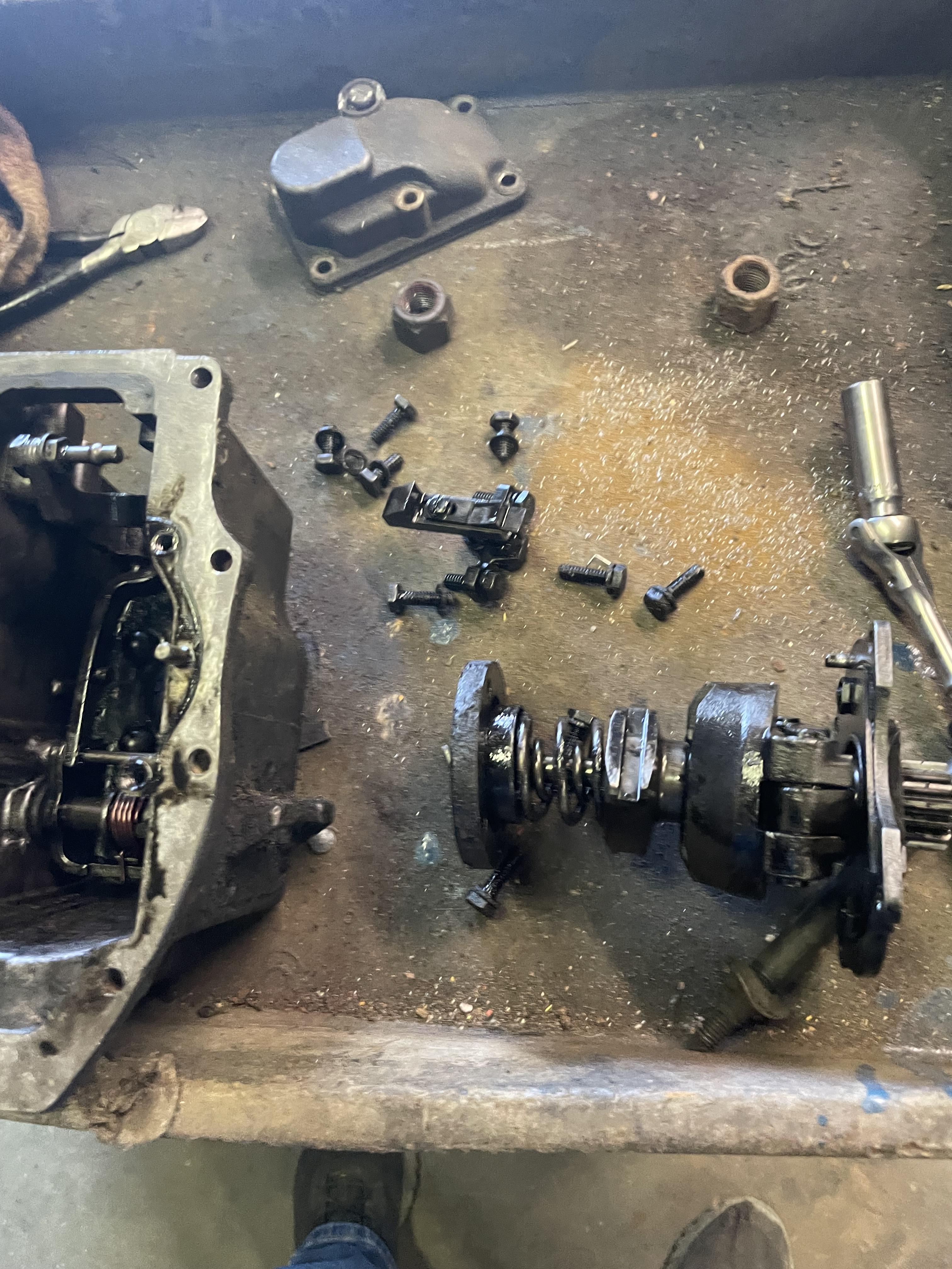

Well I removed the governor and found the culprit! The internal shaft on the throttle was worn just enough to slop around. I made a video on YouTube to describe what was wrong and what I done to fix it if you want to see. thanks for all your help. -
237 bucking/ very sensitive throttle
b61fred replied to b61fred's topic in Antique and Classic Mack Trucks General Discussion
Update.. I loaded up the family yesterday and made the trek to Delphi, IN to get a parts injection pump from Ron Bogan. I got home late and I was able to get the governor removed and disassembled. Today’s job is to see about getting the one off of the B61 and look for a smoking gun inside of there. Wish me luck! -

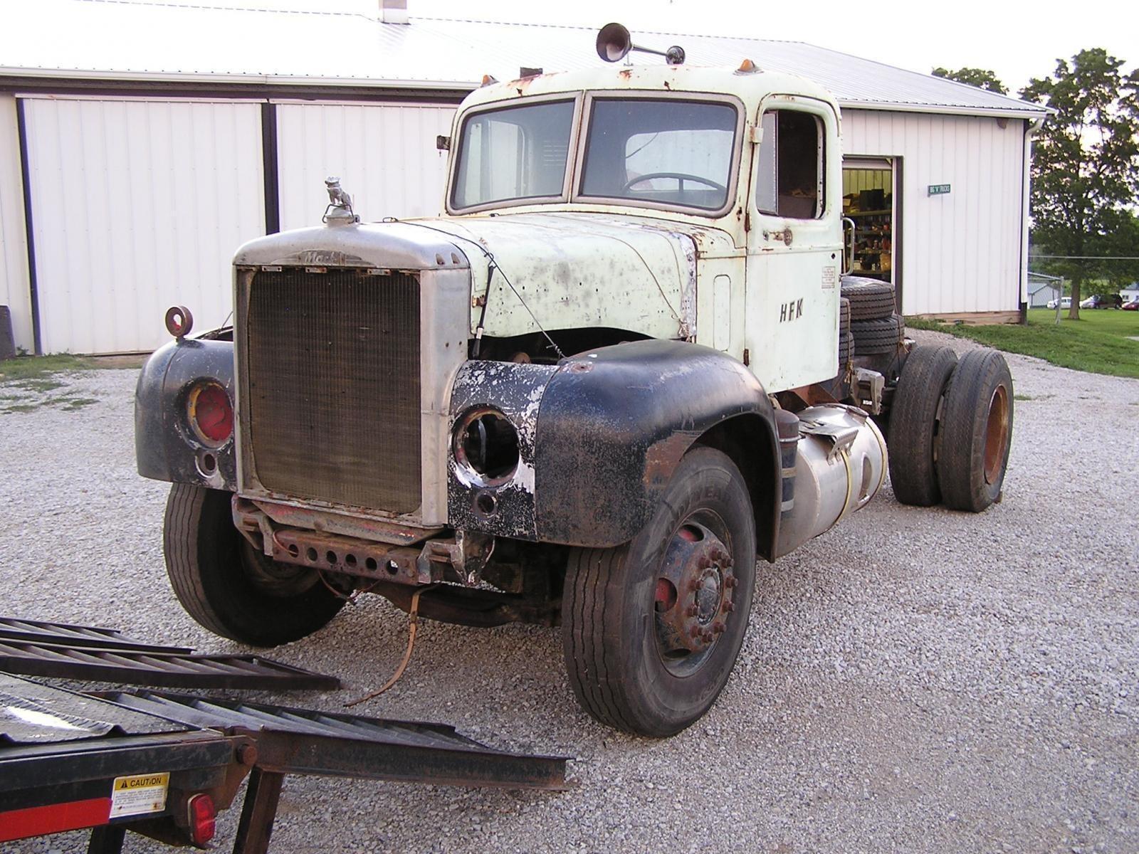

Matt, I would say that superb organization and cleanliness of your work space has a lot to do with the efficiency of the work performed. Everything has a place and everything in its place! Add in a mentor that is highly qualified and BAM a winning combination. The old 220 will be rattling the neighbors window panes in short order. I haven't been on here for a while and just been binge reading your b73 restoration. I have to say its one of the best sagas on the net. As I was reading about putting in the rebuilt engine I was thinking to myself that as meticulous as you appear, he will have it out and go through it for some reason. I didn't think it would be as quickly and as catastrophically as reality would have it though. If anything else it makes me want to get the B733 of mine out of moth balls and start working it over. Morgan (b61 Fred) p.s. Here is a photo of my project........ -
