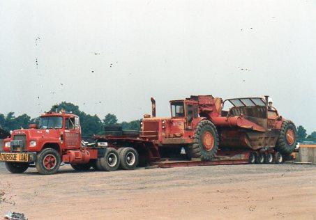

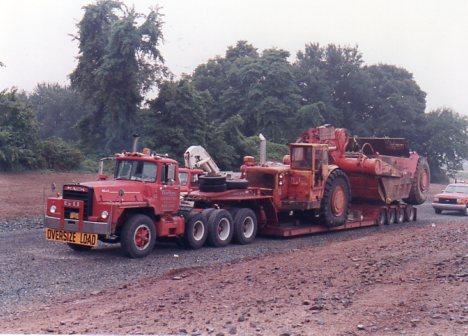

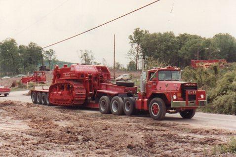

  16. I live about 10 minutes from shop.The Ford is also red.When we were in the excavation business everything we owned was painted red.The spec are 169"WB,ENDT676-300 285hp,TRXL107-low hold 5 speed,12000 front,38000 rears,Price when we brought 20 was $44,904.00 in 1979
  17. Vinnie,if I use it as a daily driver it may get up to 100,000 say in maybe 5 years.

  21. The Mack V8 ran away one morning and by the time we got it shut down the damage was done.We did it in house.That truck was preety beat when we got rid of it.I can only think what it's like now.I would have taken the old B87 to drive over that truck any day,when you took out the B87 you knew you would be coming back under your own power.
  22. When ever we would get hung up on a hump on the road with that truck within 2 weeks the front rear would blow out.The other problem we had with it was with a heavy load on the lowboy and you went to take off the frame would flex bad enough that the fan would hit the should.My dad had wanted to order a truck that he would spec out but the wait time was to long so Trenton Mack found this truck that was ordered by a fellow in North Jersey to be used as a triaxle dump.It only had 58 rears and my dad wanted 65's,but Mack said they would hold up and they back it up so everytime they blew Mack replaced them.
