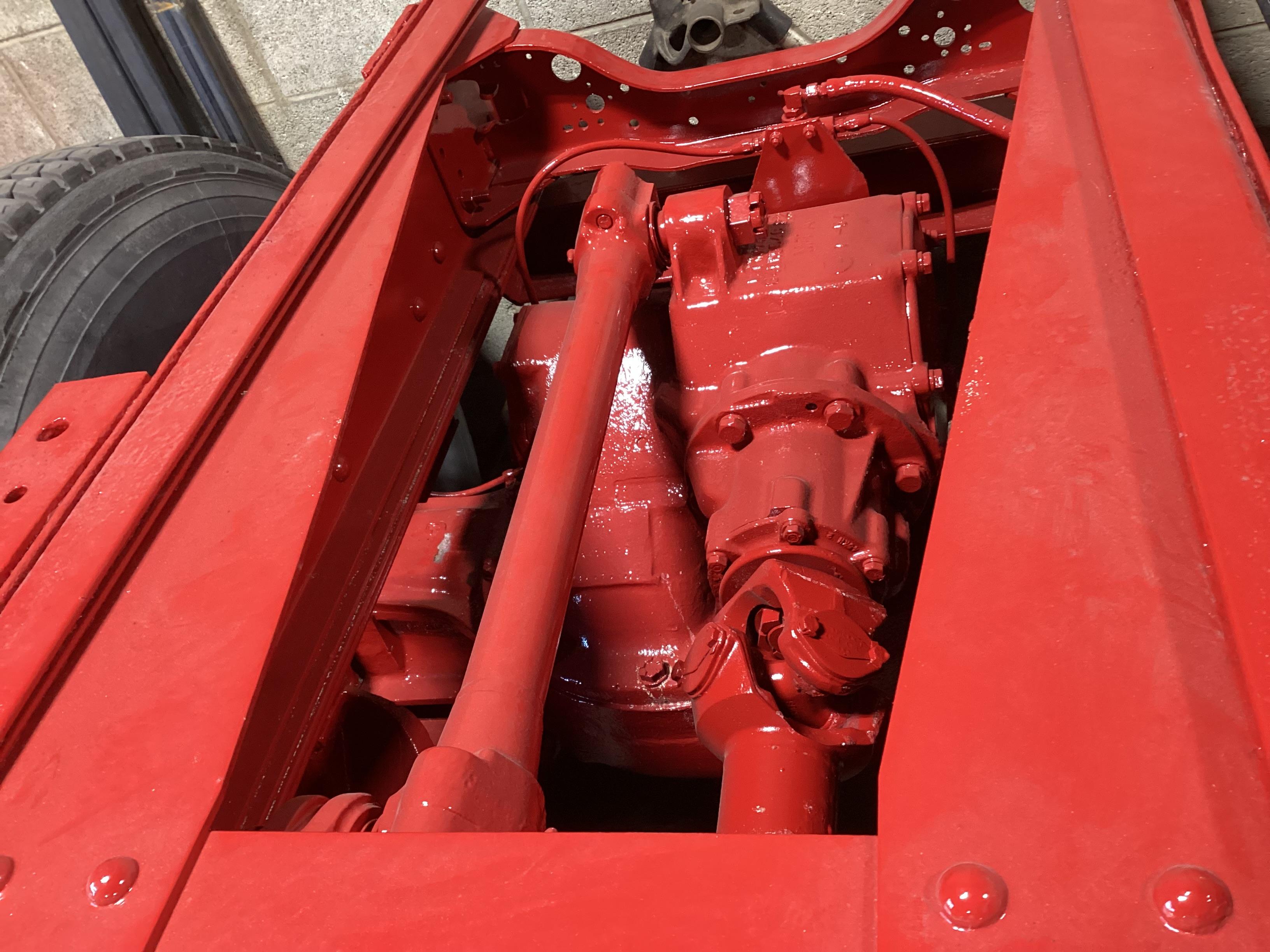

  11. I have had my B87 tractor painted.The frame I had a local tow company do it an they did a great job,but I had sandblast it first.Then the cab and fenders and so worth I had Mickey Delia from Frenchtown NJ do that and again fabulous job.I had sandblasted the cab my self.All in I’m going to say without including my time I have $25,000 in it.Hersome pictures of it.
