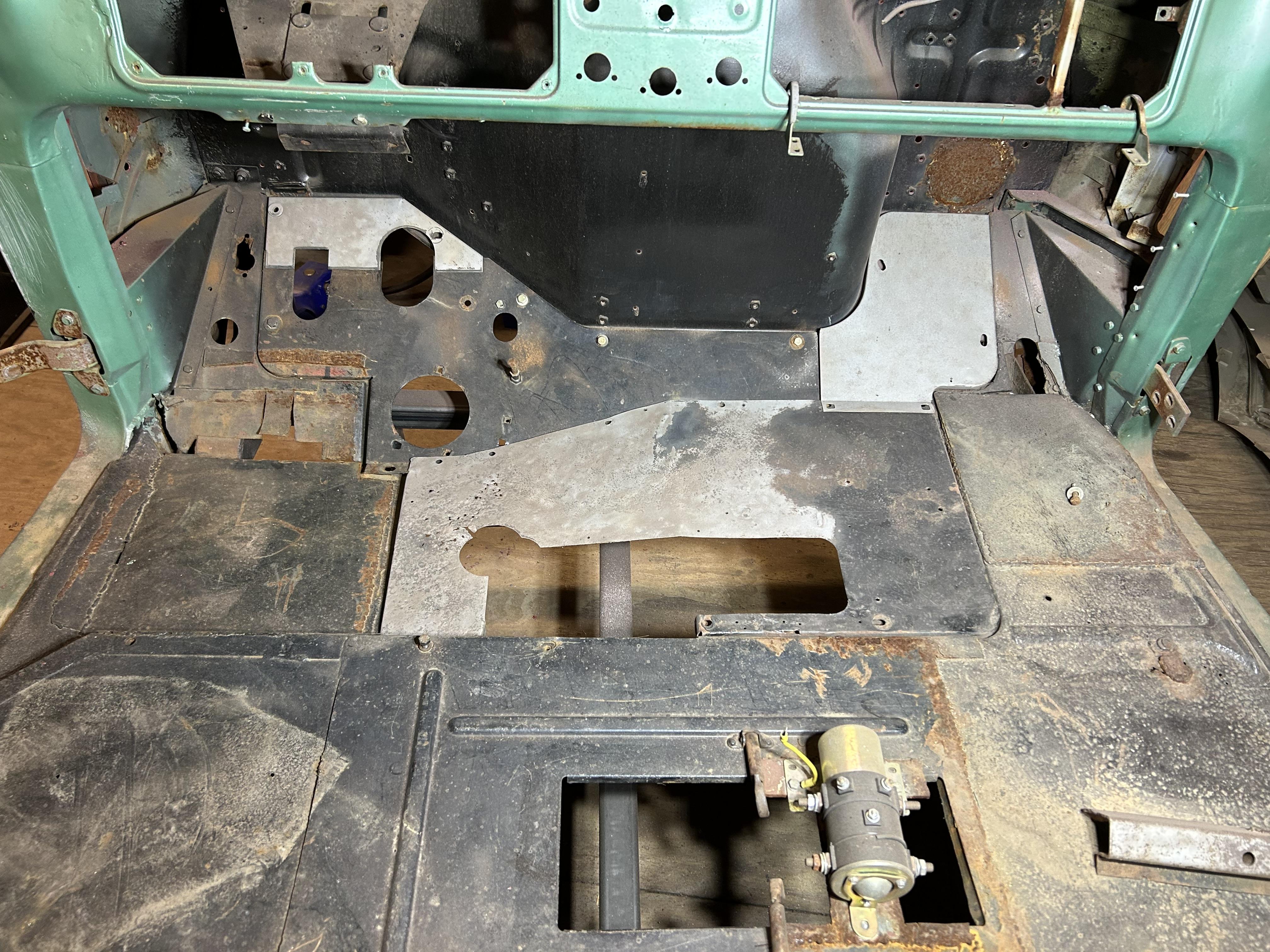

  1. Looking at pic 1,the 3 circuit breakers on the right are dead all the time even know the heater does work.There’s no hot next 7 breakers are always hot key on or off.What is making them hot them hot is the third wire to the left,disconnect this wire and they go dead.I thought the power goes from batteries to starter,then key switch.The only thing that should be hot all the time is the breaker for the flashers and maybe the cable dome light. Picture 2 of the alternator you can see the 2 wires coming off the alternator are both ground wires,I’m thinking the little black plug you see should be the hot wire leading back to the batteries.

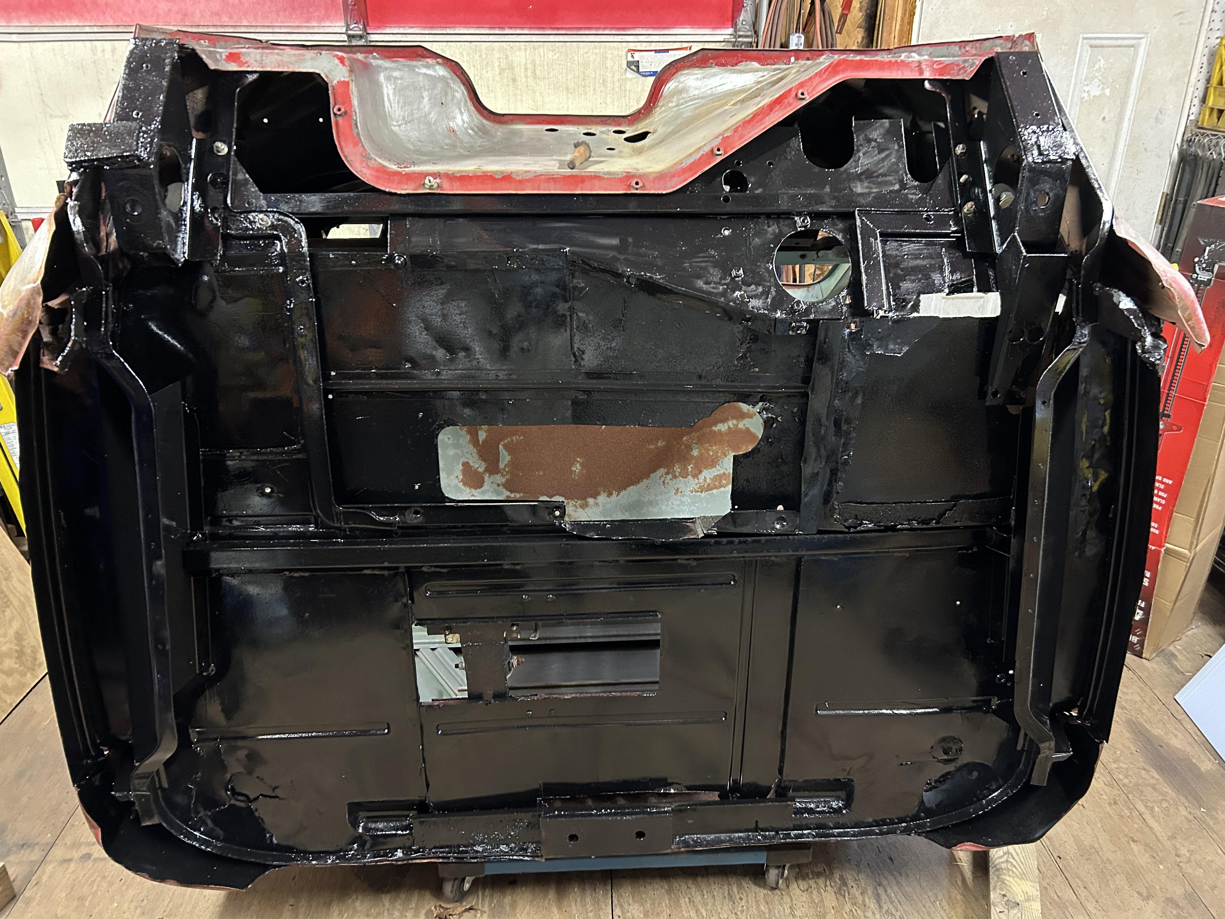

  7. It been awhile since I’ve posted about any progress I have made on the truck.I have all the tires mounted and on the truck.I went with gray wheels,they really break up all the red.Am sandblasting the fuel tanks and front bumper then I will mount them.Just waiting for the body guy to call so I can get the cab and fenders,hood to him.Will get some pictures of the wheels tomorrow and post them.

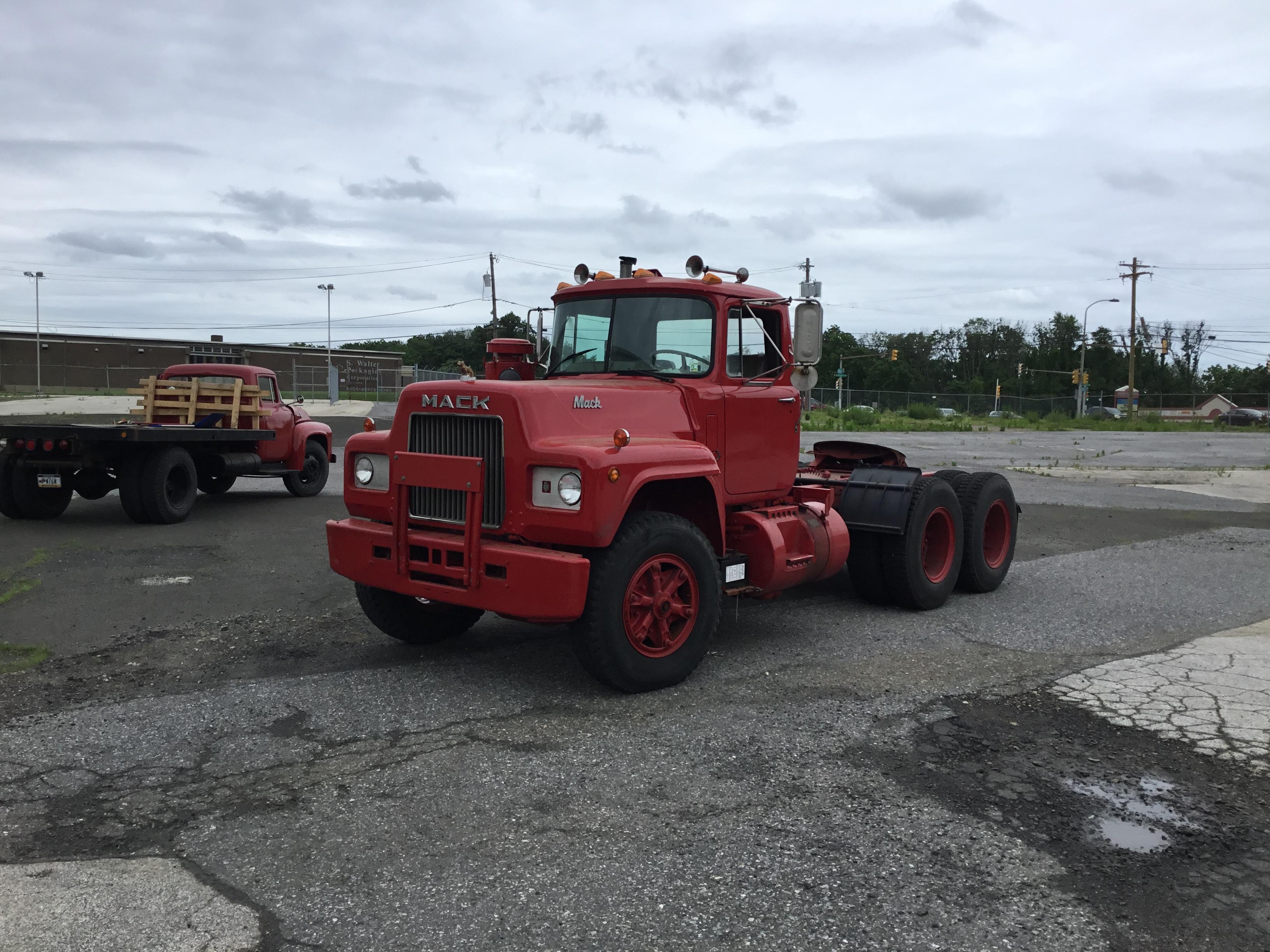

  10. Looks great hope mine turns out that good.
