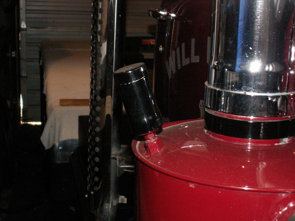

You don't need no stinking block heater if you have one of these and a box of capsules! The manual says nothing about holding the foot feed all the way down - It says: "Depress accelerator half-way." -
