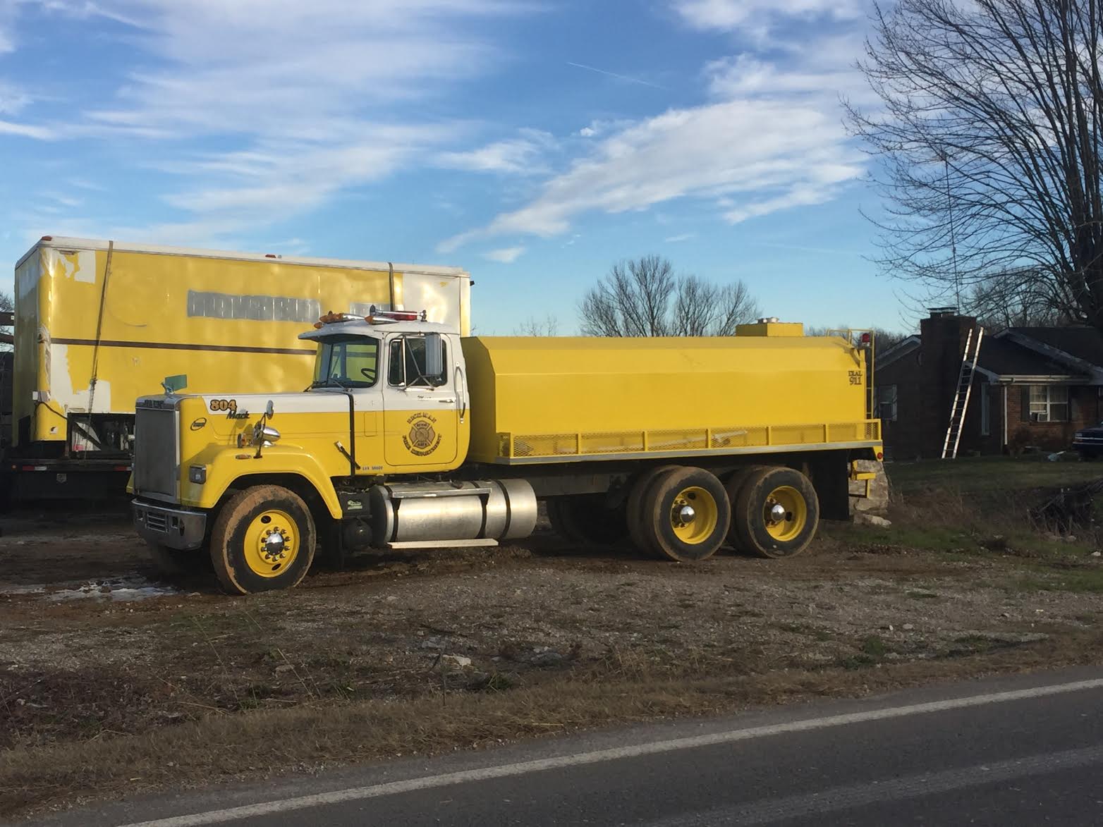

This was parked on the side of the road in North Central Tennessee. On Celina Highway (52) between Celina and Livingston.

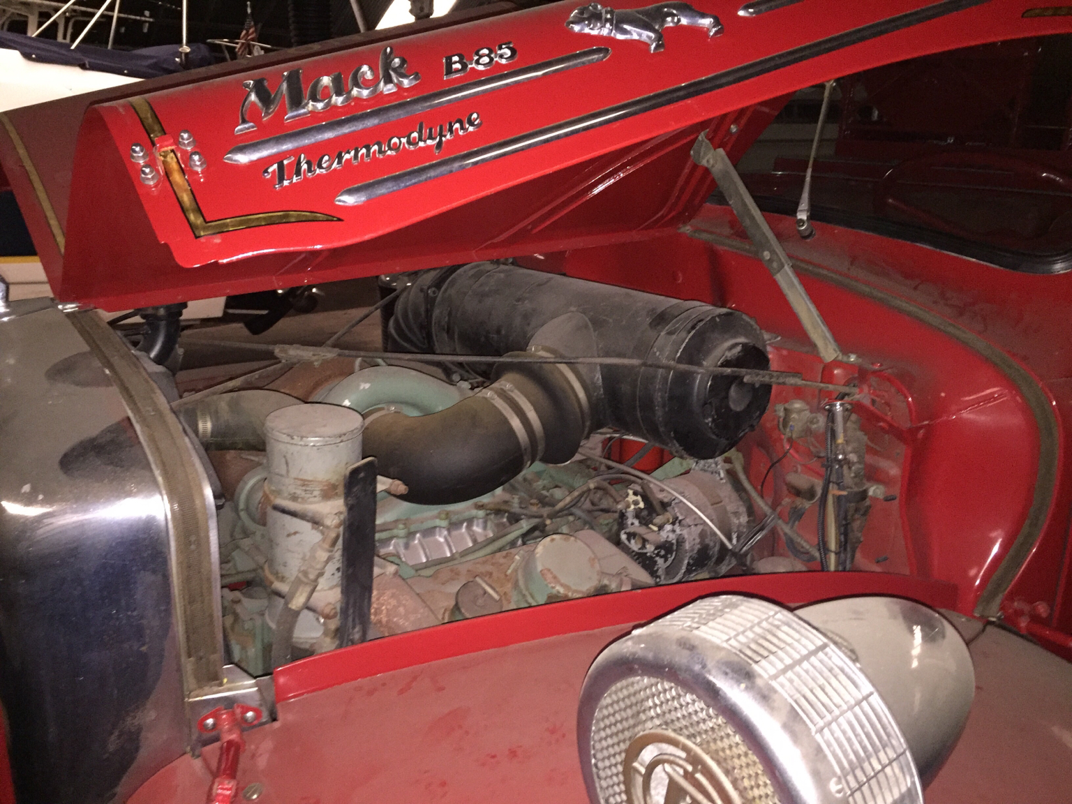

My friend I appreciate your help. I'm pretty sharp at working on a SBC in a Suburban or 3/4 pickup or the flat six in a Porsche race car but I'm not a diesel mechanic. This being said I'm sure I can figure out what to look for with a little guidance. For sure don't want to call the local Detroit diesel joint. Can you work me through what and where to look. This is the secondary fuel filter. Pic further back in this thread. Mounted on fire wall. Screw on filter. Using Baldwin filters. Sent from my iPhone using Tapatalk
So when I removed the old fuel filter you could see that The O-ring had been blown out of its groove and that is how it failed. Got a new filter lubed up the O-ring filled it with diesel installed it Truck fired up right away but as soon as I throttle it up it blows the O-ring out through the side of the filter and the filter housing resulting in the same pissing of diesel fuel problem I started with last weekend. Took the fuel filter off re-seated the ring reinstalled it and it happened again. Thoughts? Have to believe it's an excess fuel pressure issue. Is there a return line that could be clogged. Truck idles and accelerates perfectly so the motor is getting the right amount of fuel. Sent from my iPhone using Tapatalk

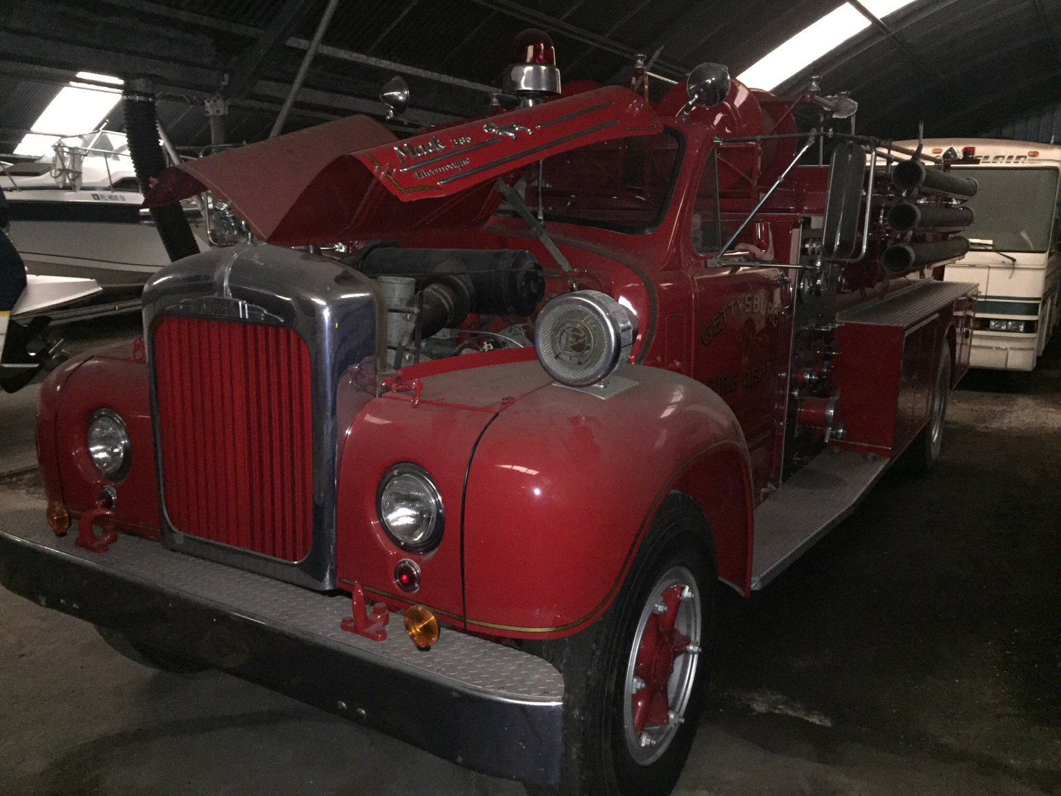

So we got the general Ike fired up today with absolutely no issues whatsoever until I pulled out onto the road. Started smelling diesel fuel pulled over and found that what appears to be the fuel filter attached to the firewall just behind the turbo charger on the 6V 53, was Leaking excessive amounts of fuel from where the filter meets the filter housing. I'm assuming that this is because the gasket is shot from sitting. Is this a simple unscrew the old filter and put a new filter on? Will the system lose prime when I go to do this? I assume that I should fill the new fuel filter with diesel fuel prior to installing Sent from my iPhone using Tapatalk

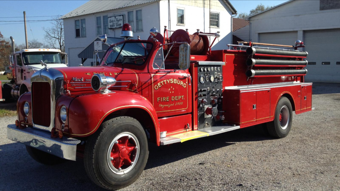

The L was sold to Gere Lady and was lost in a fire when his barn burned. It was at GFD the entire time I was there in service as E1-4 but it never saw fire while I was there from '96-'00. It was a 1947 I believe. Ran its last job pumping a fire at Sentz cleaners right off the Square in Gettysburg in the mid '90's. The CF was the old Engine Zero from Yardley. It became E1-3. I caught a ton of fire on that rig. It was acquired to act as a stand in for E1-2 (1977 Seagrave) when it was refurbished and had a Pierce body mounted. They decided to keep it when E1-2 came back and it was slimed. Gere Lady coincidentally owns E1-2 now as well. And while we are at it he owns the old hose wagon, Wagon 1. Or at least he did when I did my Pre delivery inspection of the General in 2011. Last I knew, the CF, E1-3, was at the Harrisburg Area Community College fire school. Sent from my iPhone using Tapatalk -

First video above was when Jere Lady picked it up from GFD's storage shed behind the station. Second video is from the county convention but the rig isn't 100% complete as the hose reels aren't installed. It would be almost two more years before the rig was finished and he shipped it to me in Florida. Sent from my iPhone using Tapatalk -

So the General Ike has been sitting for some time. Probably about two years. The batteries are shot and have resisted my attempts to rehabilitate them. I was going to put fresh batteries in on Saturday and then go blow the carbon out in prep for my middle son's 5th birthday a week from Sunday. Last time it sat this long I didn't have any problems.... But I'm looking to you guys to see if you'd do anything other than check the oil and go. Its got a 6v53T in it. I'm assuming if its wet underneath that I'm good to go.
