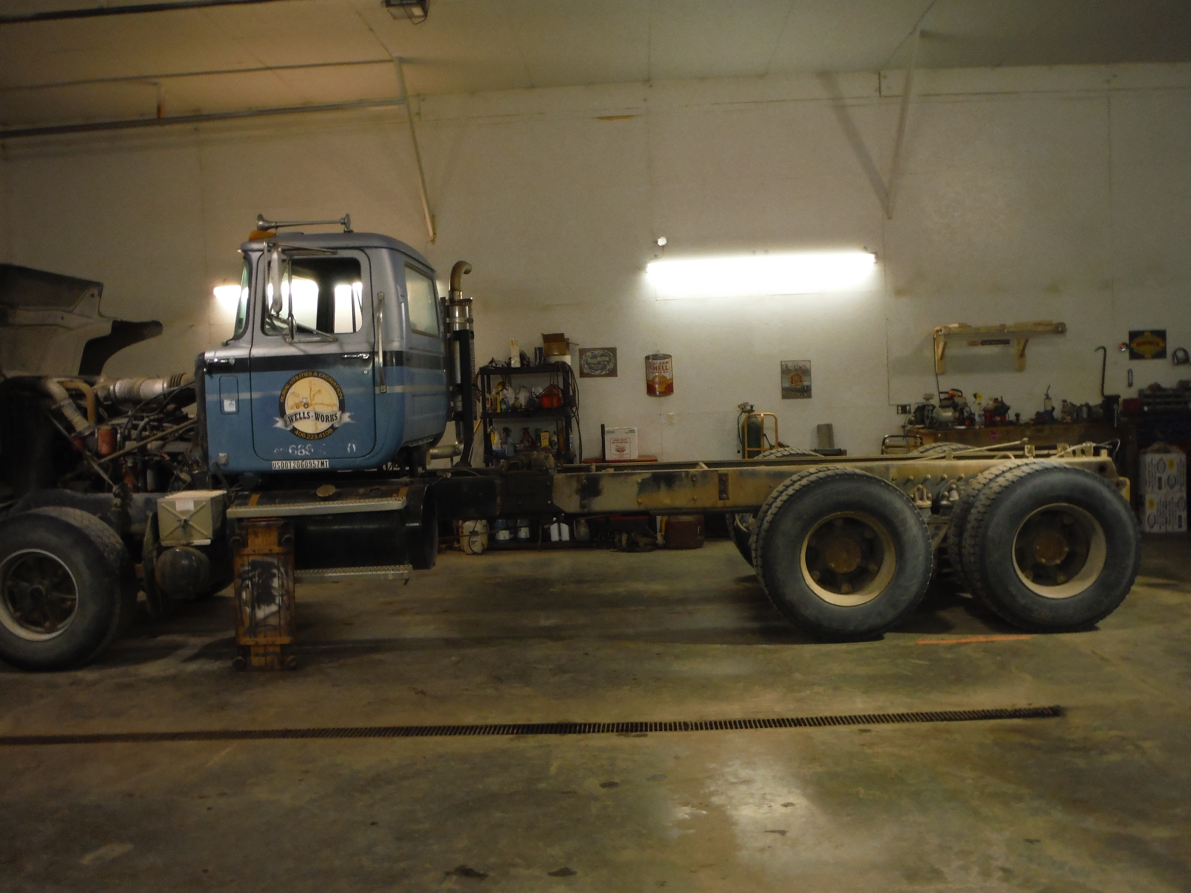

  1. Frame on this truck is like new, been drilling for my new rear susp. and tag axle last couple days, and no rust between rails makes it nice! Took out the old Hend. rubber block and installing the better riding up dated rubber block.
  2. They loaded backwards, but you can figure out what I started with and where we are now. Stripped the cab of all interior and glass, adding dynamat inside and getting paint under all those rubber gaskets around the glass. Stripped down to frame, welded susp. bolt holes shut,sanded ,primed with epoxy and painted gloss black.
  3. Some pics of my progress so far. Rebuilding a '87 RW713 into a RW753. This truck left PA in '88 and spent the last 29 years in Montana. What a difference it made in this trucks life ! Almost new in alot of ways.
