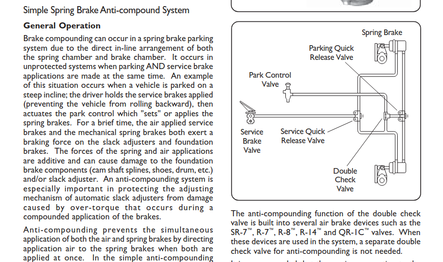

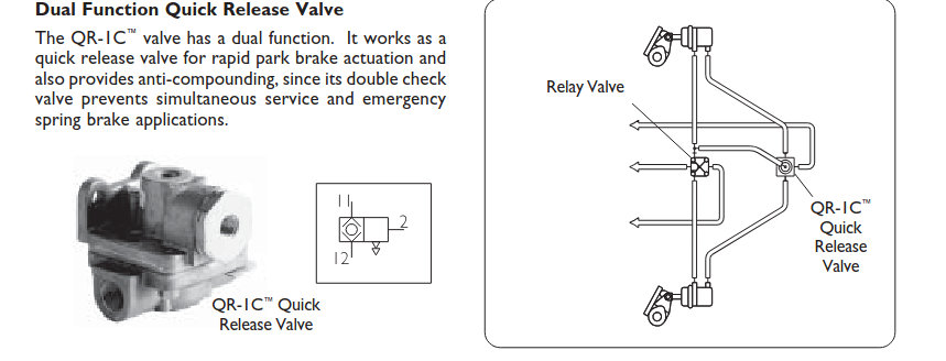

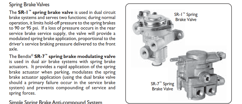

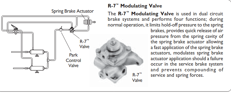

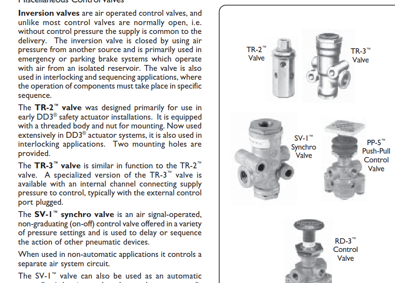

Ok that make sense. If the main air is lost, the spring brakes will apply regardless of what position the control is in.
Bendix pressure regulating valves Here is what I think you have. No pressure regulation, just adjustable hold off until the pressure is reached.
It looks like a pressure protection valve. It will hold off pressure until its setting is reached, then pass system pressure after that. In N-A they are used for air ride and such so a loss in the suspension will not drain the brake tanks below the setting of the valve. Yes, they are known to plug and stick. I have had several and sometimes if a truck or trailer sits for a long time they stick. Good find. Not knowing your system, I wonder if it has a separate tank for parking release and stuff like air ride? The weird thing would be that a loss of pressure in the main (before the valve) would still keep the spring brakes off as the tank after the valve would be isolated.
