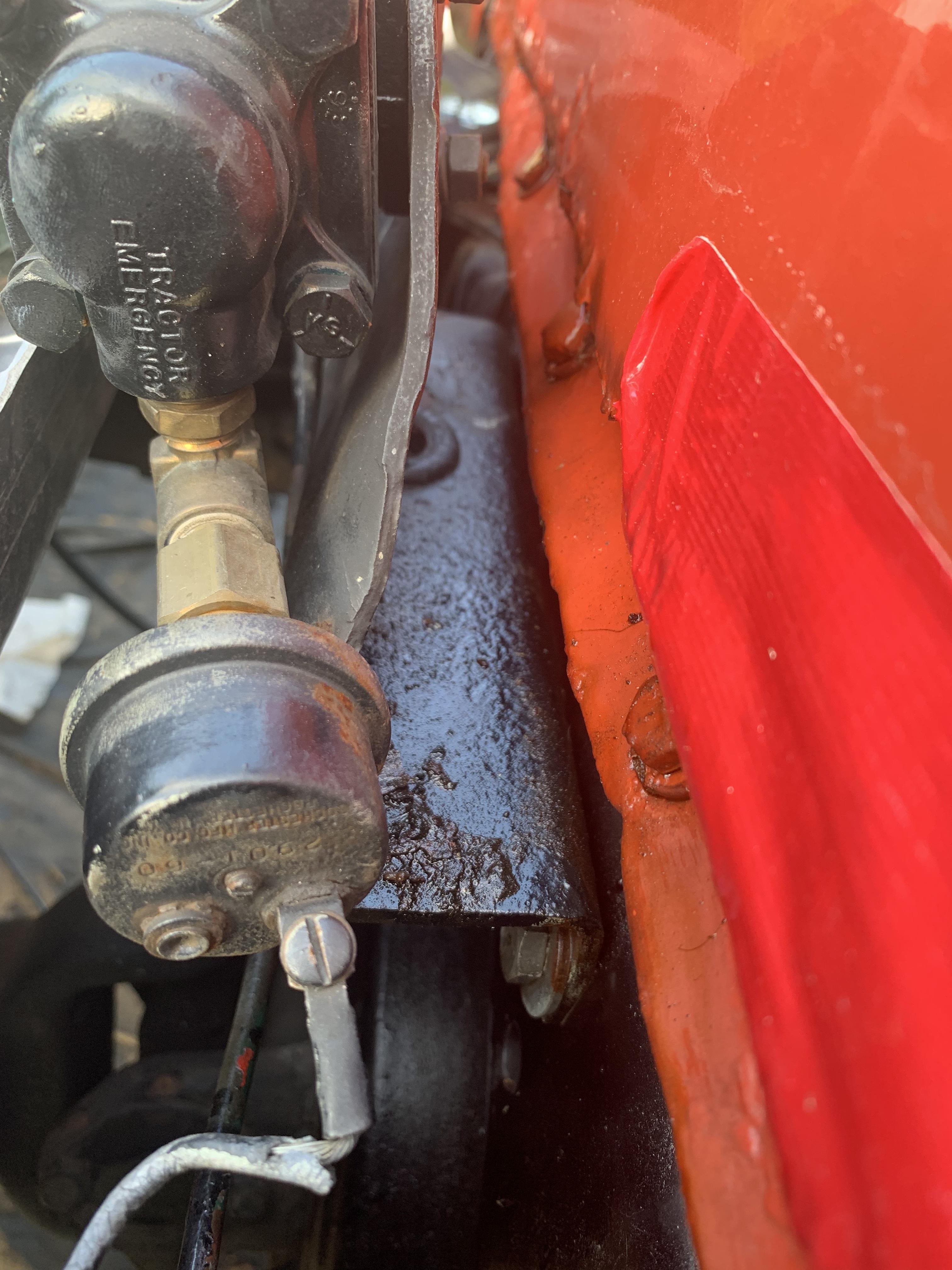

  17. Yes,finally have brake lights.After new wiring,still no joy.Located,the original switch atop the double check valve,opened it and cleaned the contacts,brake lights are back in business.Thanks to all responders.

  19. I finally found the original switch,under the cab,inside the frame rail on top of a double check valve,according to a B schematic.I hope it`s just the wiring that`s bad because it looks like it would have to be replaced w/ the same model.It doesn`t thread into the check valve,it`s attached by 2 screws.Maybe it can be fixed,if an exact replacement isn`t available.Where would I find the trolley valve? Thanks everyone for responding,I obviously have a lot to learn.
  20. With the tractor protection in Normal position,the brake lights are always on as long as there`s air built up,w/no brake pedal being used.There`s air pressure always present in either trailer air line fitting when the TP switch is in the NORMAL position,with no brake pedal involved.
  21. Not fixed after all.With the tractor Protection switched to Emergency,there`s no air pressure to either trailer fitting.TP switched to normal,brake lights come on w/air brake switch in either trailer line when air pressure builds in the tank.Does this indicate a bad brake valve under the pedal?
