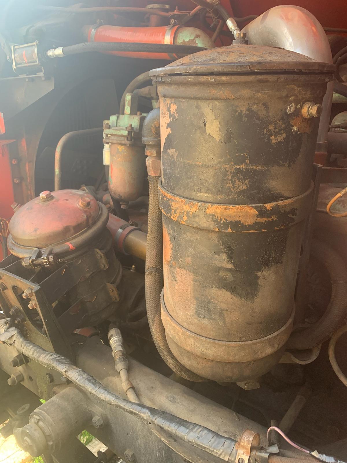

  3. Can an oil line to the filter ever need to be primed? The filter is a Luberfiner 272-c.It has inlet and outlet check valves.I had the canister out,hoses disconnected for a couple of months,so when I installed it and filled it with oil,the check valves would have been closed,and any air in the hoses would be there when I started the engine.This is a second filter,it appears it`s job is to filter oil going to the turbo.

  5. No pressure after a minute and 20 secs.So I`ve run the engine for a total of 2 1/2 minutes with no oil to the turbo.
  6. Oil spurted out of the big filter when I opened the vent and cranked the starter,but no oil going to the turbo feed line,and therefore none to the gauge.If anyone in northwest NJ is interested in a pretty nice single axle B61,I`m ready to move on.
  7. I changed filter cartridges and oil lines on the two canister filters on my ENDT 673 engine.I filled both filters with oil.That was six weeks ago.Finally started it,and after 30 seconds of idling,zero oil pressure,according to the gauge.I would always get 60 psi showing within 5 sec.The dash gauge appears to be fed from a line going to the turbo.Is there a way to positively check that I have or don`t have pressure in the engine? Thanks.
