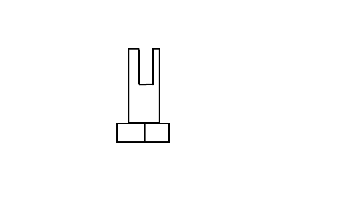

  2. I used 2 or 3 9/16" bolts and cut the threaded portion of the bolt in the center. Then I would use an 1/2" extension and slide bolt into the inspection cover then onto the clutch brake. I would use my impact gun to spin off the clutch brake. No torch or air hammer. Usually 2 bolts would do the trick.
