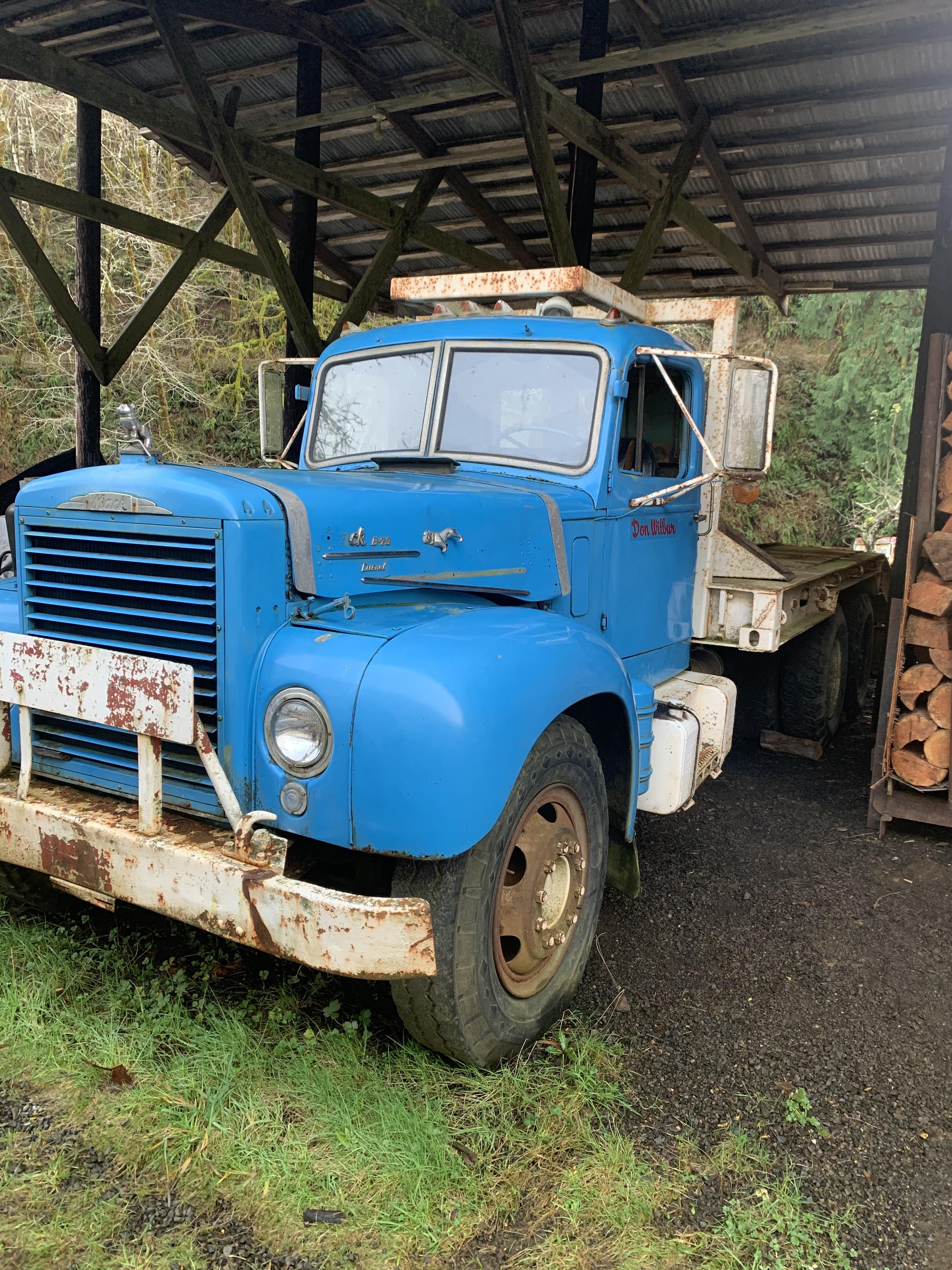

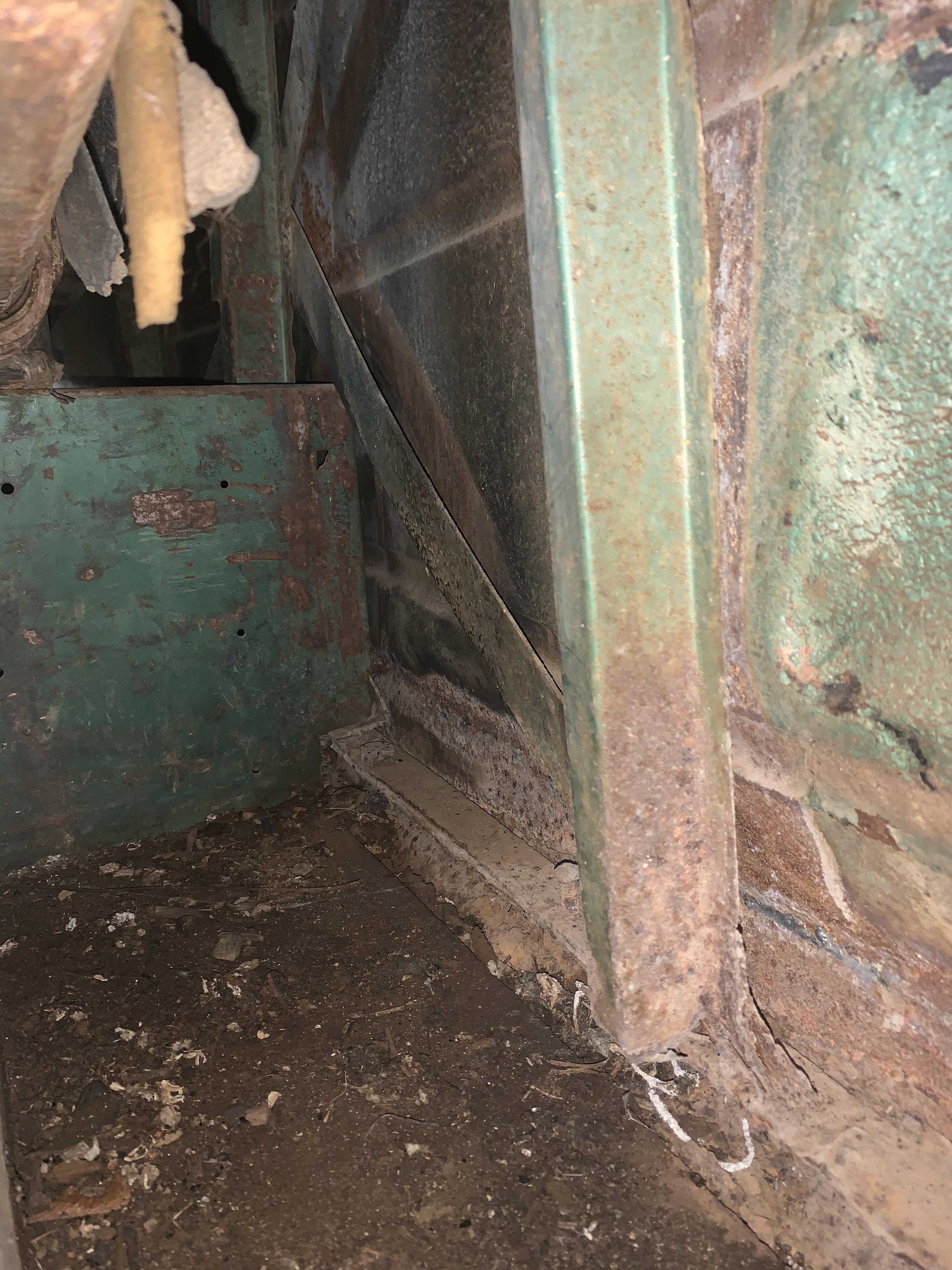

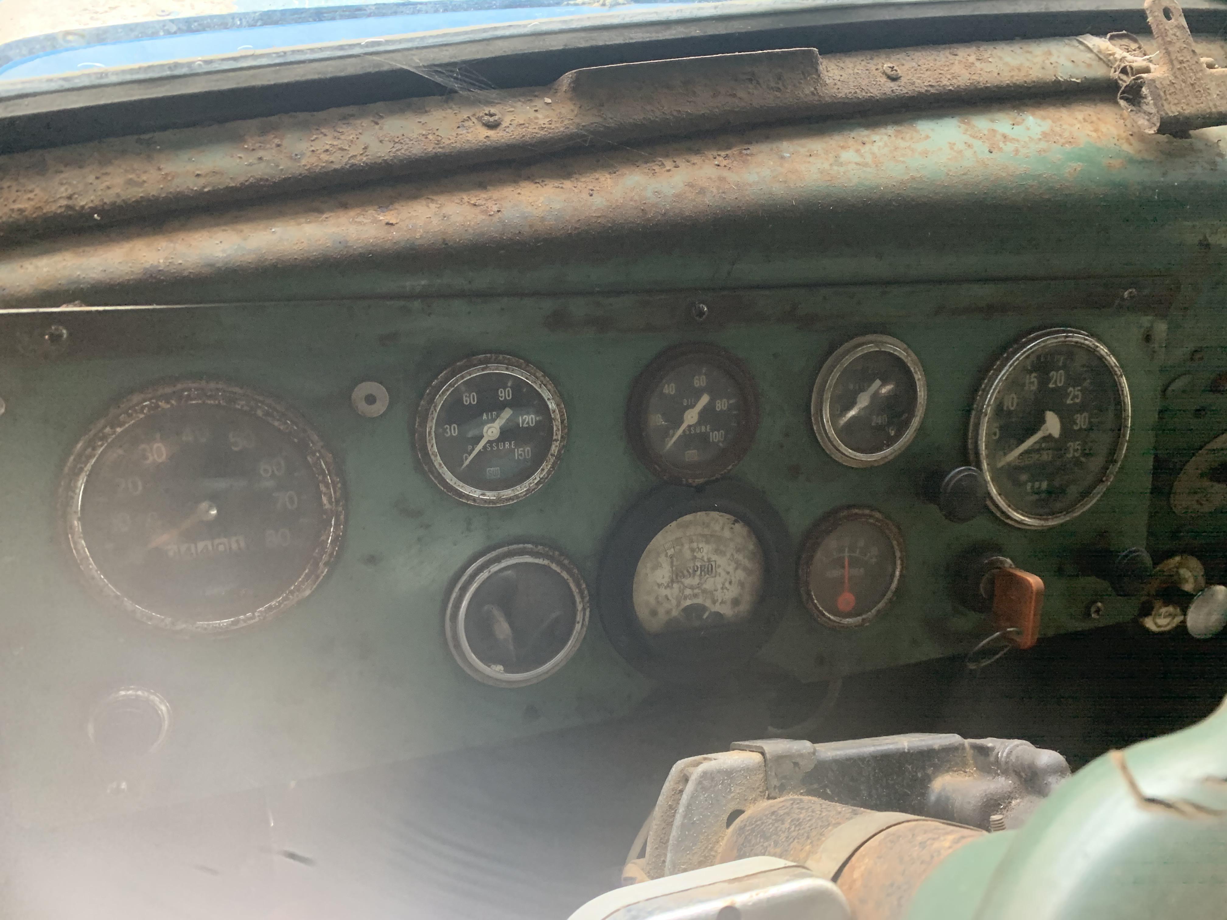

    1962 B-51

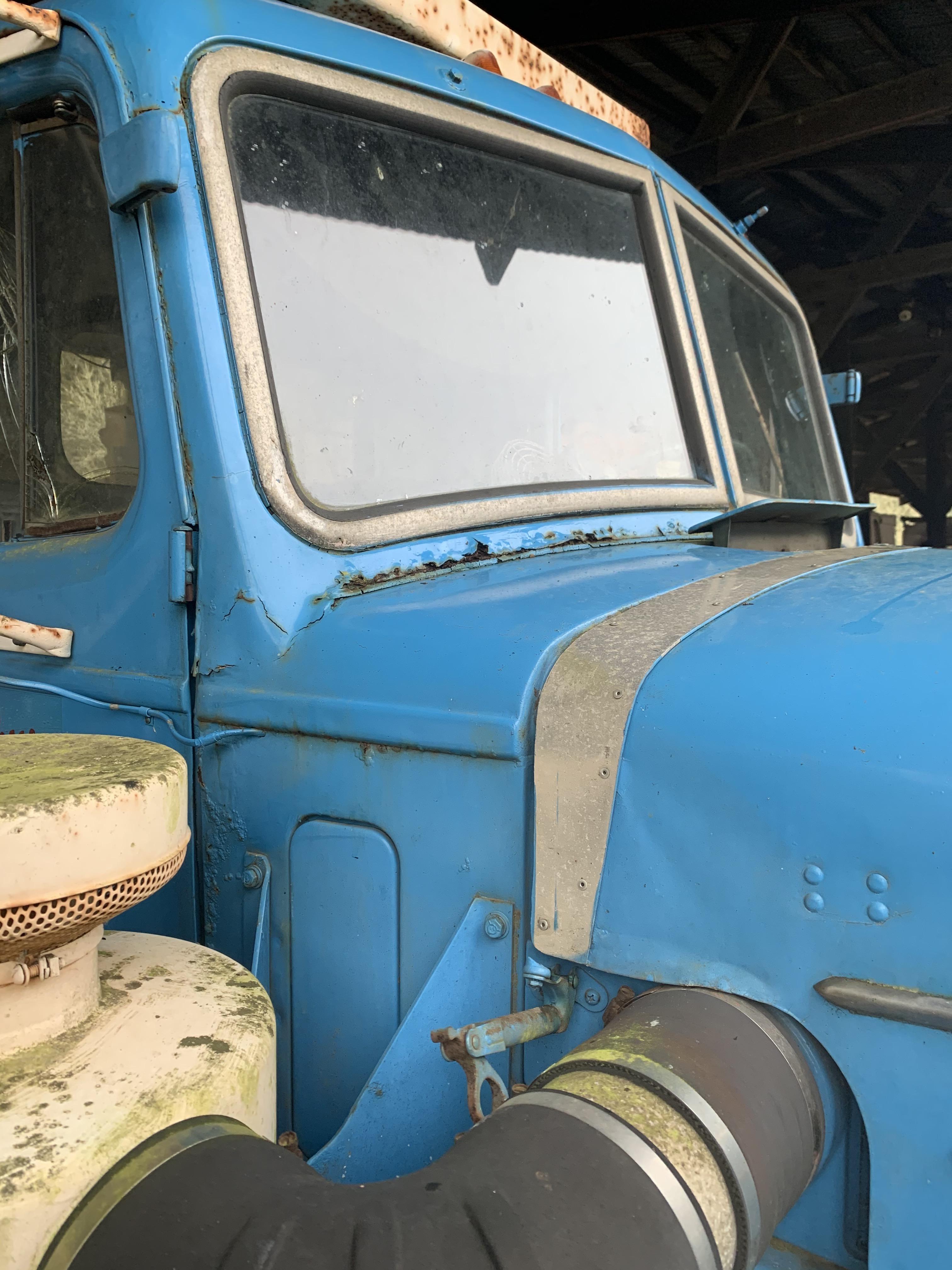

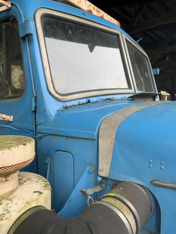

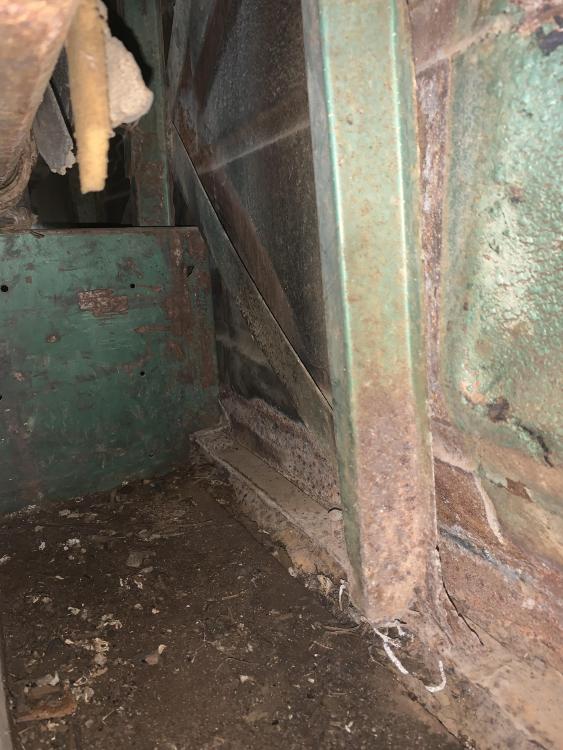

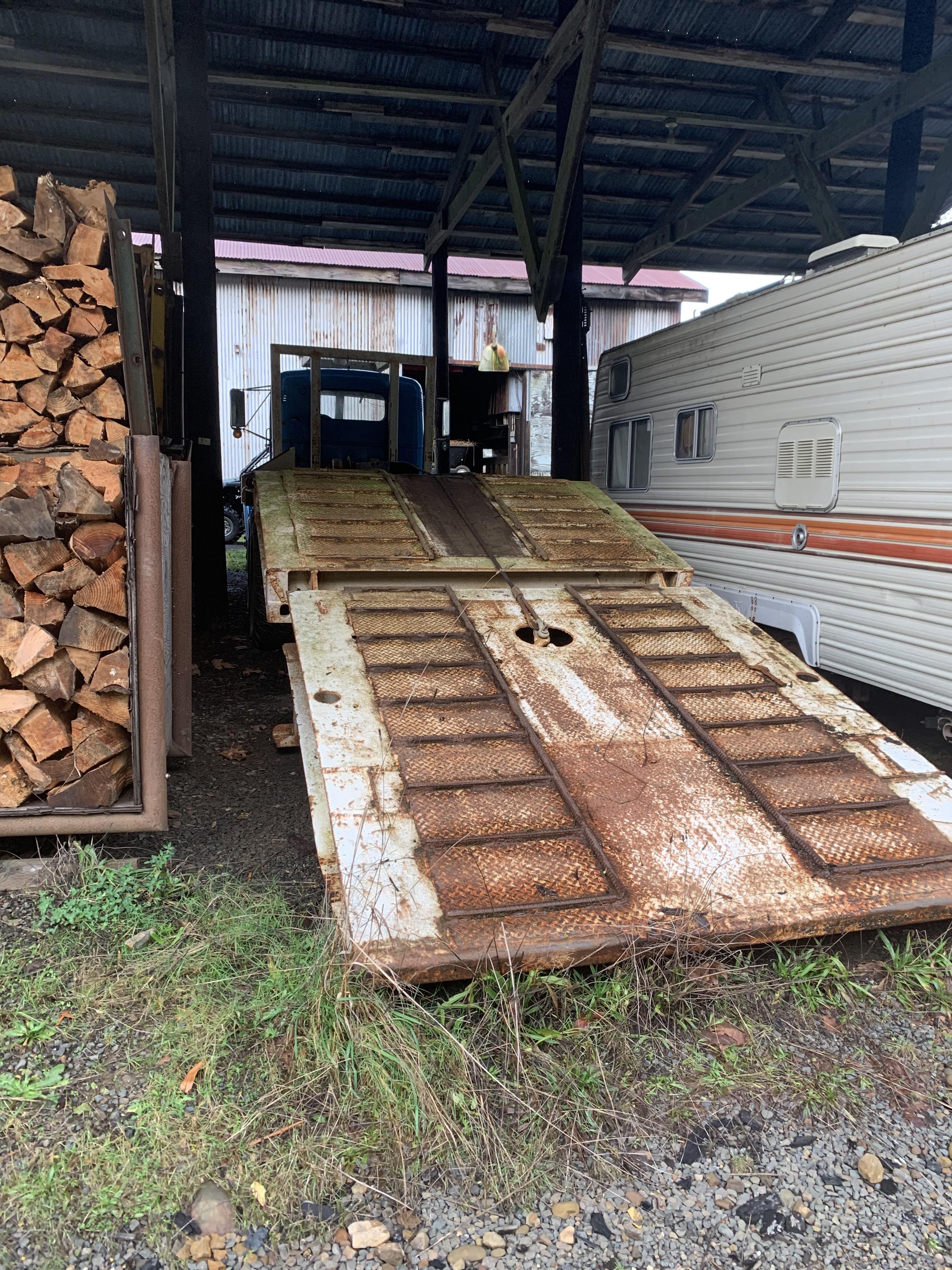

    I stopped and looked at it as i work in that area sometimes. Its all there/pretty solid but needs everything as Been sitting since the mid 90's based on the tags. Usual rust on the bottoms of the doors/A-Piller/Right front fender/ has holes on the top/back of the cab has been patched up/some floor patches as well. Motor turns by hand. 673NA Current owner seems willing to deal, but a major project in my eyes to get it rolling again. He says things like "tires are all good"... translation they are black and hold air but at least 30 years old. "Tanks are full of fuel"... 30 year old fuel... But it is a complete B75 single axle that someone should clean up... worth saving but more time then i have right now. PMC
