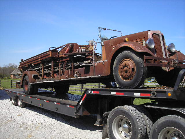

  15. Does anyone have any idea on oil filter for 1947 mack fire truck with EN 510 engine. I helped save one from the scrapper and got a friend to buy it! He has got it started but wants to change oil this weekend. I don't have any parts books or catalogs that old. Thanks

  17. Here is what I am going to do, Take the original assembly off, build a bracket to mount a oil filter head and spin-on filter( Baldwin OB1308 head and Baldwin B7577 filter). When you take off the mount there are 2 threaded holes, the 1/2" is the inlet for the filter and the 1/8" is for the return. Make your lines and your in business. Should be about $60 or less for head and filter, $30 or less for lines. Can't find filters no more, they were over $50 at swap meets.
