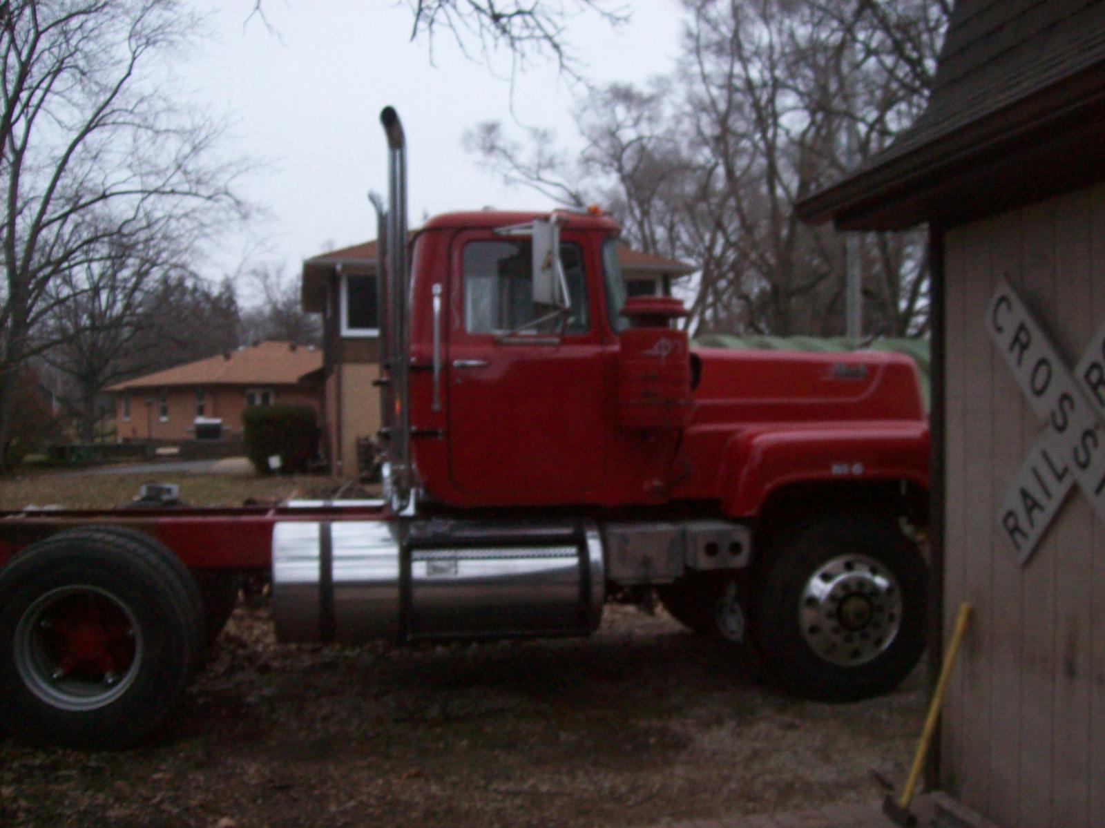

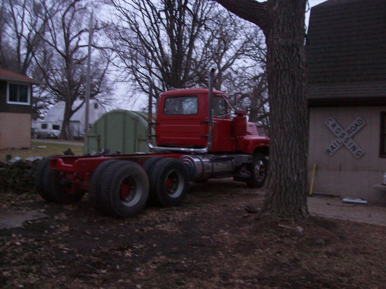

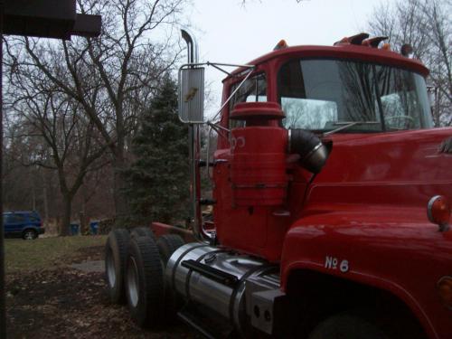

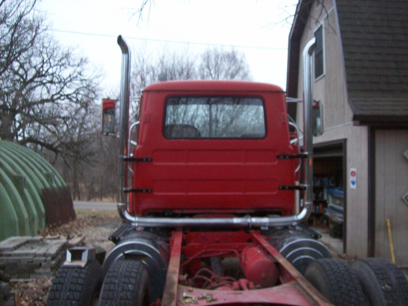

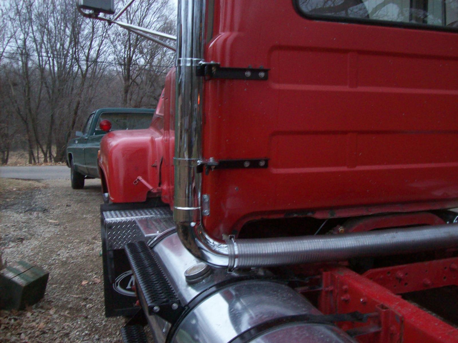

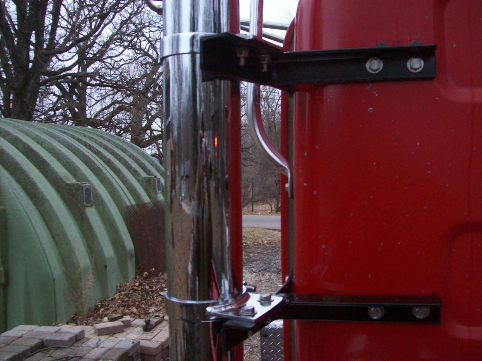

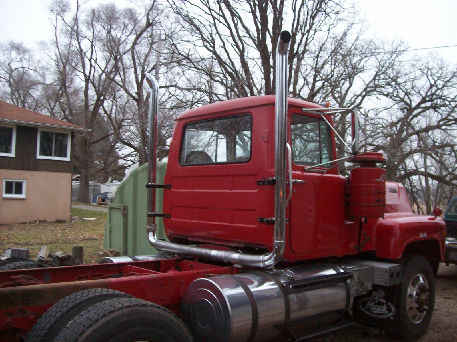

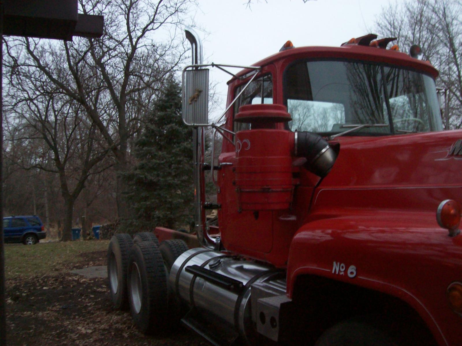

Its a four inch exhaust the engine has flex pipe coming from it to the pipe mounted to the frame then the Y pipe is mounted to the frame the cab is mounted solid on rubber bushings so not much flex there but I added stainless flex pipe from the rigid mounted Y pipe to the stacks so any flexing will be taken up between the Y pipe and exhaust stacks. -
I have been working for days putting on a new exhaust in the damp nasty weather caught a cold in the process but I think I have it where I want it and achieved the look I was after. I fabbed up some brackets out of steel I had laying around hours of fitting measuring welding than taking it all apart and painting them these stacks are really attached solid I couldn't believe what that little piece of steel flat stock bolted under the hand rails does to stiffen it all up. I have the exhaust running down the frame rail its attached rigid to the frame I will be welding up a bracket to attach the Y pipe to the frame cross member tomorrow all stainless steel hardware took the rusty bolts out holding the hand rails to the cab and reattached them with stainless steel bolts and washers with any luck it will be finished tomorrow.
