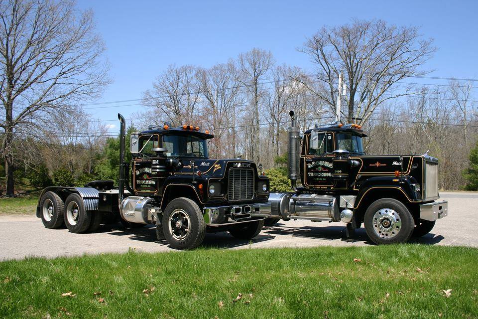

  6. My new desktop background. Hadn't seen this pic before so thought I'd share as I never remember Fleet Friday, haha Not sure if they're dark brown or Black
