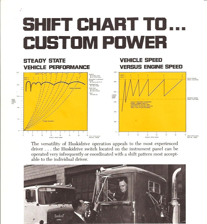

There was a discussion in the antique group in regards to 'Old Mack Engine' and Brockway's Huskidrive was mentioned. This is when Brockway used a custom torque 270 Cummins, a 5 speed Fuller trans and a 2 speed rear. Brockway used (2) dogs on each grill to symbolize this, both on the conventional and cabover trucks. It was also carried over the the 700 series trucks but fairly uncommon. Here is the factory literature...

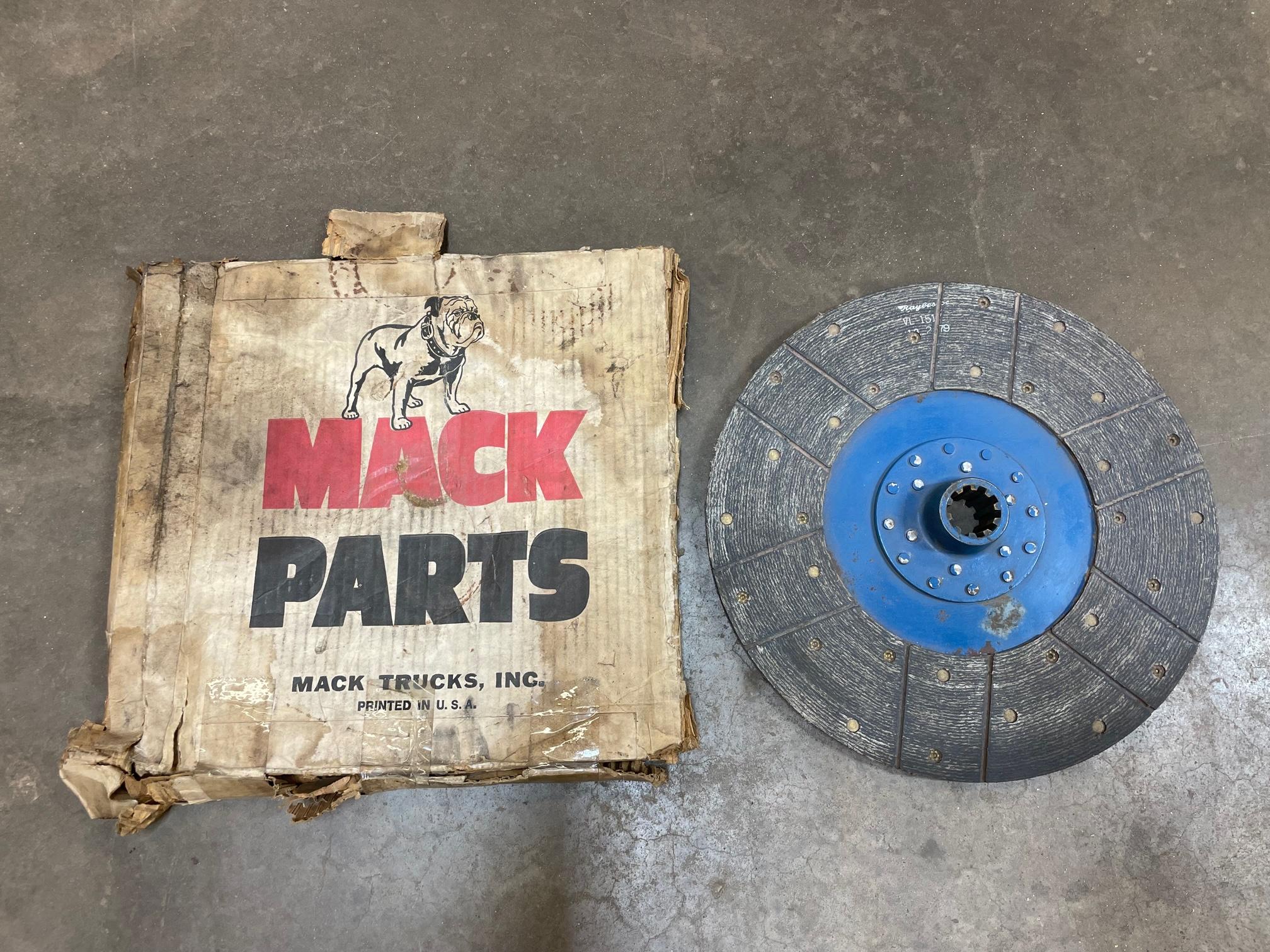

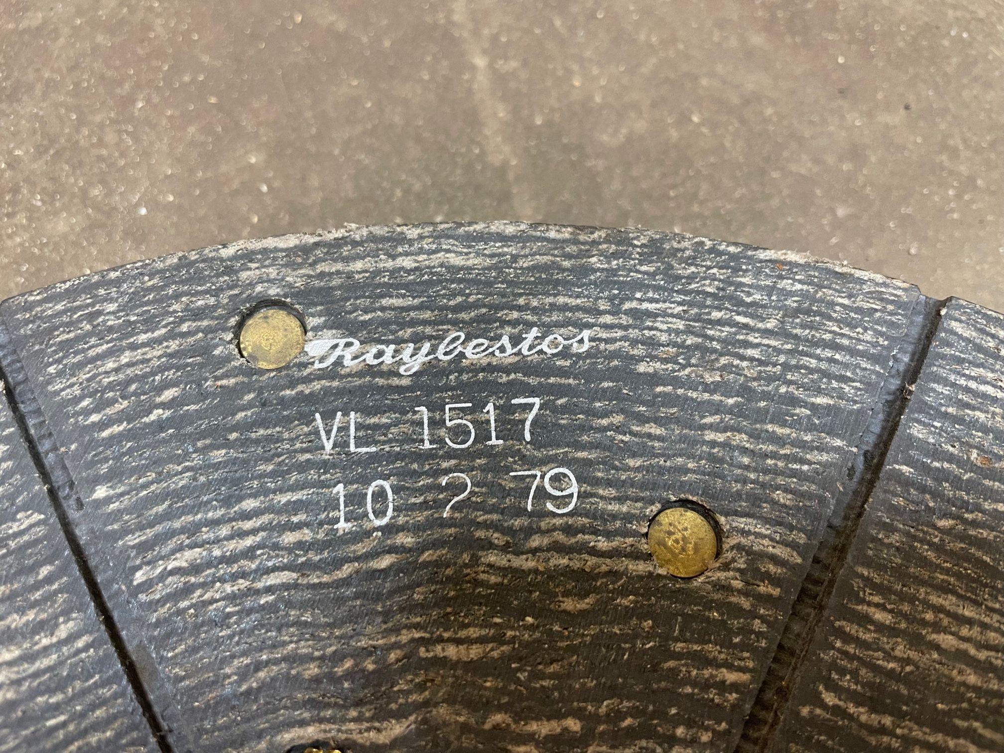

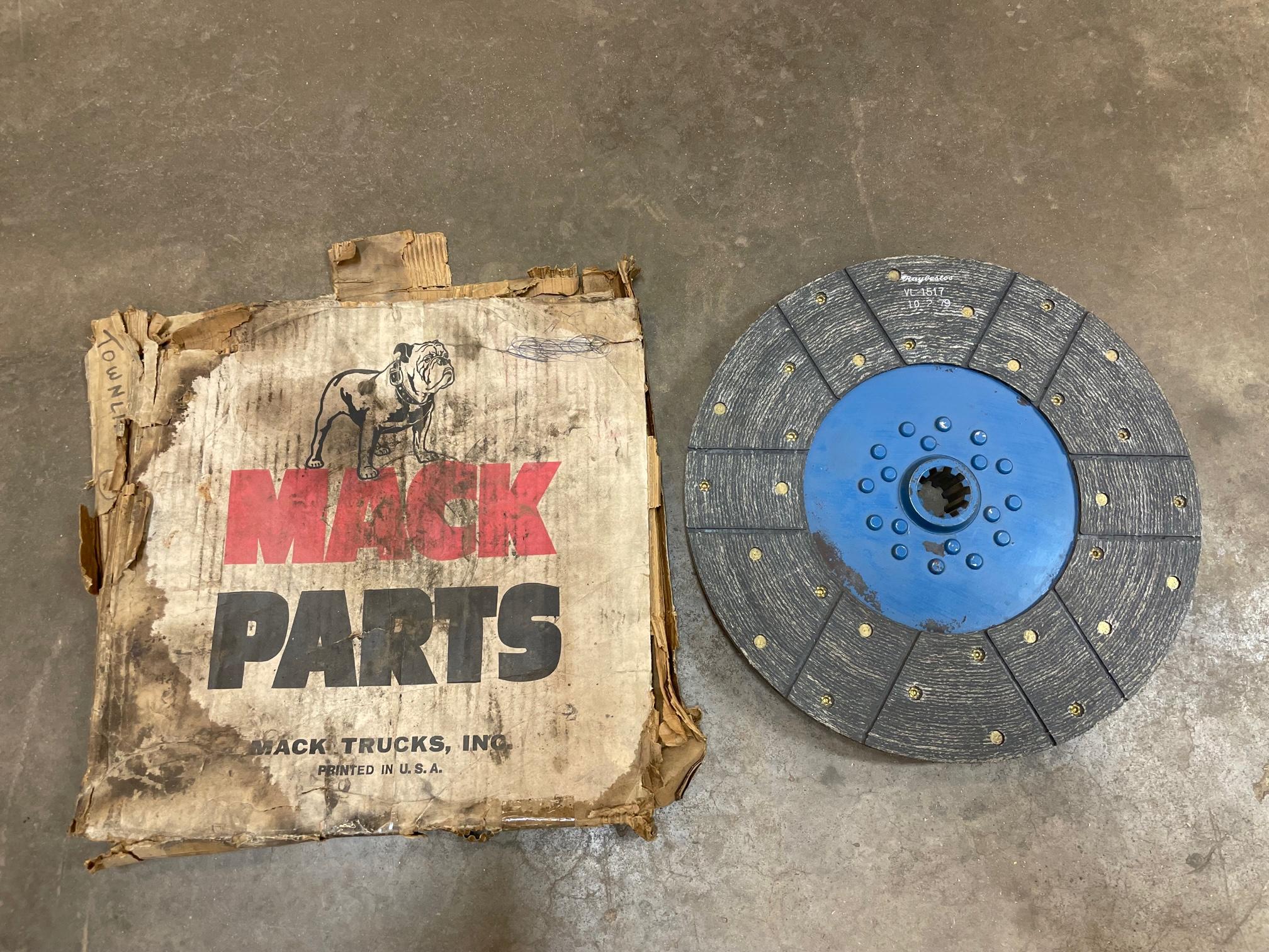

I have new a Raybestos 15" 1-1/2" 10 spline clutch disc that is labeled VL 1517 10 2 79. I'm guessing VL 1517 is the part number and 10-2-79 is the date of manufacturer. It came in a Mack box that's in really tired shape. The part number on the box may have been 368D or 3680. I bought it for my 55 Brockway with the 5 speed Fuller 5A430 trans. The only problem is that it's too thick so I can't use it. Would anybody be able to identify this clutch based off of the Mack or Raybestos part number? I tried to find a vintage Raybestos clutch book but the only one I could find was on ebay for $300... Any help would be appreciated! Tom
