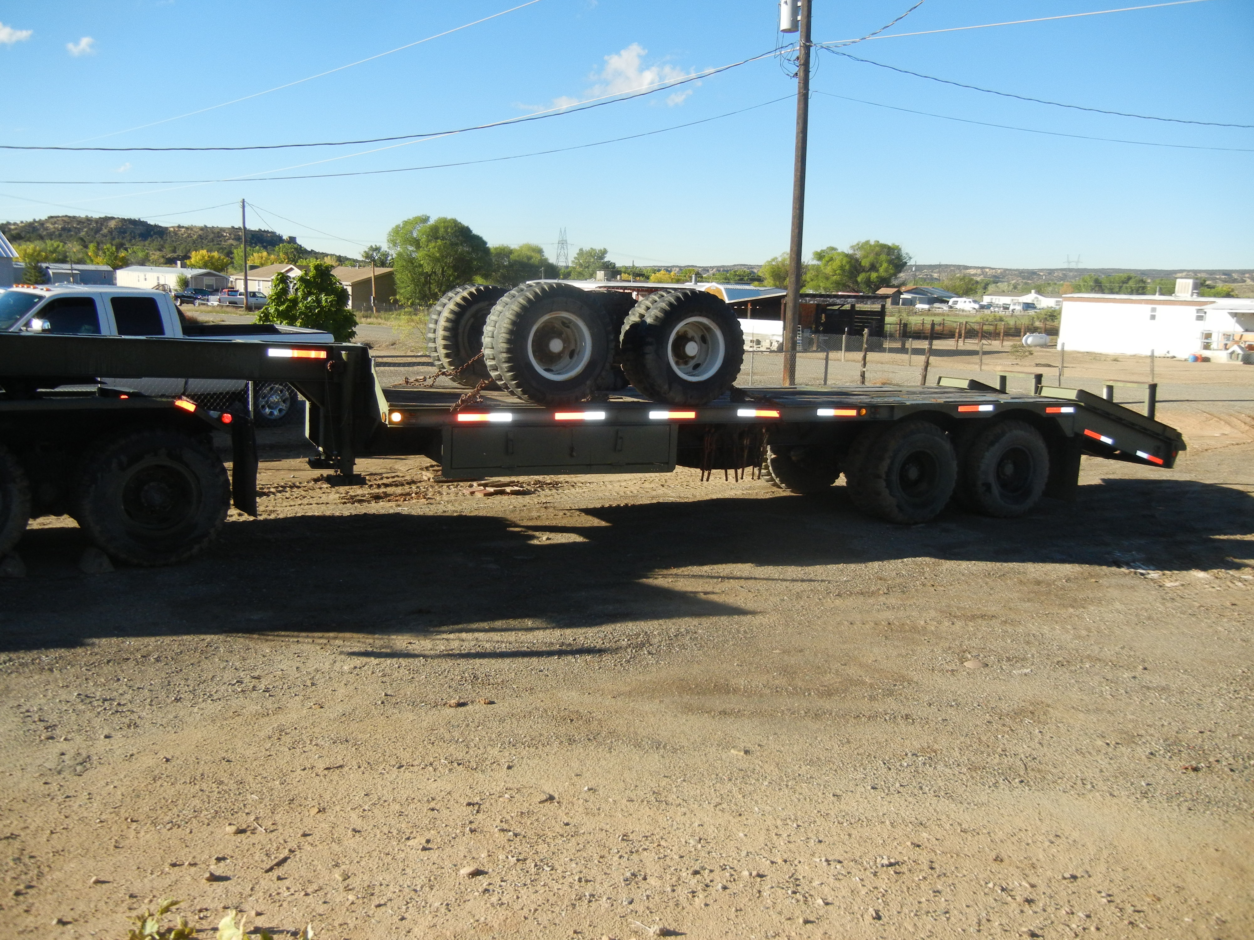

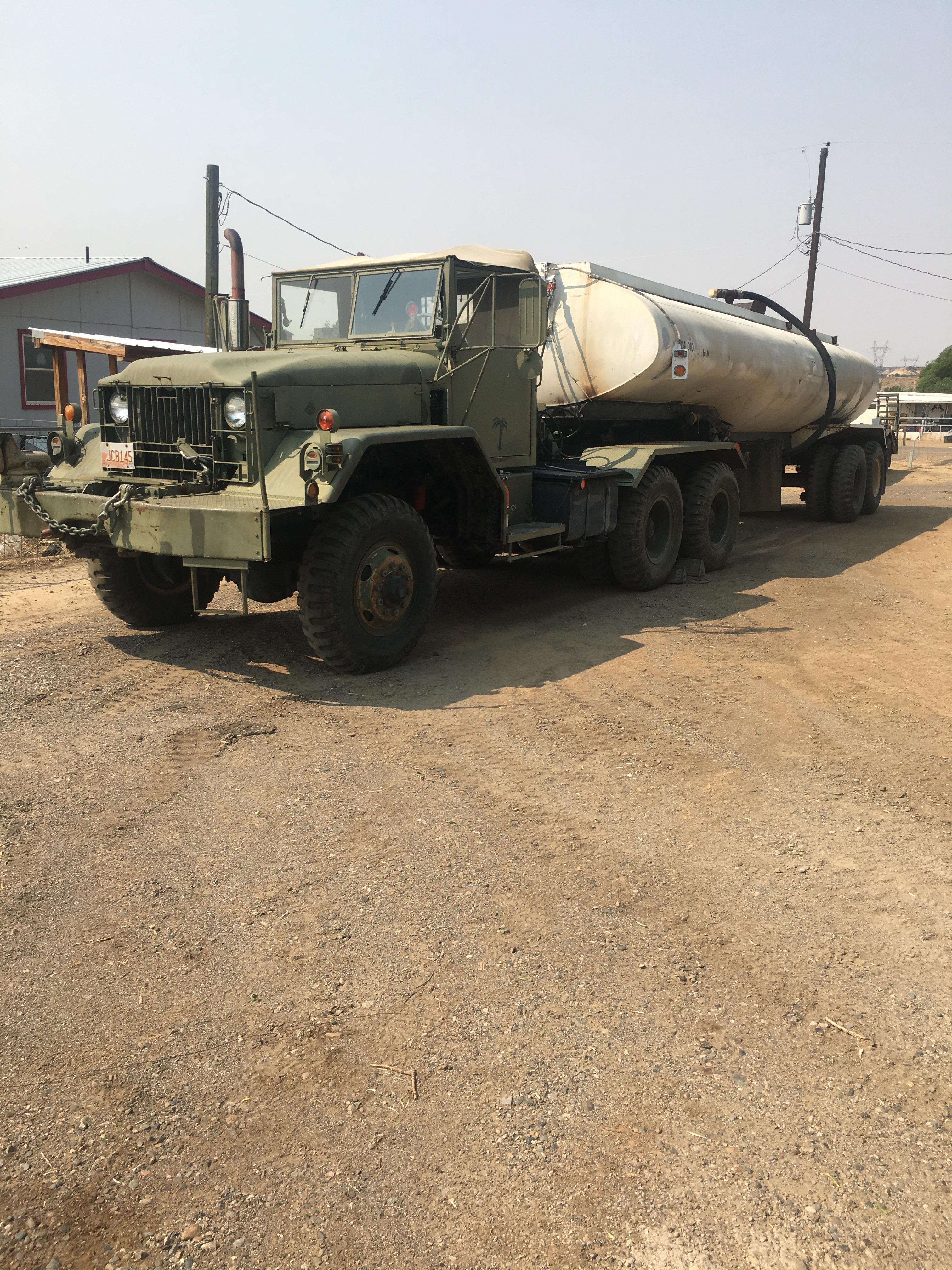

  4. Pictures hauling was water and picking up a van to use as a shop.

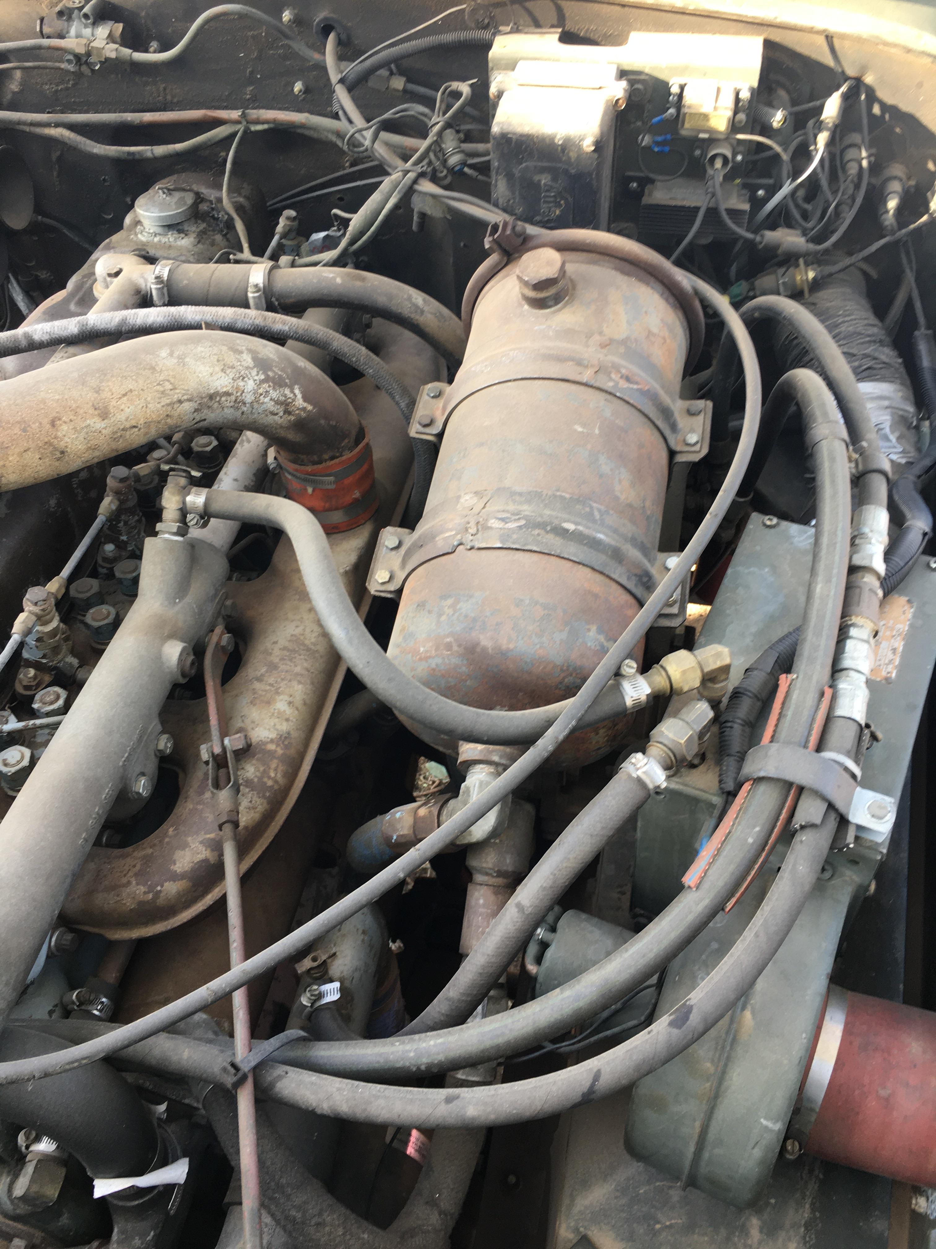

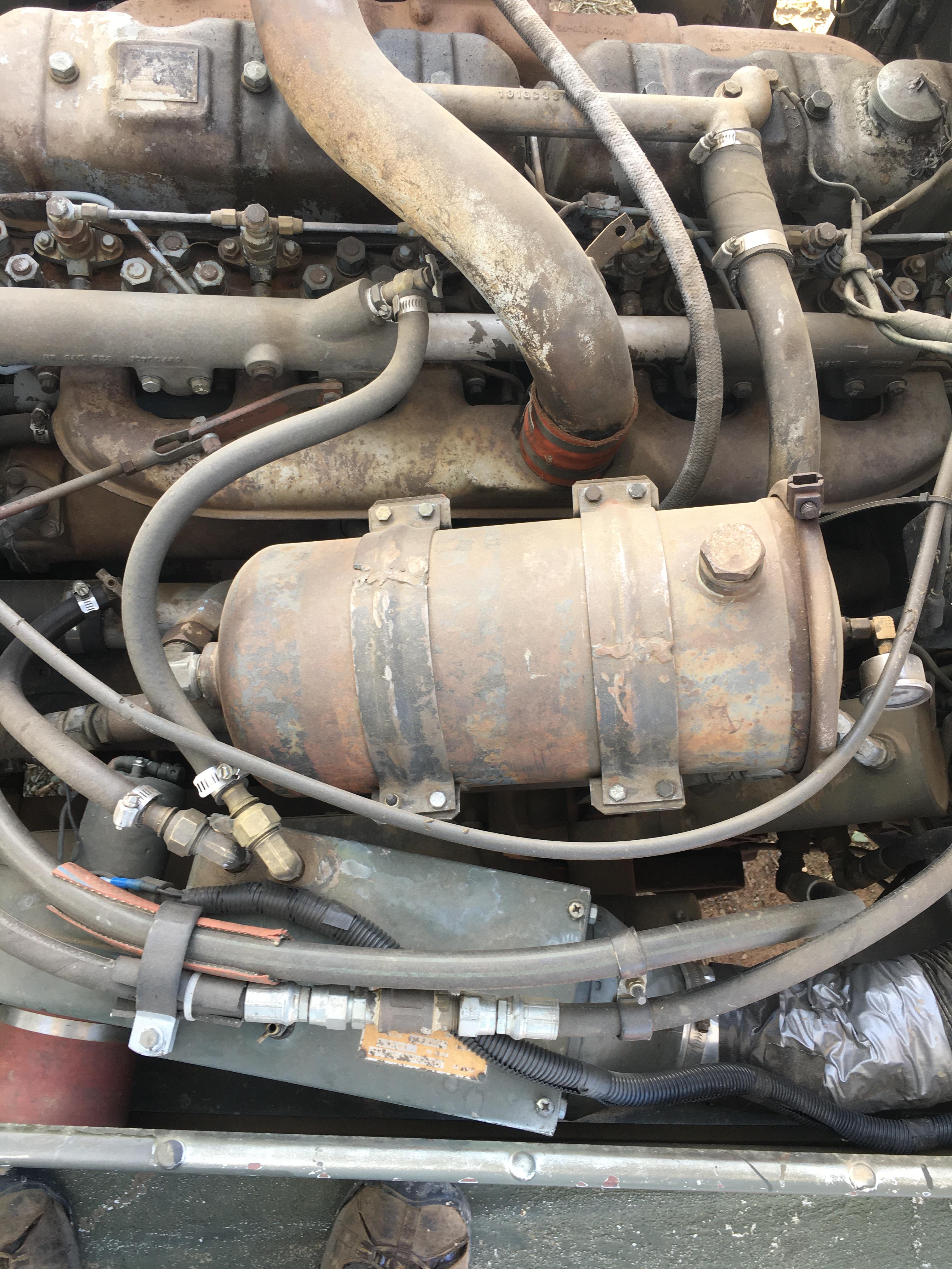

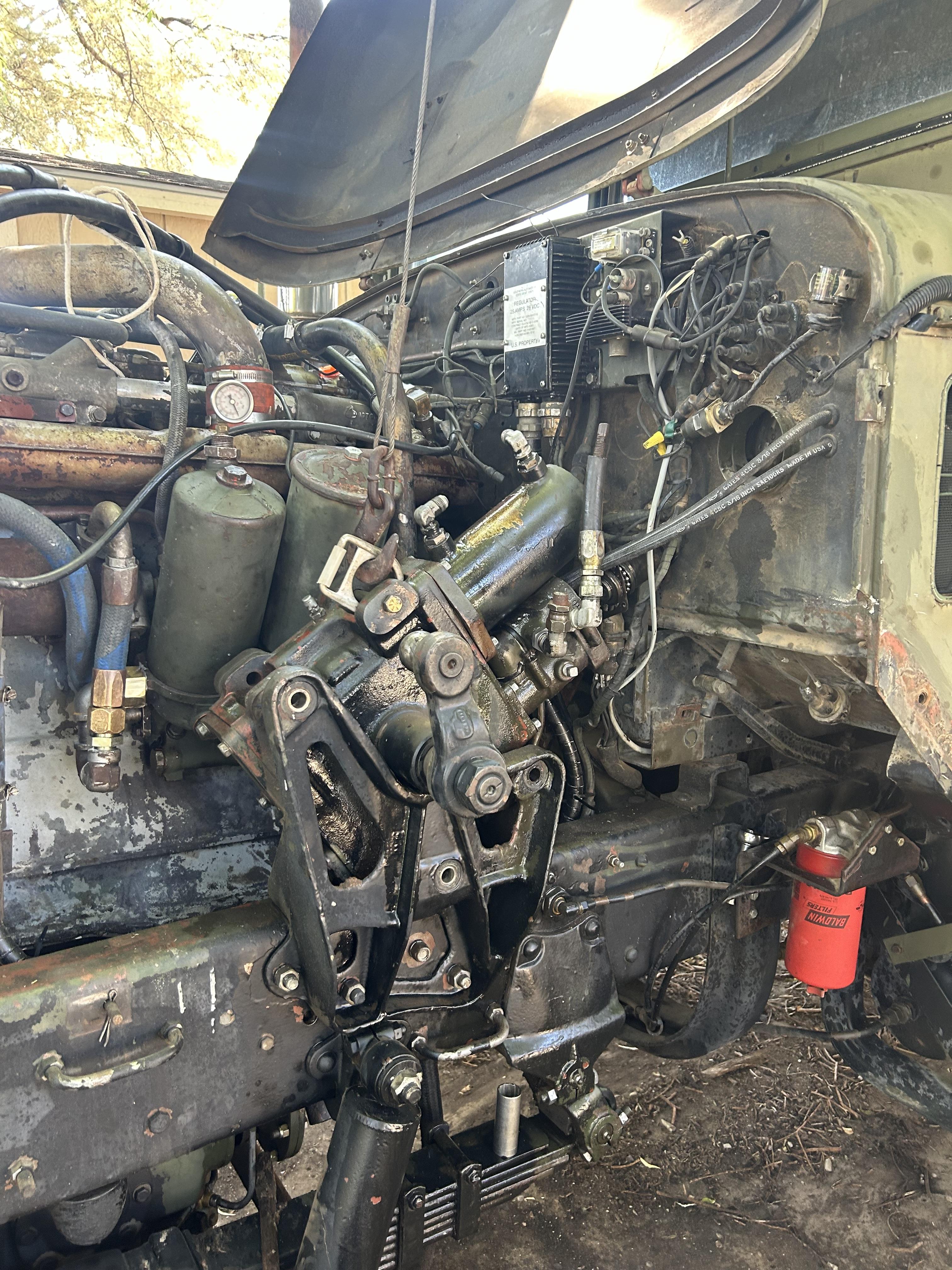

  5. I bought this 1967 M52A2 from Boyce equipment in 2008 they bought it at an auction from the forest service it had sat outside the fence at one of there yards for 20 years . In the time I have had it I added a rear winch rear fenders and replaced every brake part where the first on the list 'I use it for fun and also have two trailer an 67 military fuel trailer used for hauling water and a 1954 Military wrecker lowboy . Just over 10 years ago the multifuel engine lost a piston and I found two Mack engines at a salvage yard for $500 one is a 673P that had a turbo added and the other is a 675 with a broken intake manifold someone lifted it with a chain I ordered the right bell housing from Memphis Equipment and got the 673 P put in and hook up just to see and it started since then I have been upgrading parts to parts that should be on a Military Mack engine my latest upgrade being the right oil filter assembly I have had two other large canister oil filters one took one large filter and the other held two shorter filters end to end .

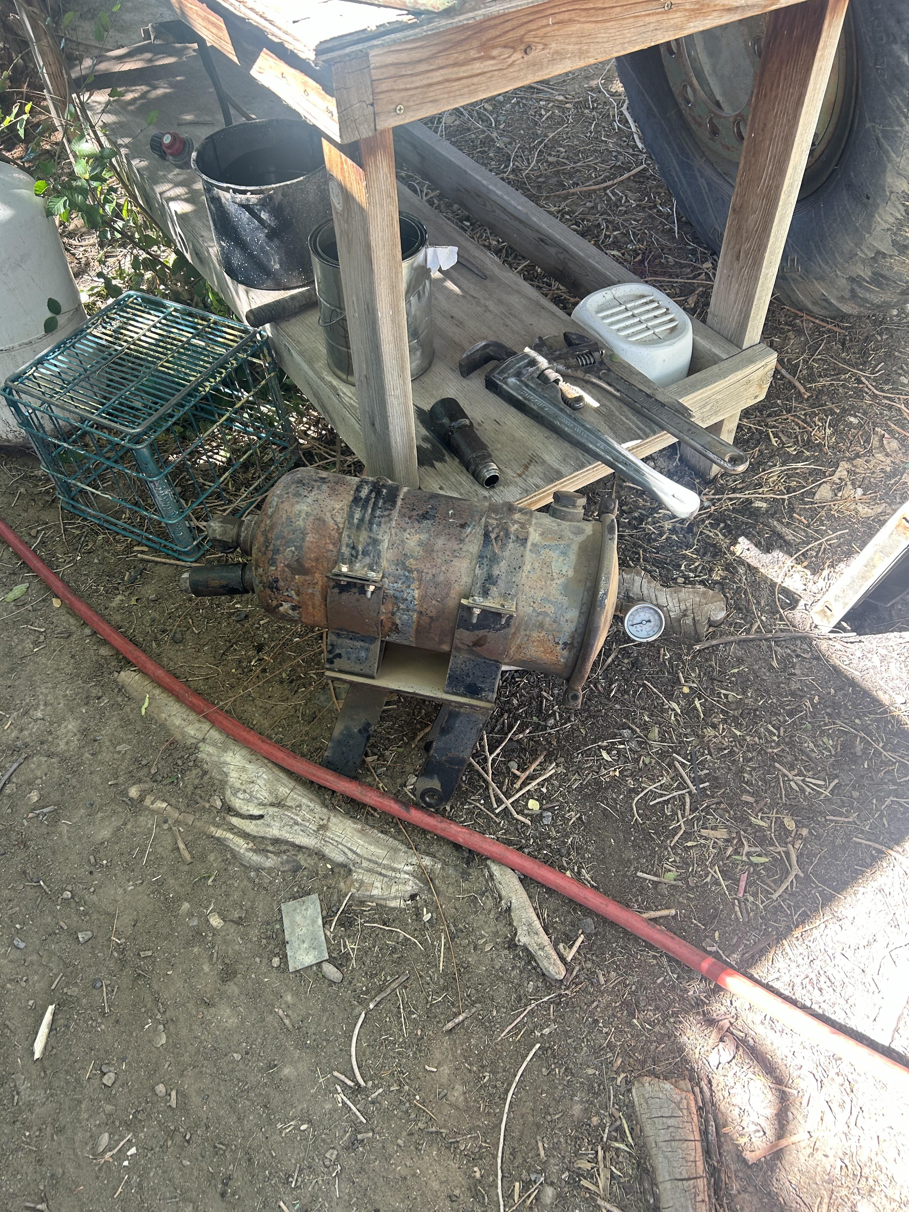

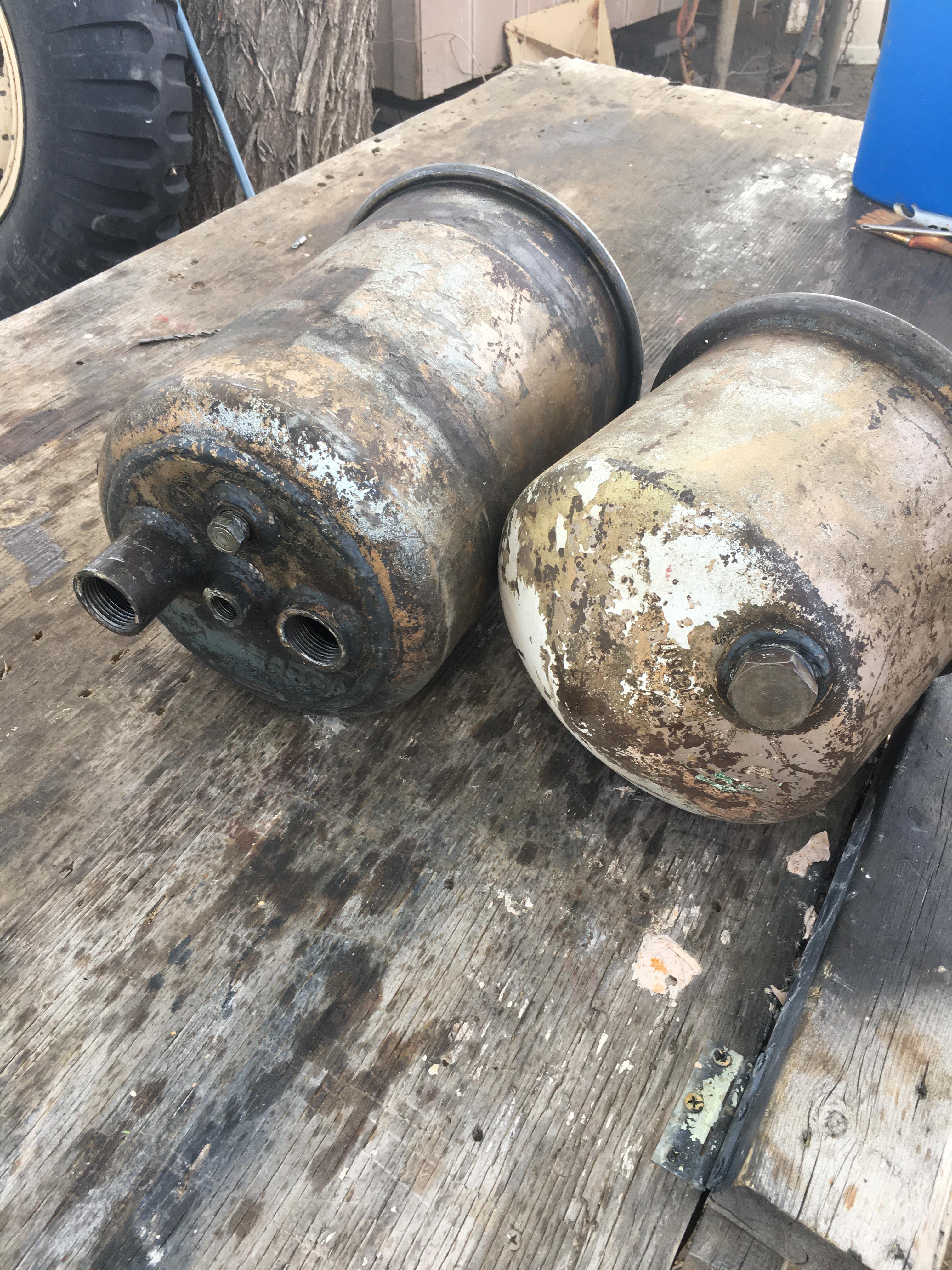

  12. The filter housing on the table uses the Baldwin filter # P-706-m The filter on the engine uses the two filter one on top of the other ( Baldwin P194 ) there is a hydraulic filter (P194 HD ) both housings have one inch ports in and out .
  13. The Baldwin filter # P706-M the gasket is a O ring and I don't have a number for it .
  14. when you get the filter get a new O ring
