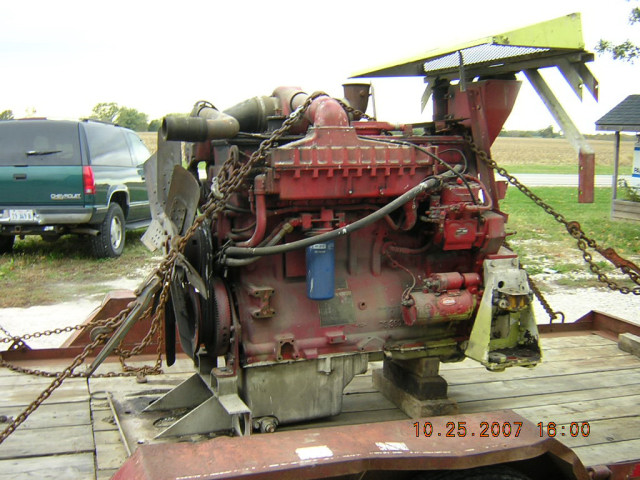

Here is a photo of a 1693TA sitting on my trailer, and the 1693TA in my RL755L. This engine is just about 3900#, (as shown) and measures 63 inches from the floor to the top of the turbocharger with the oil pan touching the floor. The bracket at the back of the engine on the trailer supports the p/s pump reservoir and what was the rear cowling of the fire truck this engine is from. It would not be required in another application like this. An inline Mack engine measures about 38" tall.
