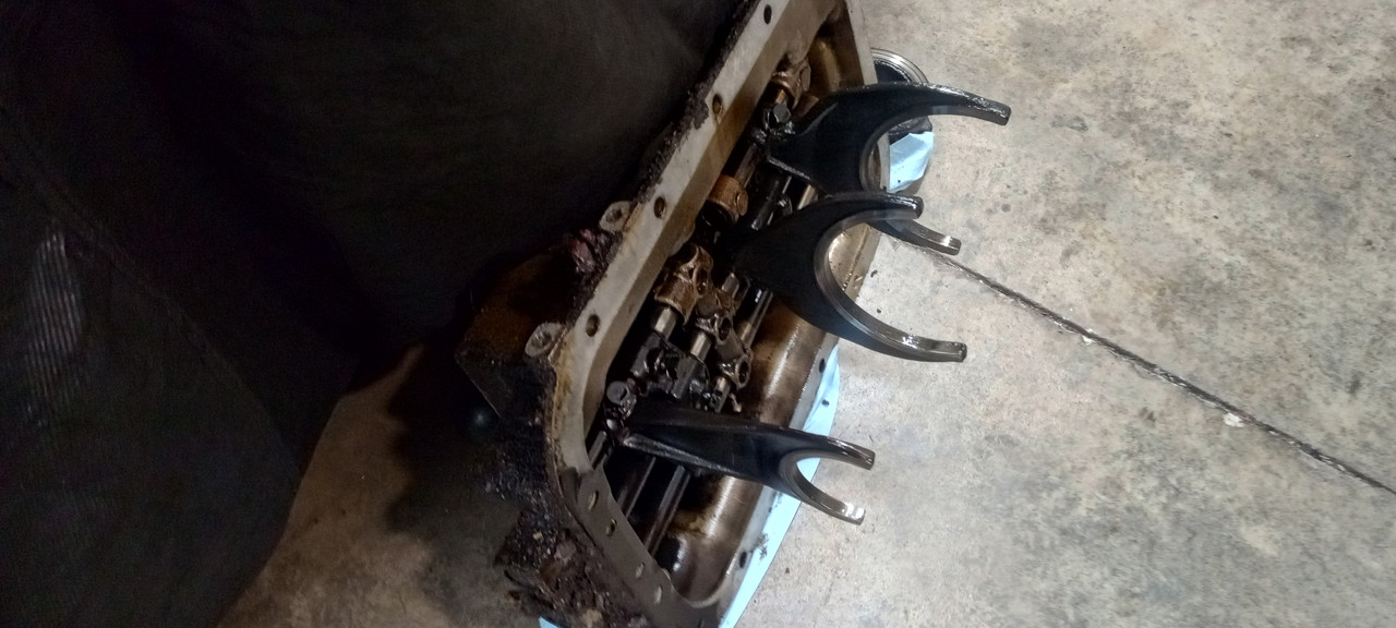

This is only picture I have handy of lid.  Not sure if I have anything better.
I may have something on my home computer that I backed everything up on.  It may give some insight on what happens when it is put in a gear and what may be holding it.

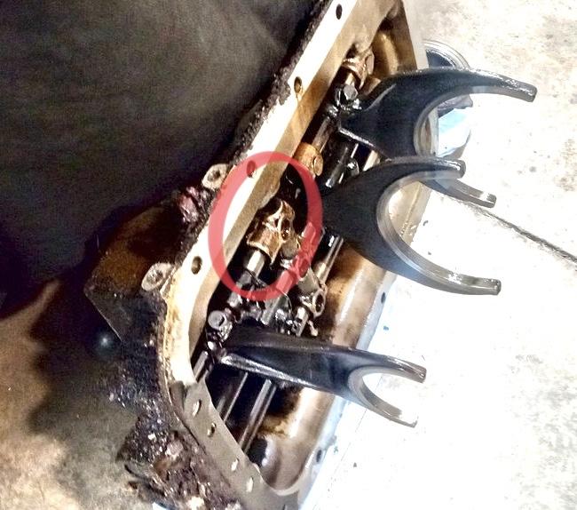

Again, thanks for the pic.  I turned the lights on to see it better…..
Don’t know if that’s the 1st gear fork, but is there a detent ball in that location circled ?  Does the rod slide in/out, or just the fork move on the rod ?
I’m not familiar with this transmission internals, but that is what I’ve been thinking as a possibility. ???
If so, is there an exploded view of that boss and a detent ball ?
Can the ball be deformed or flat spotted ? Just wondering.
And what position is the fork and rod in, when in gear vs out on 1st ?

1st gear is at the rear of the main box, in front of reverse. 1st and rev. share the same fork and sliding clutch. the small fork should be 4th/5th..
So the 1st gear fork is on the right side of his pic ?
Didnt know what way he had the cover laying for the pic.
The fork/rod would operate the same
