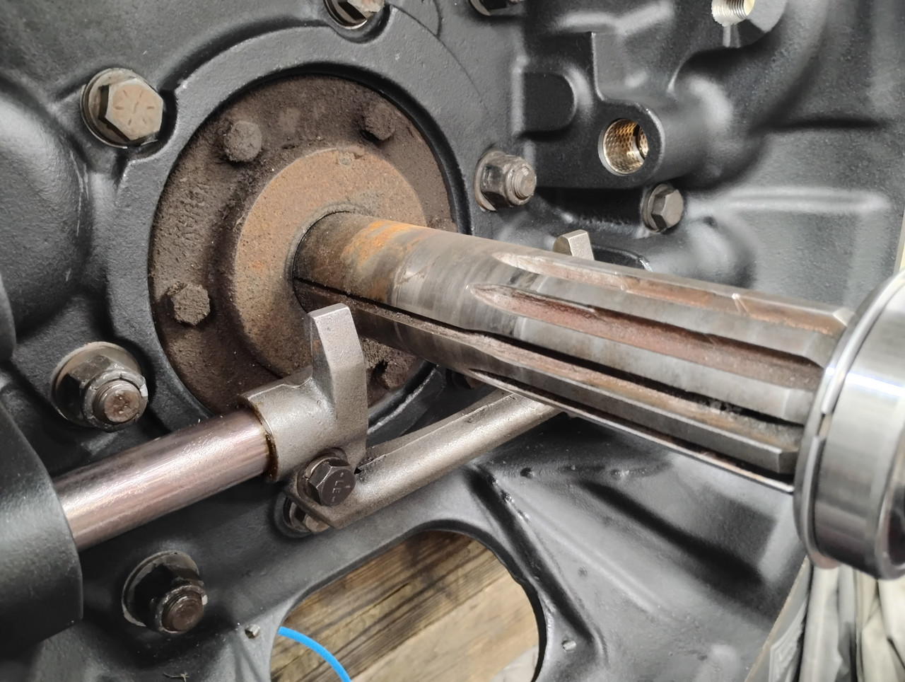

Ok, my transmission didn't have a clutch brake on it because it was from a stationary powerplant and didn't get shifted.

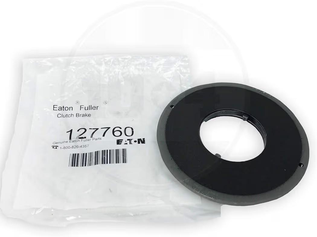

Are the brakes pretty generic as for fitment?  As long as it is for a 2" shaft it will be okay?
I know my input has a groove for the brake to engage.

Other than type, 2 inch should be what you need.   (one piece torque limiting...2 piece replaceable or "hinged type" replaceable).  By replaceable I mean without removing the transmission. I really don't know if the input shaft retainer would be any different.
