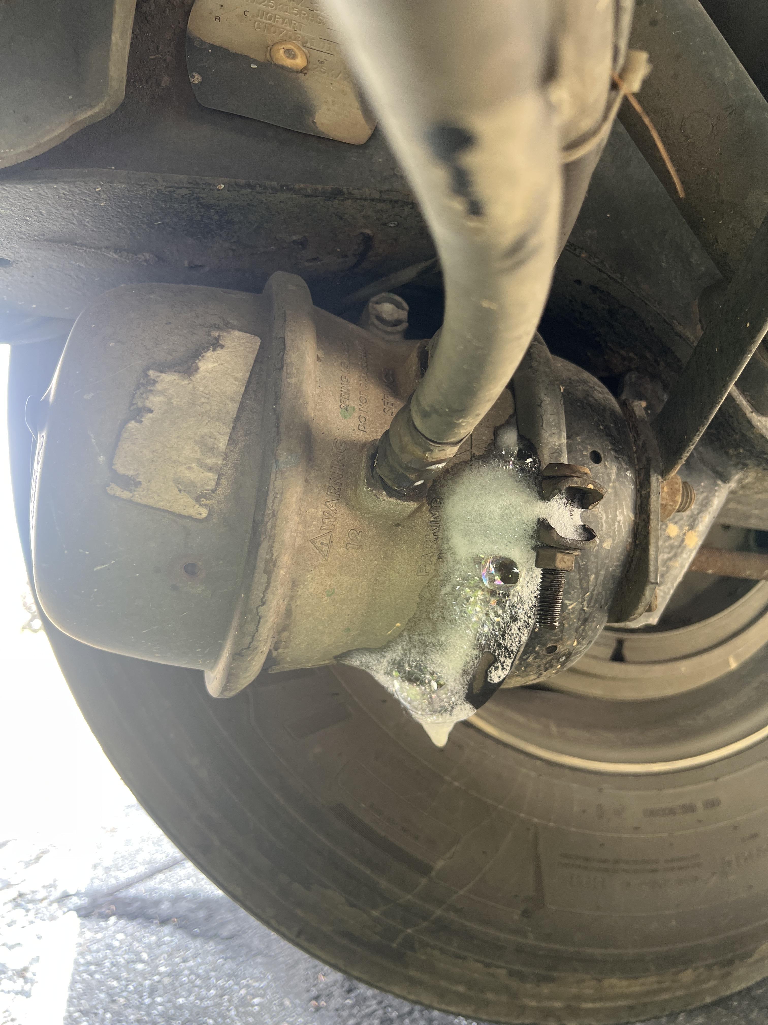

It did come apart when i removed it but okay. Got the new maxi valve in was able to finally get the trailer air supply knob to stay pushed in, have something holding down that trolley brake, and found an brake can leaking on the last rear axle.
If you’re going to change that can you stay on the slack adjuster side when you undo the clamp or you’ll end up warring it! Looks like a long stroke 30/24 kind of odd! Release the trailer brakes before you try and block the wheels!
got scared for a moment !! looked like the bolt was cut yet the brake can is NOT caged .!!!!  hopefully the soap is covering the bolt. dam that's dangerous.
That would most likely be a leak in the service side. (still needs to be addressed)  Wouldn't have much effect on the red knob symptom.  You'd need to chock the wheels. Then make sure the wheels are cholked, then push the red one in and look (or listen) for air leaks in the trailer.

a leaking chamber on the service side will NOT drain the air tanks unless you are sleeping in the driver seat all night long with your foot on brake pedal . original statement was  " gage goes to 80 when i hook trailer and push in button. tanks are draining over night there is another issue
