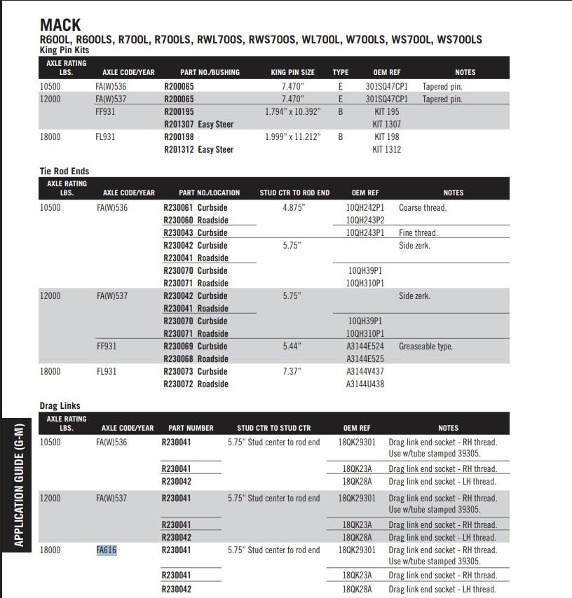

4 hours ago, sdthoren said:
I'm seeing 18k # weight capacity from a parts catalog/pdf (PB-8951).
Many thanks for that info.18,000lb would seem to fit the build of this Cruiseliner.Would Meritor have made this axle or just supply after market parts?
Paul
Paul
99% sure that's a Mack axle, lots of Mack part/model numbers cast into it.  Seems like Meritor bought out Rockwell years ago, who did build a lot of front and rear axles in the US.  They are continuing the Rockwell line as well as new stuff, but have been supplying parts for other brands as well. Recently noticed Meritor (not sure all or part) got bought out by Cummins.
