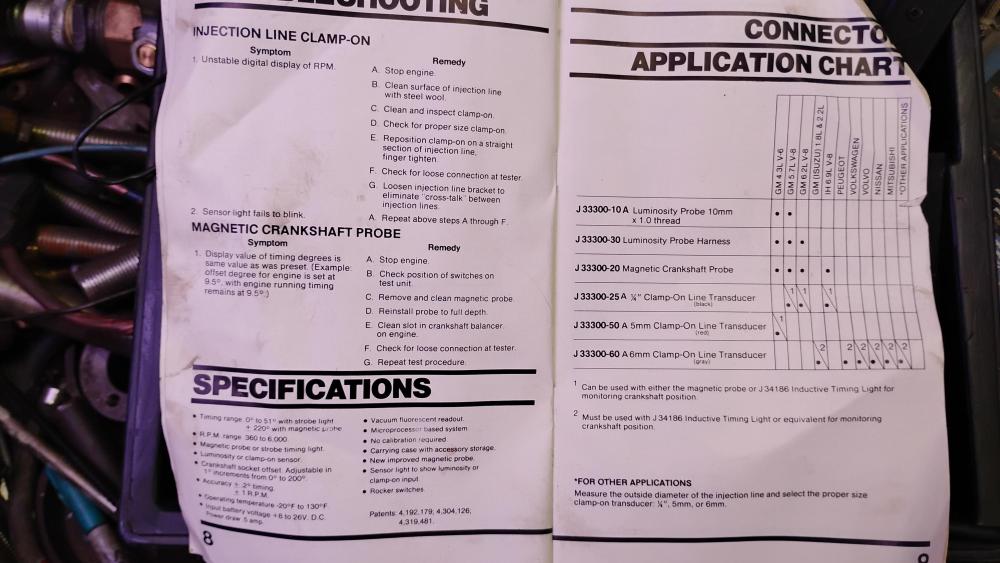

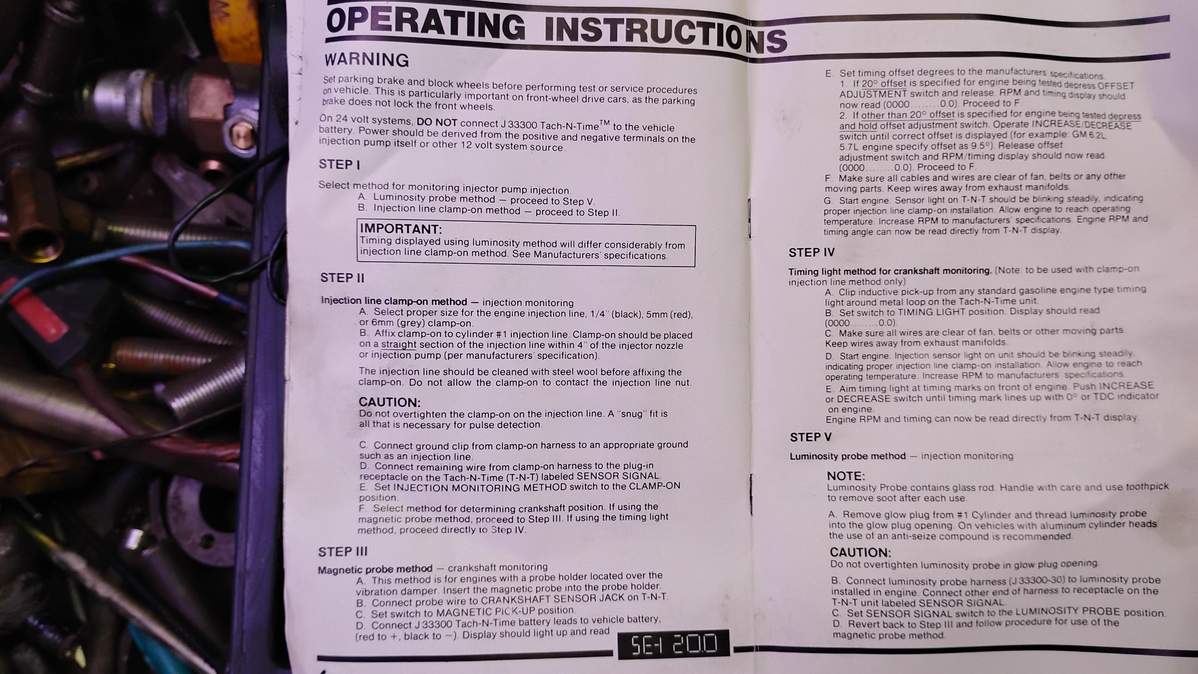

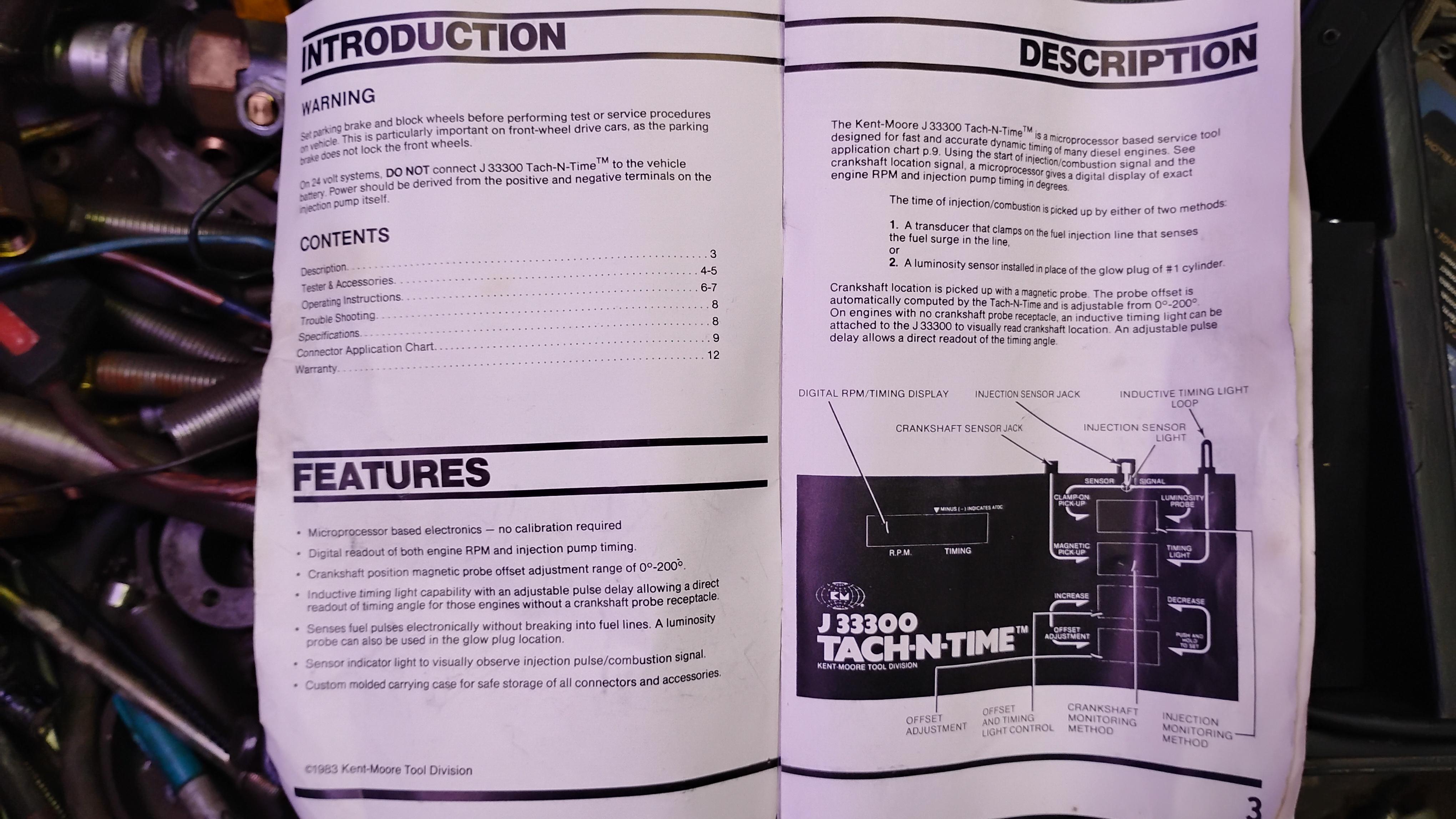

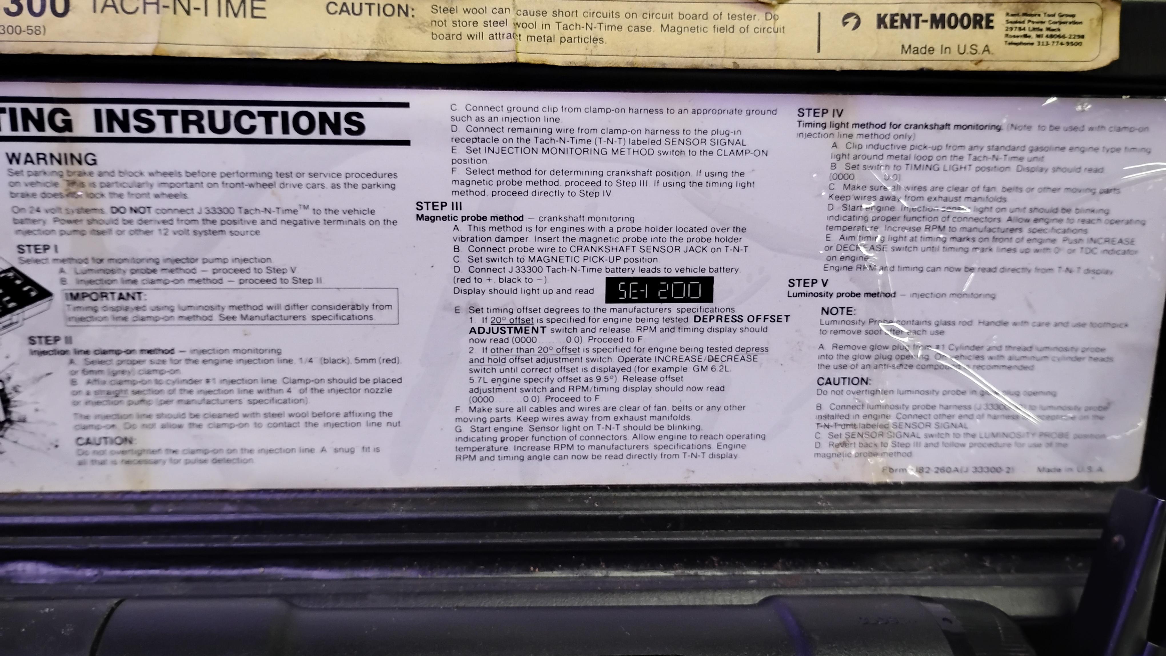

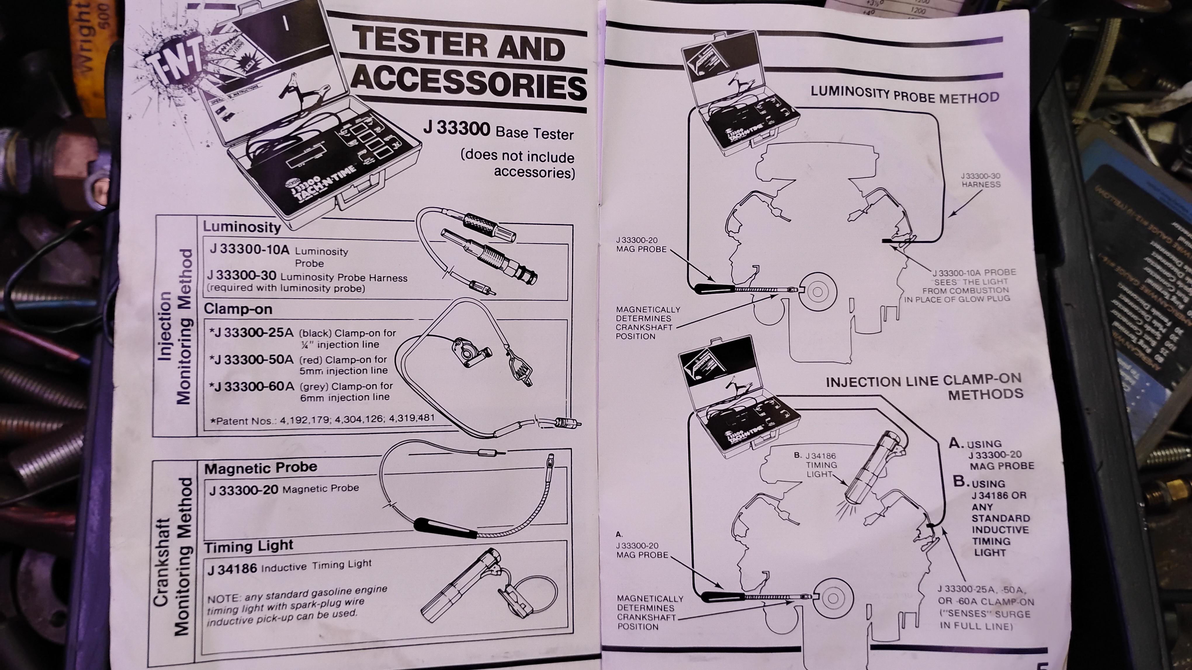

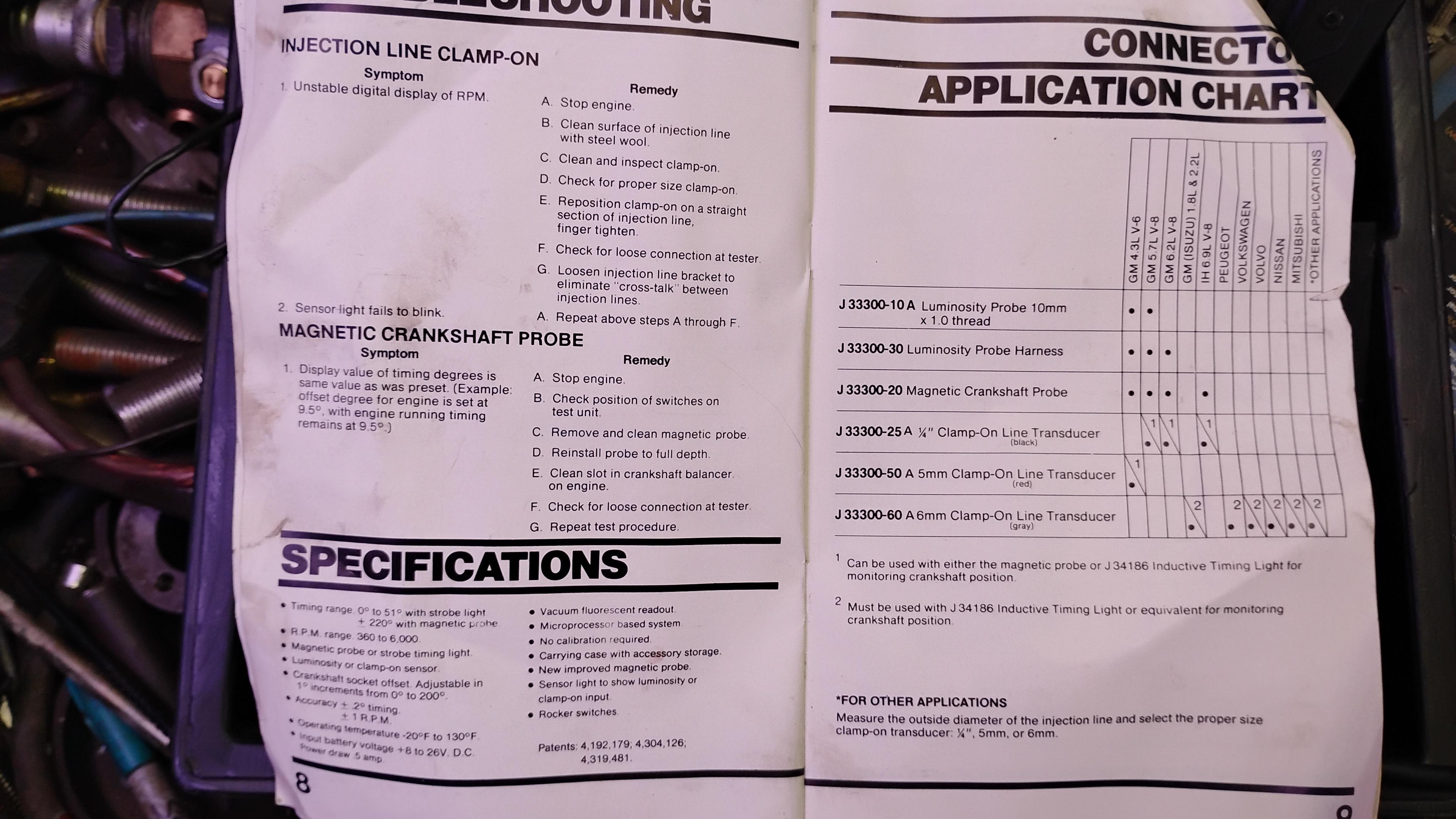

So...I figure my spill timing is out a couple degrees, probably retarded.  instead of pulling the delivery valves a few more times and messing around rotating the engine with the hard to reach crank pulley on the Western model R's; I would like to try the pulse type/clamp on timing adapter with a strobe light.  I have a Snap-on and use it on other model engines, no problem.  I haven't tried it yet on the Macks.
If I clamp this to #1 injector tube, and read the mark on the crank when illuminated by the probe, should I expect to see the actual injection timing illuminated at an idle speed, or at a certain RPM?  I know some engines with an advance mechanism in the pump (like some of the Roosa Master style Stanadyne pumps) require the engine to be at 2000rpm to accurately set timing.
