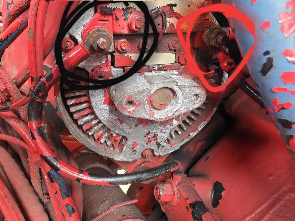

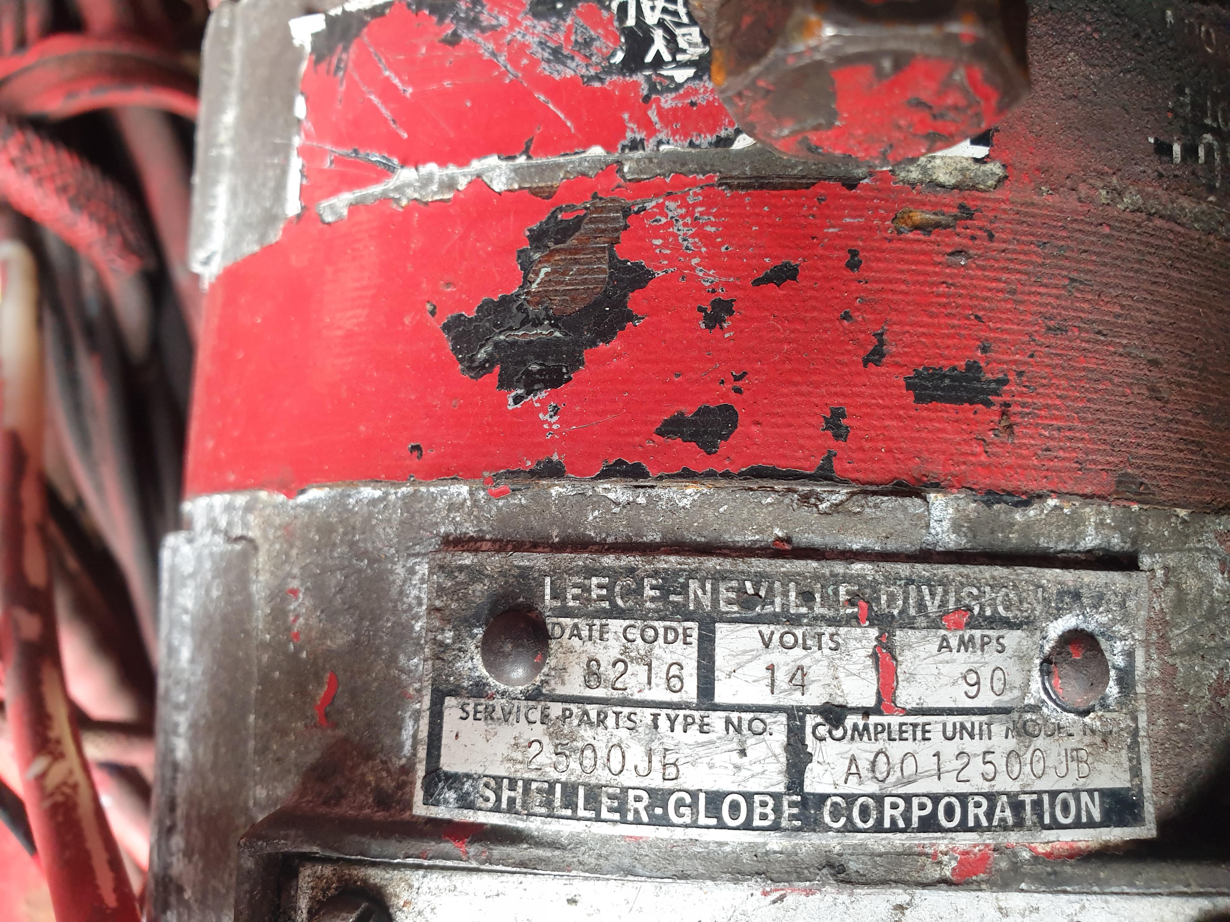

Hi all,the alternator on our Cruiseliner is not charging.It is a L/N 2500 JB unit.We have replaced drive belts,checked/cleaned all connections and grounds still no charge.We took the alternator to an auto electrician and he tested it on his bench test rig and it worked perfect....What are we missing??? He was surprised there is no charging light on the dash,his question was what excites the aternator on start up? We confirmed with Nathen in the UK that his Cruiseliner does not have a charging light either.We feel its some thing simple or something not common on Europian vehicles.Any ideas???

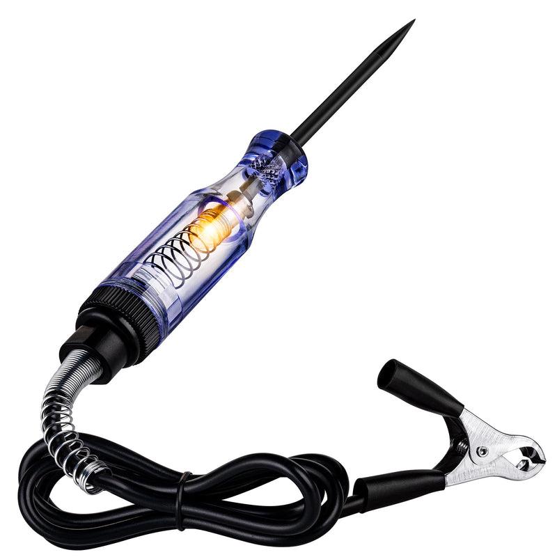

Test light will work fine, for seeing if he has power to the output terminals! There should be power there all the time, even with the engine stopped or the key off.
100% correct, if someone isn't competent with basic electrical knowledge a test lamp is far better than a multimeter
Understanding how to read the instrument and interpret the results correctly comes from propper training and thorough understanding of what people are doing
So a basic test lamp is adequate at this stage
Keep it simple and let's not over complicate things
KEEP IN MIND YOU MIGHT HAVE TO SCRATCH AROUND A BIT ON THE STUDS AND CONNECTIONS TO GET A GOOD READING
so maybe get some emery cloth and clean the nuts, lugs and studs up spotlessly clean before you begin testing, I doubt this is your issue but it gives you a good spot to start testing
and yes big dark letters because this is really important to give propper test results
Grab a test lamp, see if you have power at the alternator or not
First thing first, alligator clamp on the negative ( - ) battery terminal and the pointy end on the positive battery terminal ( + ) , the lamp should light up, if it doesn't you might have a dud globe in the tester
That is your most important test, always test the tester on a known lice supply
Then grab your test lamp, alligator clamp on stud I circled in black, with the key turned on put the probe end on the stud circled in red, does the globe in test lamp light up ? If yes skip a few steps here
If no, then shift the alligator clamp to a good clean ground or frame or better still to the battery terminal marked -
Try again on the stud circled in red, if you have power at the terminal the fault is between the negative ( - ) terminal and the alternator
If no power put the alligator clamp on the positive battery terminal ( + )  test between the stud circled in black
You should have power here if not
Try testing further back were the ground strap from the alternator bolts to the frame
Still no good test back to were the battery lead bolts to the frame and so on
If yes from above, follow the same principle as the the negative, slowly test back through the circuit, tracing out wires etc until you get the lamp to light up
When it lights up you have gone passed the fault
I think it will be something simple here to find if you know what your doing and a slow frustrating job if you don't
But stay patient and we will help as best as we can
But if to much bull shit advice, like I reckon, or old mate says these always do
And so on I'll butt out as it becomes messy over the internet

Thanks for the replys...I should have pointed out the pictures were taken before work started,more to show what type of alternator is on the truck. So far we have ...
Replaced belts
Cleaned all connections
Done voltage tests at batterys..12.4v
Voltage test at alternator also 12.4v
Test lamp also lights up across the altenator terminals as decribed by Paul
No change in voltage at alternator with engine running.
Alternator put out 14.6v on test bench...but stays at 12.4 when in truck.
The auto electrician we went to has a great reputation in our area but is a young guy.He did admit to me he has never seen an alternator with only 2 terminals.All the alternators he is use to have 3 terminals.The 3rd is connected to the charging light on the dash.This shows the driver if the vehicle is charging but also excites the alternator on start up.With only 2 terminals and no light on the dash he was wondering how the alternator is excited on start up.
With all our batterys,wireing,connections and grounds checking out as in good condition we are scratching our heads wondering why the alternator will charge on the bench but not in the truck.....
Thanks for reading guys.
Paul

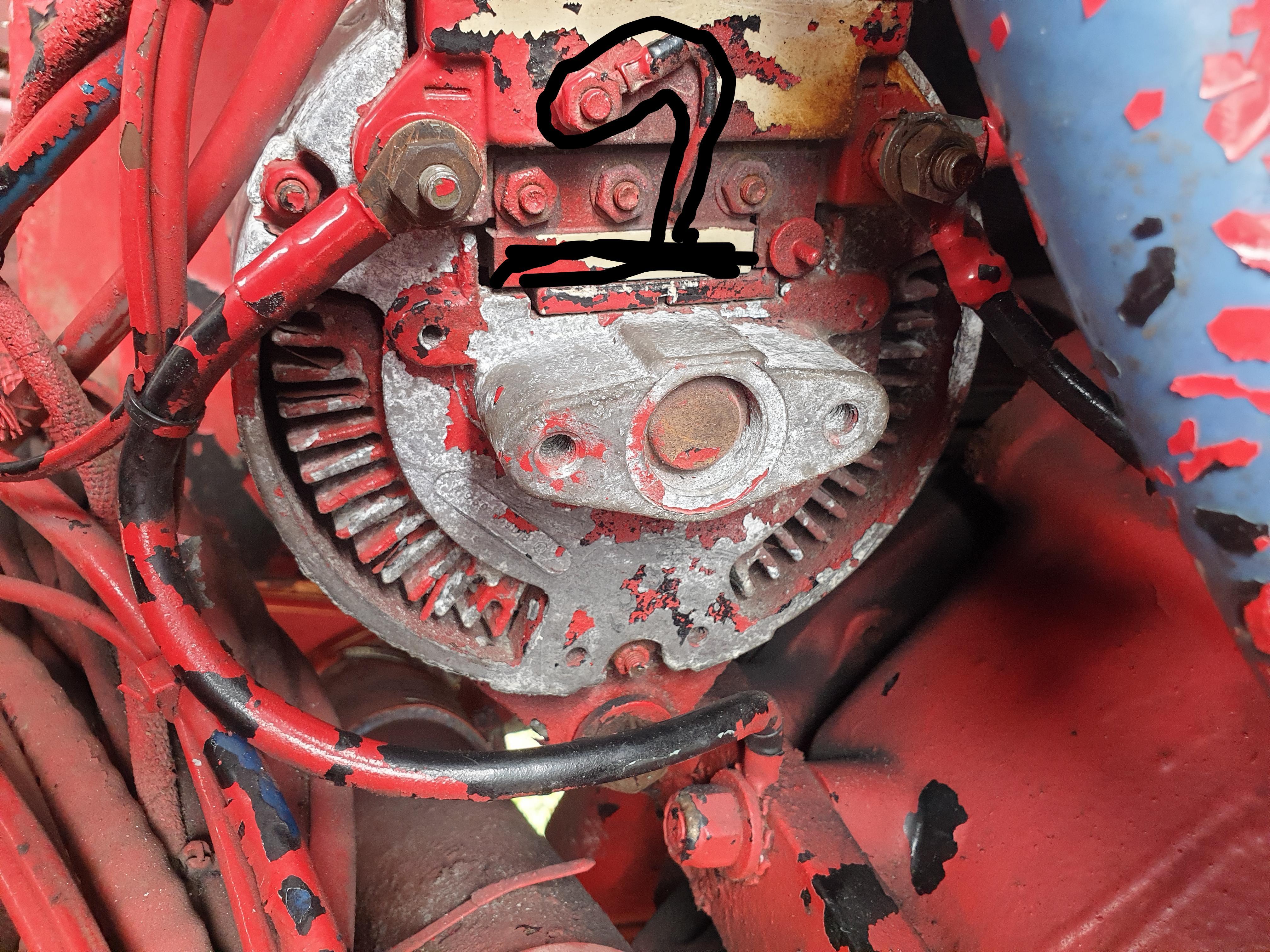

Ok, that is good news, You do have power to the alternator, so a wiring fault between it and the batteries is unlikely.
In North America these are referred to as "one wire" type alternators, A bit of misnomer on the L/N because the case isn't the "ground" for the alternator. They "turn on" by residual magnetizem in the rotor producing a small amount of current in the stator, which runs through a separate set of diodes (diode trio) and is fed  back into the field (rotor) regulator to turn it on. The regulator also is connected to the main output studs internally so when it turns on can supply battery to the field.
 The little wire between the two big wires is the feed from the diode trio to the regulator, to tell it to turn on.
If your electrical guy doesn't know this, he may have supplied external power to that wire and the regulator turned on and worked. If that is the case the diode trio is the problem. It is the white piece that is connected to the three small studs and has the wire coming out of it to the little ring terminal up by the regulator. That trio is replaceable
I am assuming (never a great thing) that he knows how to test the output current and main rectifiers when he did get to to charge on the bench. So assuming that is true it looks like you need a diode trio.
