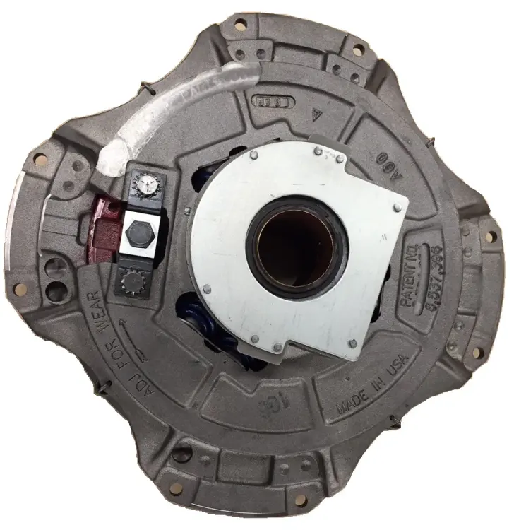

I want to order a new clutch for my 77. It has the  285 maxidyne with a rebuilt 12 speed that i will be installing soon.
My build sheet says it had a CL75 when new. Engine is original to the truck.
What clutch should I look for?. I know nothing about them besides how they work.
Thank you

Have you considered a flywheel from an E-7 ? Its 15 1/2", and you can get an Eaton Easy Pedal clutch.  You can also get it in H.D. more springs and paddles. 9+7...

I have not considered anything because I literally know nothing about what clutch fits or can be retrofitted.
I'm just trying to keep it simple as this truck will never see more than 285-300hp.  I just want a bolt on and go. If there is a reason to swap flywheel I will but if it's not necessary I wont.
