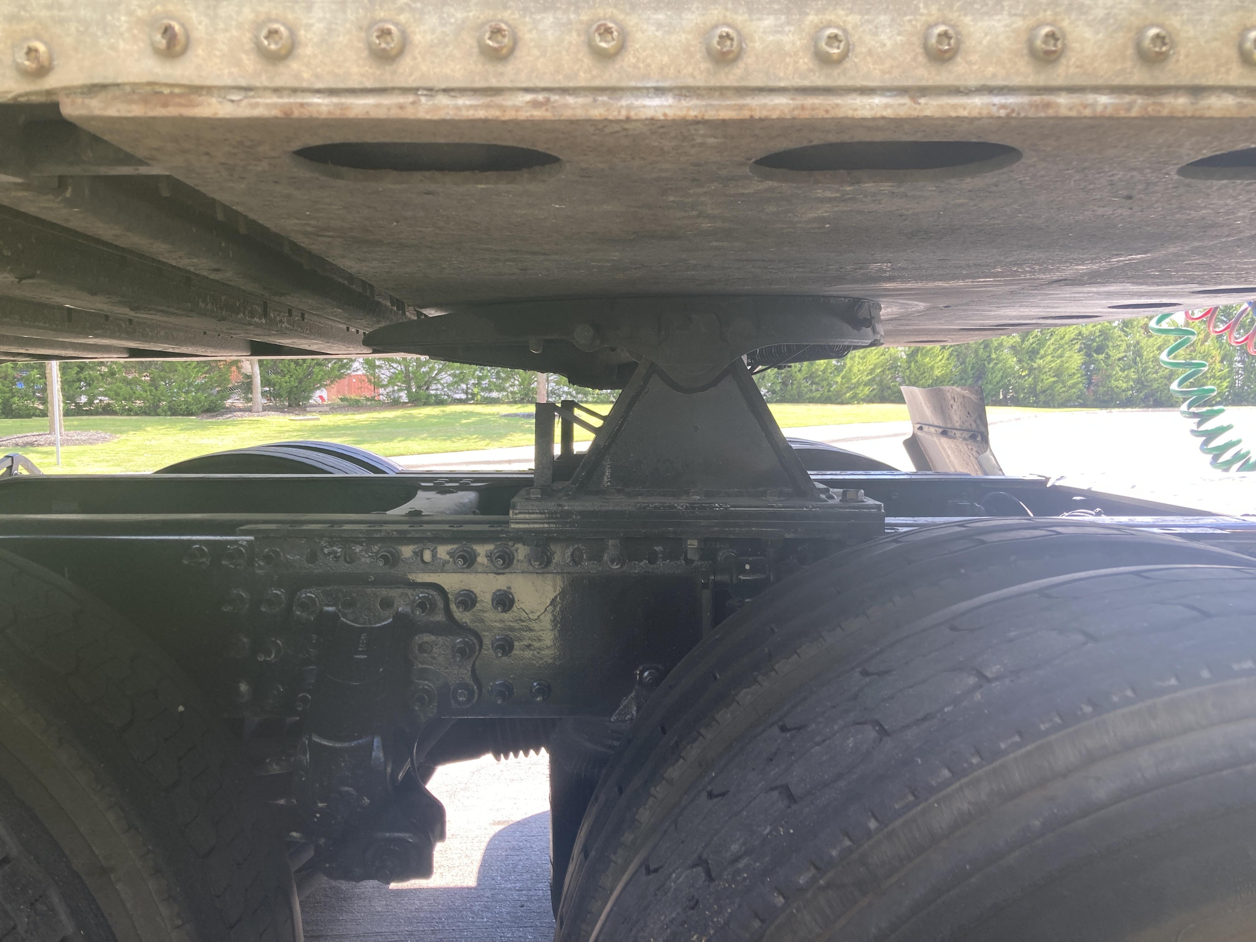

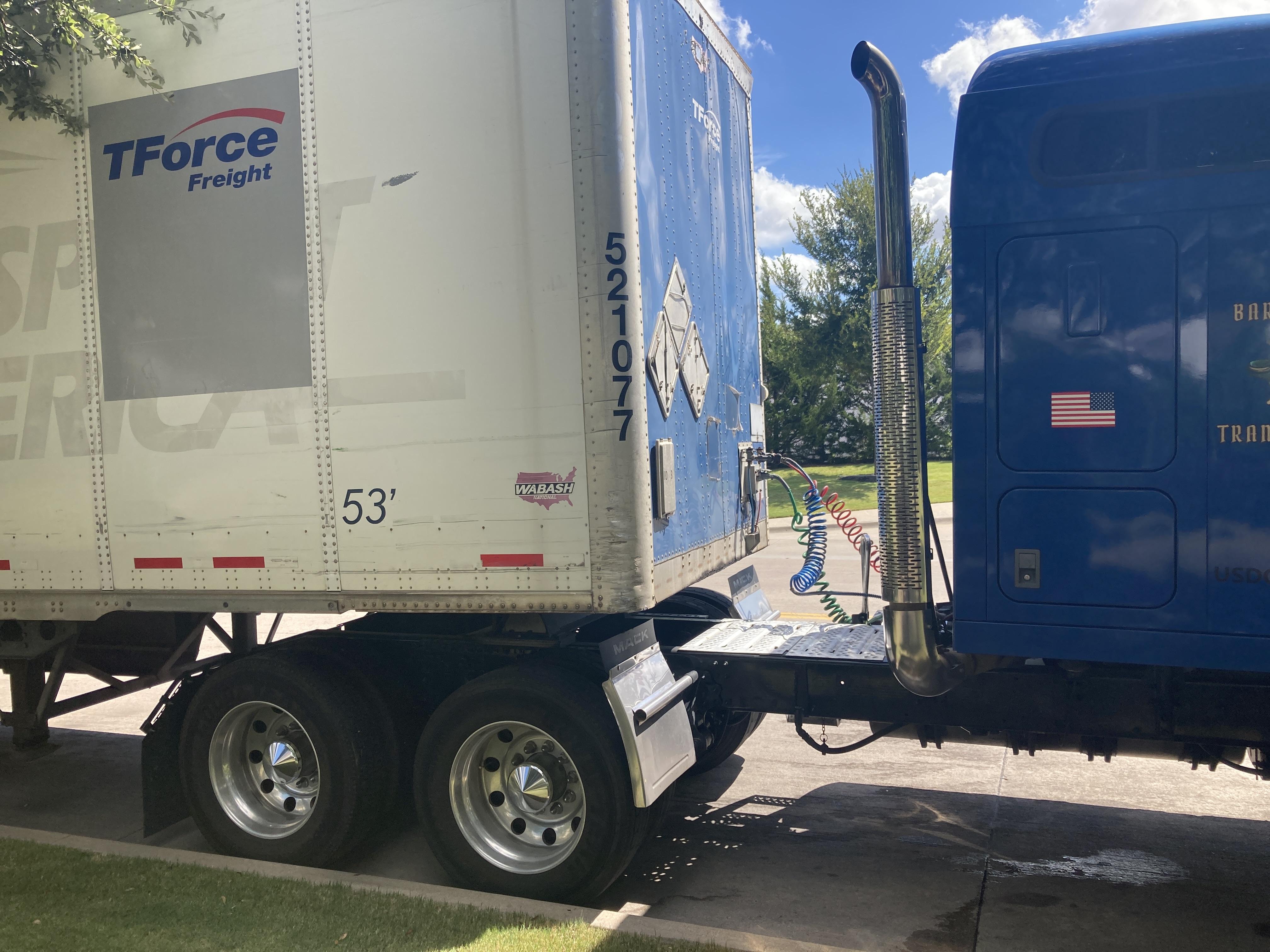

5th wheel sits too high need help
Go to solution Solved by Geoff Weeks,
  • Solution
Every truck junkyard has a ton of mounts. If you stick to the same brand, you can keep your 5th wheel and just replace the mount.
 Otherwise you can buy the whole thing.
 They are not "adjustable". The mount determines the height off the frame.
Geoff is correct. Some guys refer to the part that needs to be changes as "legs"  Might not be an easy thing to find as most bulk carriers used a fixed mounting like that to shave off some weight, and pulling a high cube dry van wasn't really thought about.  You do have some nice angles on the frame with lots of holes already though.  Might be able to get a lower slider on there relatively easily. Just be careful a used one isn't too worn out.  New assembly will be way cheaper than trailer roofs and maybe worse.
