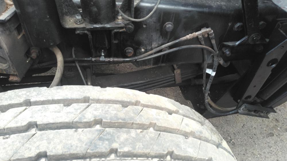

the truck is parked outside.  The problem first appeared before it got cold enough for water to freeze.  The plumbing was reinstalled the same way the original cylinder was plumbed.
18 hours ago, JoeH said:
My lines actually go up the side of the ram and over the frame rail and along side the inner frame rail where they come out behind the front quarter fender to the pump
We got our truck with 415k miles, so no idea how it was from factory, but this is how it was routed when we bought it. "Push" function first T's into the passenger cab mount latch, then splits to go to tilt ram and the driver cab mount latch. "Pull" function just goes to retract the tilt ram.  When the cab comes over center and starts coming down on its own weight it creates enough pressure on the "push" circuit to force the latches back open. Once the cab is seated, the springs on the latches hook the cab to keep it locked down. I assume your truck is the same way, but yours is 24 years older than mine.
Not sure how the "push" circuit creates the resistance during "pull" function to open the latches, there may be a small orifice the oil has to pass through in order to return to the pump. Not sure why you're having the problem you're having! Something must be acting as a check valve somewhere, or the cylinder is binding!
