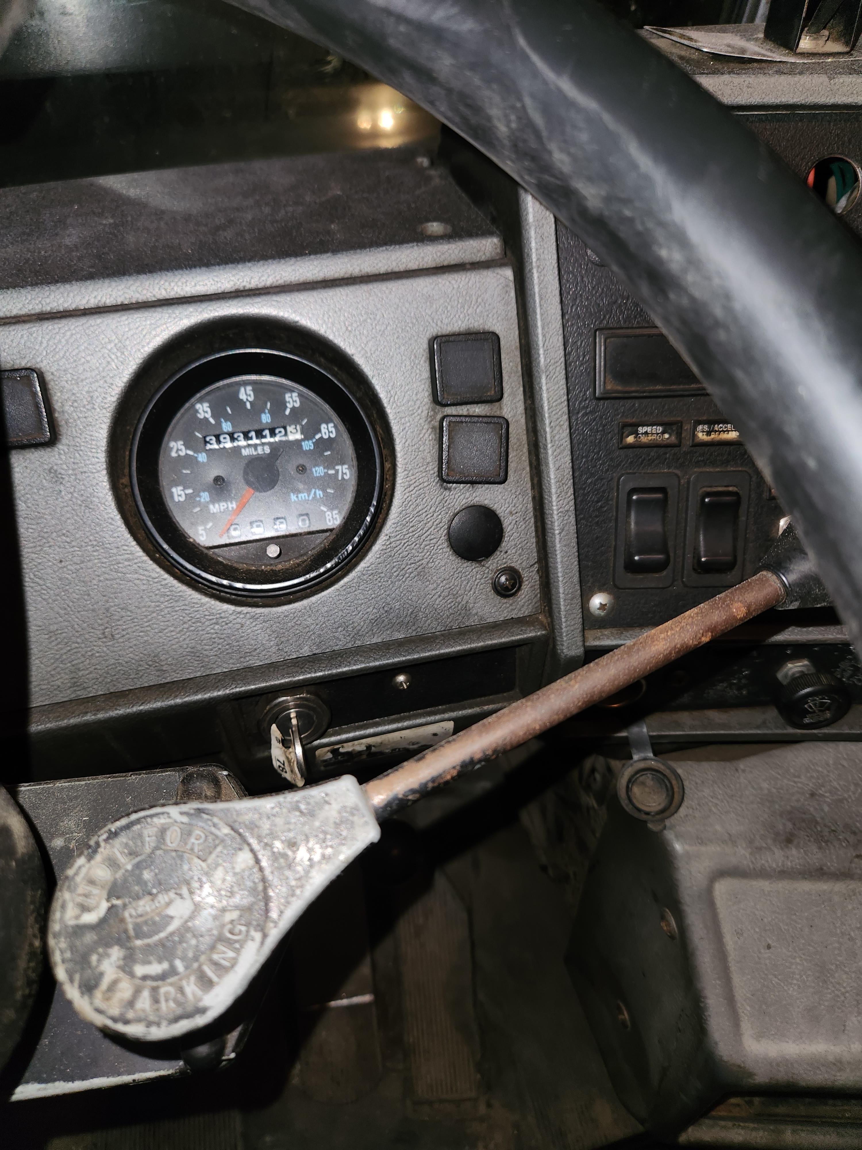

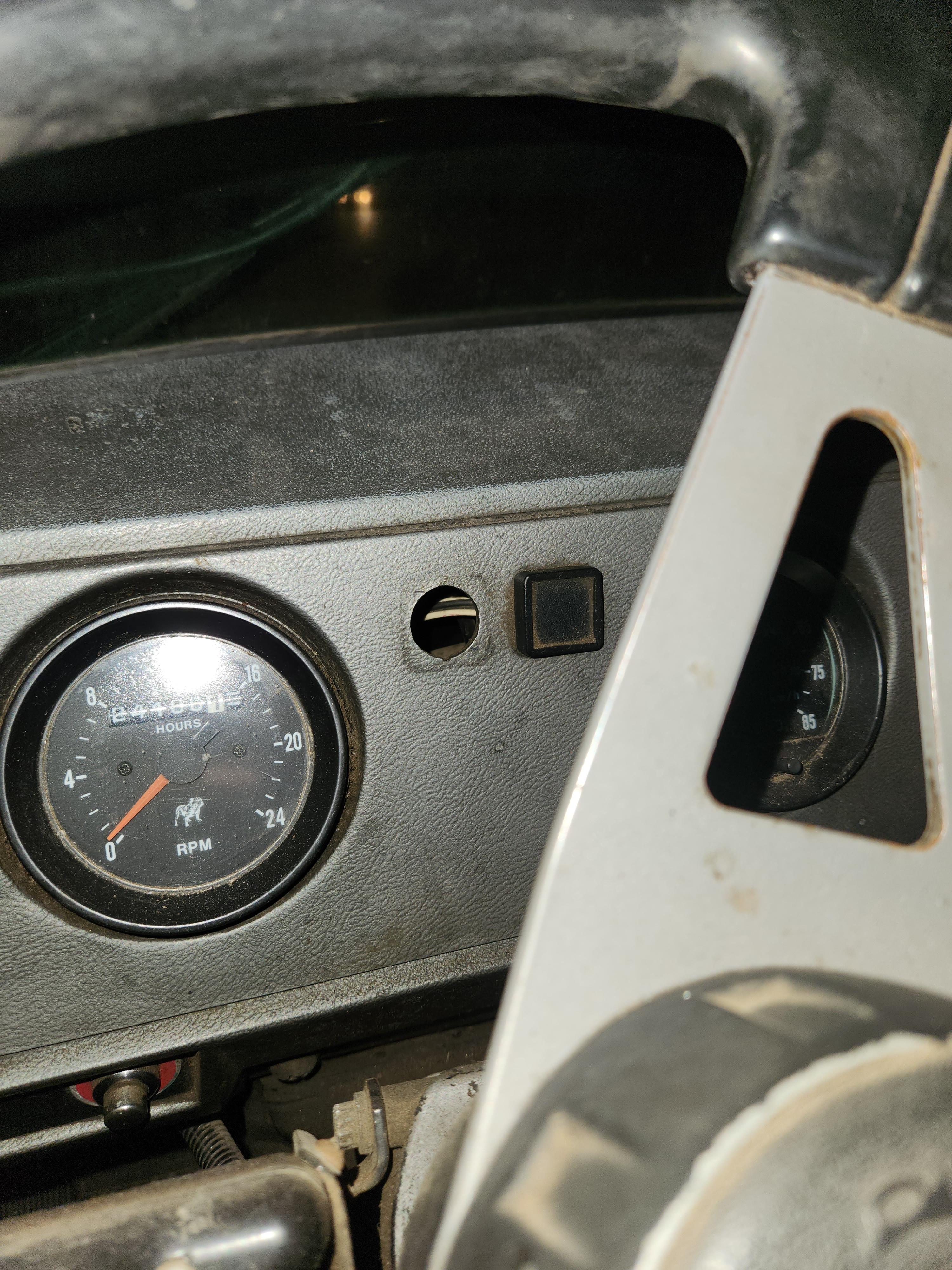

Here's what I'm working with I'll have to pull the dash and puts some bulbs in it I was hoping to work on it tonight but got hung up
Thank you for your help this is my first mack 688s been around truck awhile now picked this up short money was sitting about a year and half guy swears ran fine when parked (company closed up shit just sat ) 20231106_162453.thumb.jpg.ad1f7886b8b51c60d4916e0aaabf90cf.jpg
About 3-4 screws on that top piece of the dash above the rpm/mph gauges and you should have access to those 2 little lights in the center. Looks like one "fell out" (tampered with most likely). Light socket will be laying just inside, and I believe it should have a little tag on it saying what its for.  Get a good bulb stuck in the Engine Malfunction Lamp socket and turn the key to the "On" position. EML 'should' turn on briefly then turn off, indicating that the light works and there's no "Active Faults". If it stays on then you have active fault codes which can be retrieved by holding the set/resume cruise control rocker in the down position. Count the blinks to get a 2 digit code, write the code down and rock the switch down again to retrieve the next code. Post the codes here and Joey will straighten you out!
