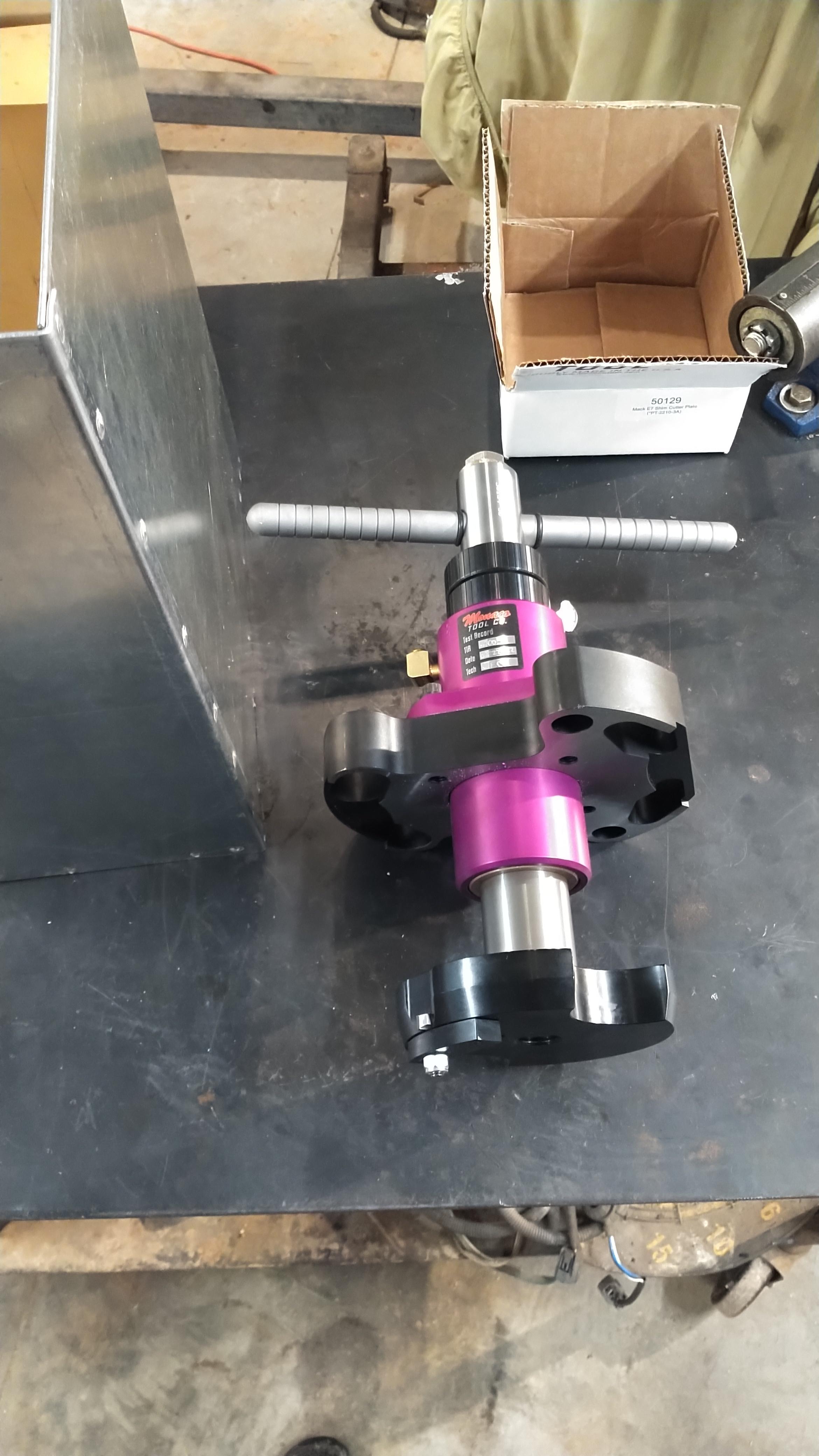

Well Mark, if that's the case.... He is gonna need one of these..  or someone who has one..  I hope it's not that bad..  jojo

too funny,,  It's not that bad, really..  of course my cutters are new and very sharp..  I only take .002" per cut..  It takes a bit longer but there is no fetching up to cause a washboard in the cut..
