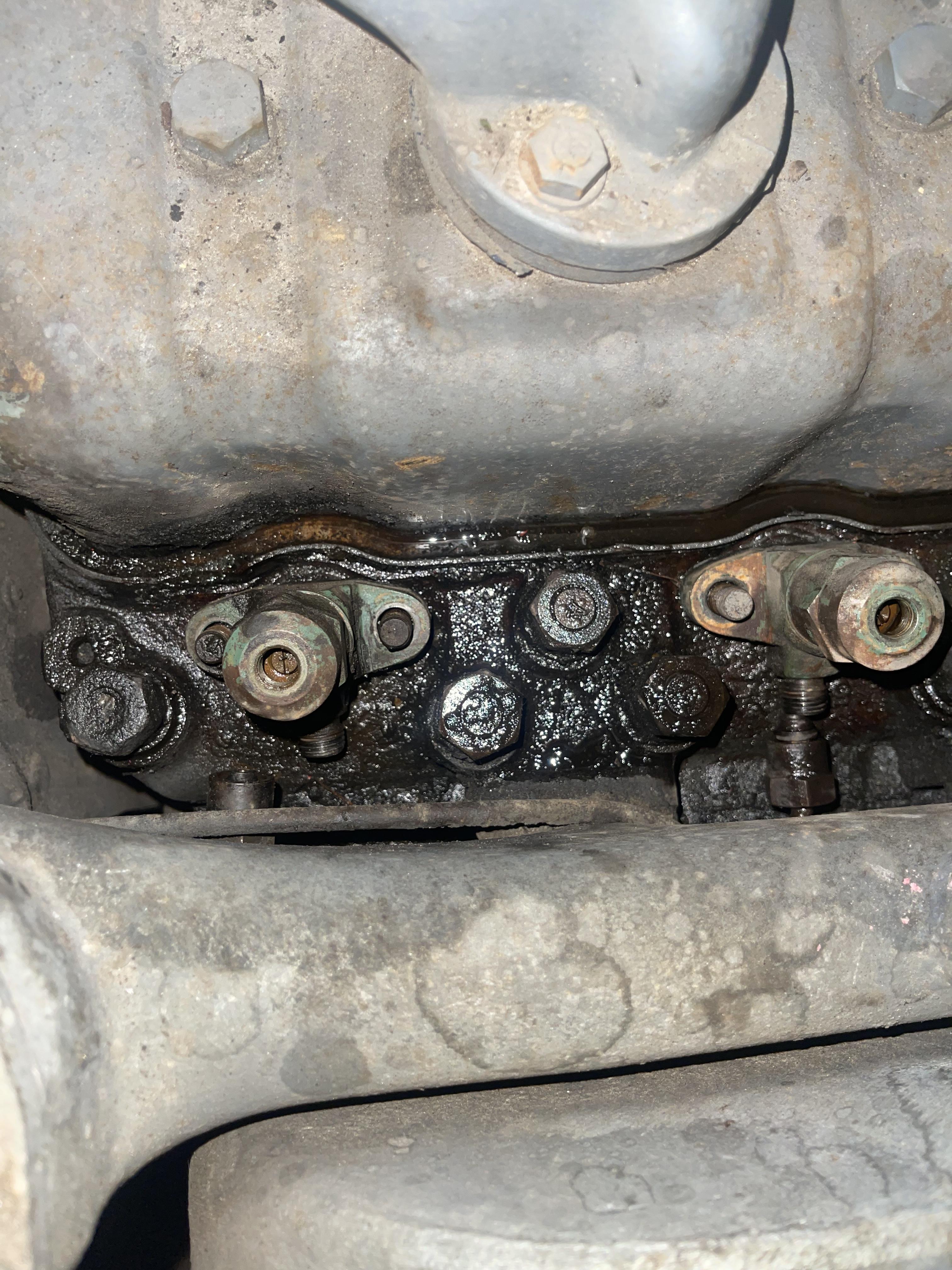

I think the body is original and just had the driveline changed. The vin stamped in the frame is for a b42 and matches the number on the inside door plate, so I’m assuming someone just switched everything somewhere along the way. It has maxi brakes on it and I found the release on the dash once I got it back to the shop. It’s missing the yellow knob so I missed it at first. Got the feed and returns off of the injectors so I can pull them and get some mystery oil and blaster in the cylinders to help break it free. Gotta get the injectors out though as they’re stuck in pretty good. I’ll work on getting them out tomorrow.
