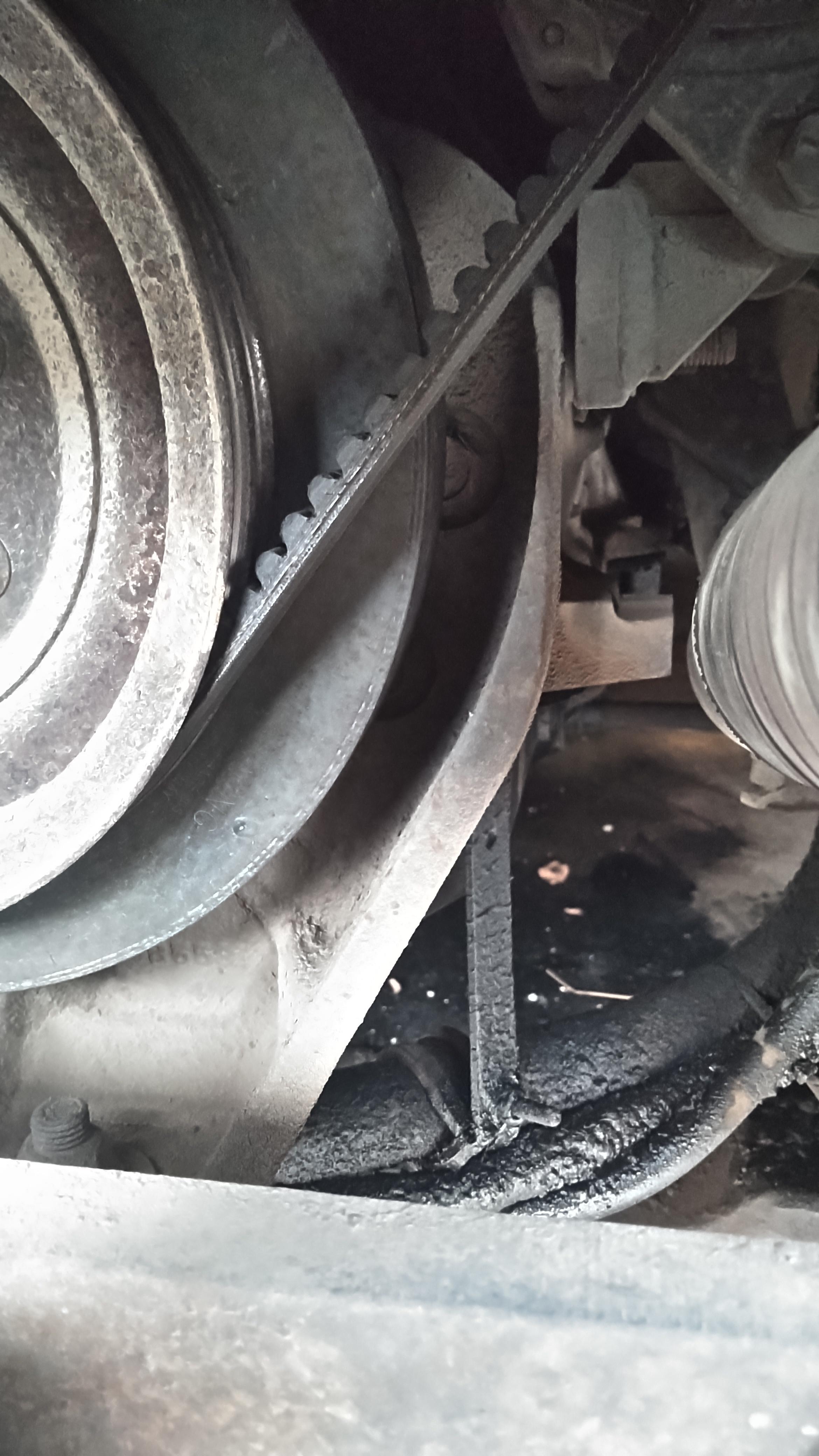

I'll get one tomorrow when I get back to the shop. But it looks like this.
The E6 has a plate from right rail across the front cover and bolts to mount that clamps behind the balancer to the cover then angles behind the stearing box to the frame.

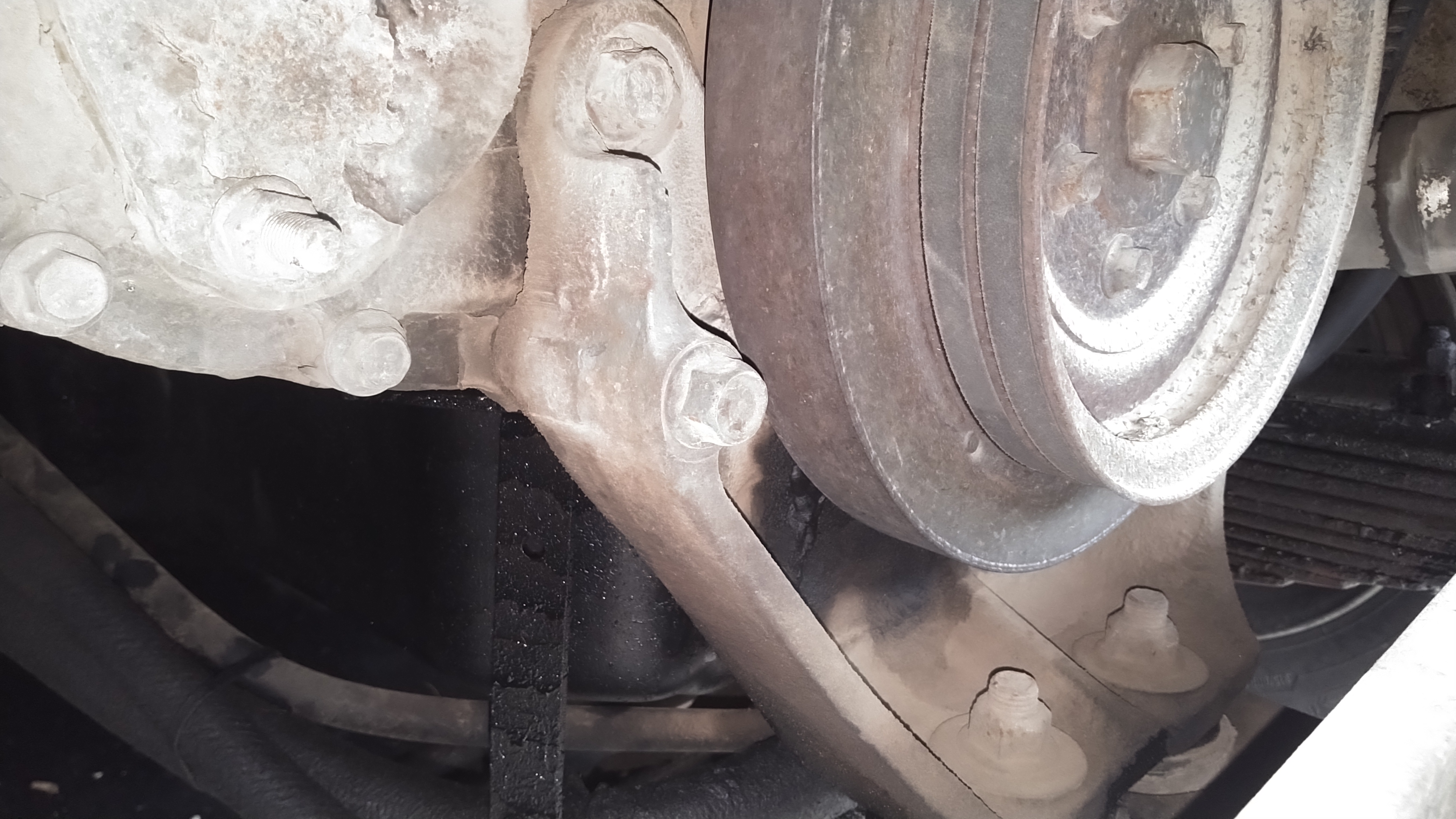

Well in the engine swap crossmwmber saga i'm at a dead end. 85' crossmember is a piece of plate 9/16th thick by 10" tall with a 45* bend to go behind the stearing box that the nose of the timing cover sits in and a gets clamped in. the 94' donor truck has a stamped steel "u" shaped crossmember with an appliance that bolts to front of the timing cover and sits on the crossmember.
Dealer says the vin numbers ive gotten aren't long enough to use "need last 8 at least"
Pic is of the 85' from the top pass. side.
Any more ideas?
