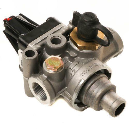

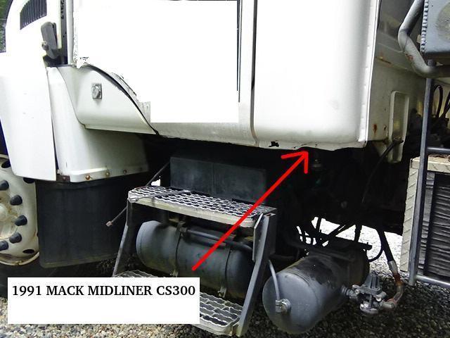

Are air dryers purge valve combination universal to trucks... I have a Mack midliner and I'd like to change the purge valve but it is very difficult to locate so I'm wondering if others can be used
I wish I could remember how the air dryer is mounted on the Midliner..  If it's remote and not mounted to the tank, couldnt he just buy an AD-6 smaller air dryer and install it, then re-build the hoses, input/output, and route new ones?  Just curious, and if this can be done then you will have a modern, easy to get parts for,  air dryer...  jojo

Neo,  It seems to me you have 3 threads on this issue..  in this last post you said you CAN get parts for a Midliner..  if you CAN get parts for youre Midliner,  then you are sitting on a gold mine... I have a Book coming my way, if there is info in it that you need, I will try to share it.. I still think you can remove the old air management system and mount a small air dryer that will have the purge valve in it. as far as the unloader valves, those should be in the air compressor head..  jojo

I have pulled the compressor apart..... It's very basic.....just an inlet valve and discharge valve...that's it
