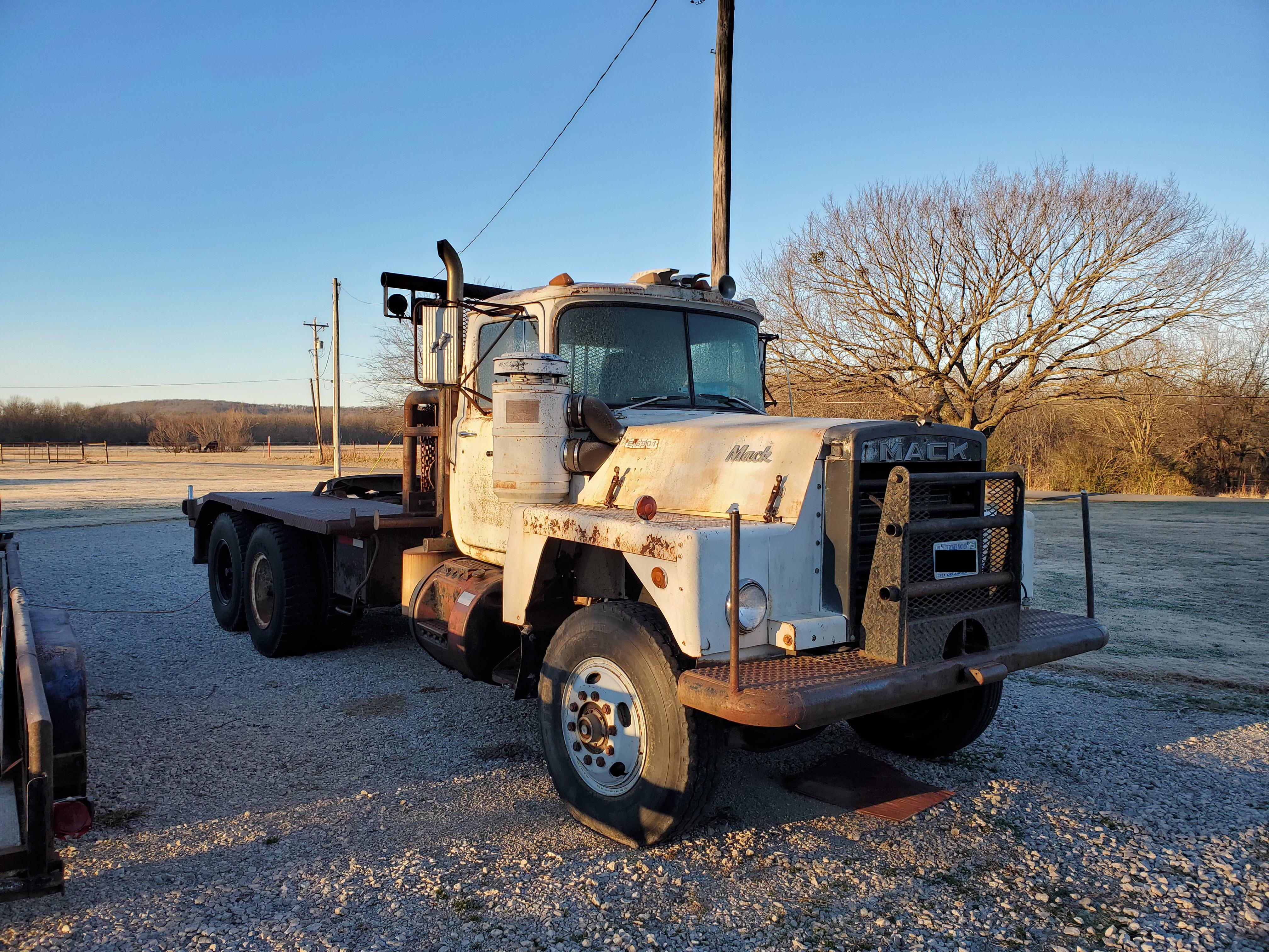

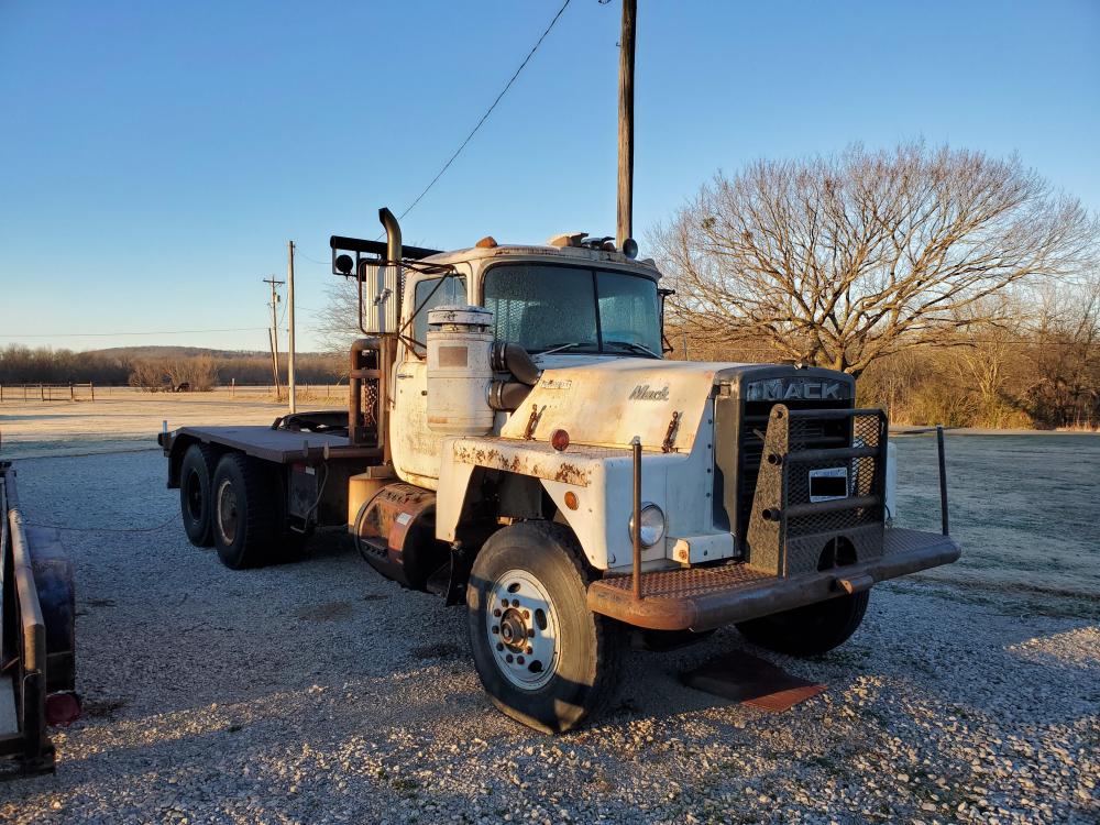

Hi all,
New here and we have an older Mack we'd like to get some info on if possible.
I tried using the VIN decoders, but they ask for a 17 digit VIN and ours is only 10 digits.
VIN is RD686S7201
Thanks for any info and I am sure we'll be asking a bunch of questions!
Edited by Wirlybird
8 minutes ago, Steel Nose said:
That truck was built 01/07/1980 That was before they were using the 17 digit vin numbers. ENDT676 engine (285hp) TRXL107 transmission (6 speed)
44,000 camel back suspension CRDPC92/CRD93 Carriers 4:17 ratio FA617C front axle
Hope this helps
That is great info, thank you!
Was there a model number/name?  Like Rd?
