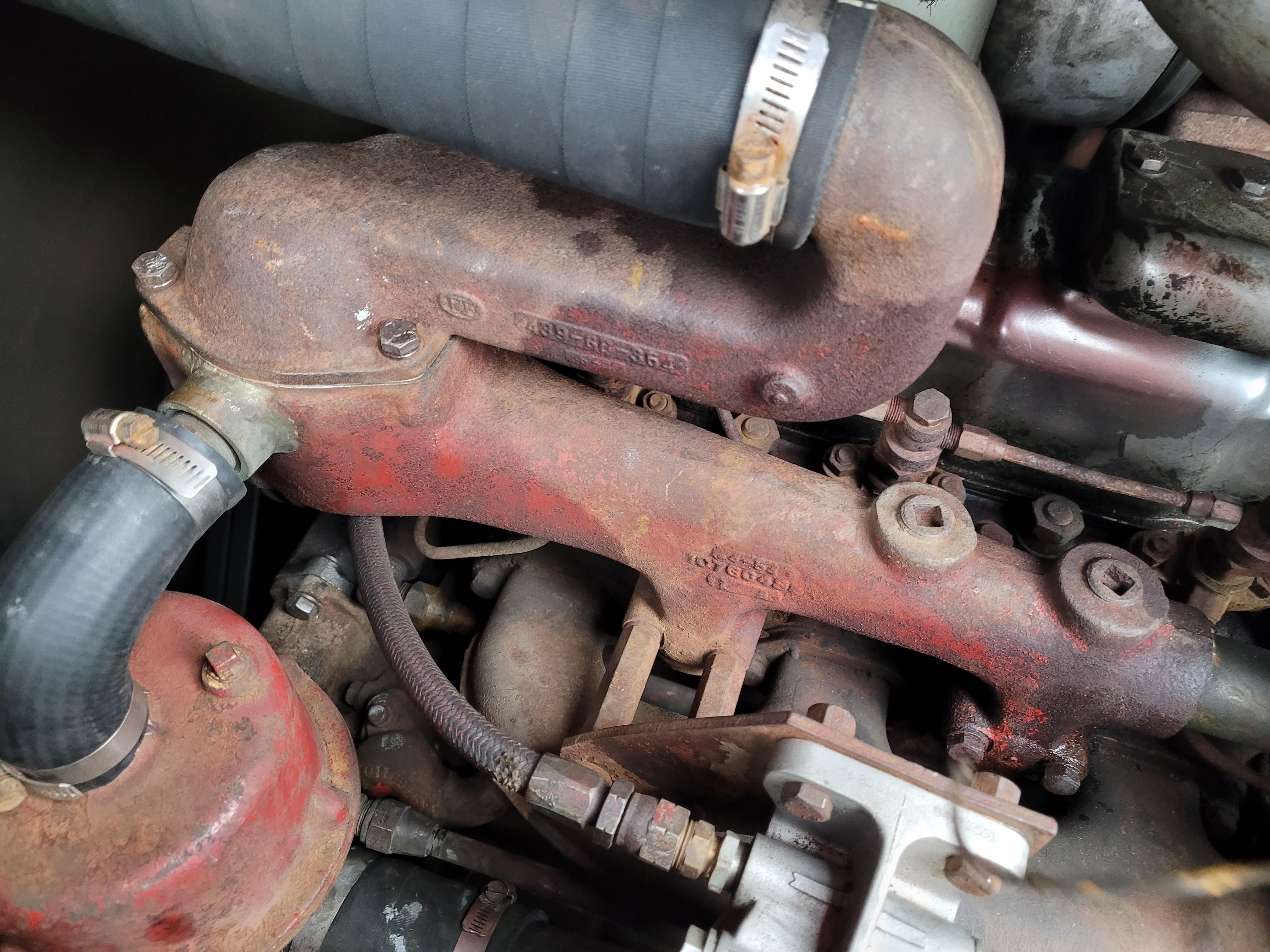

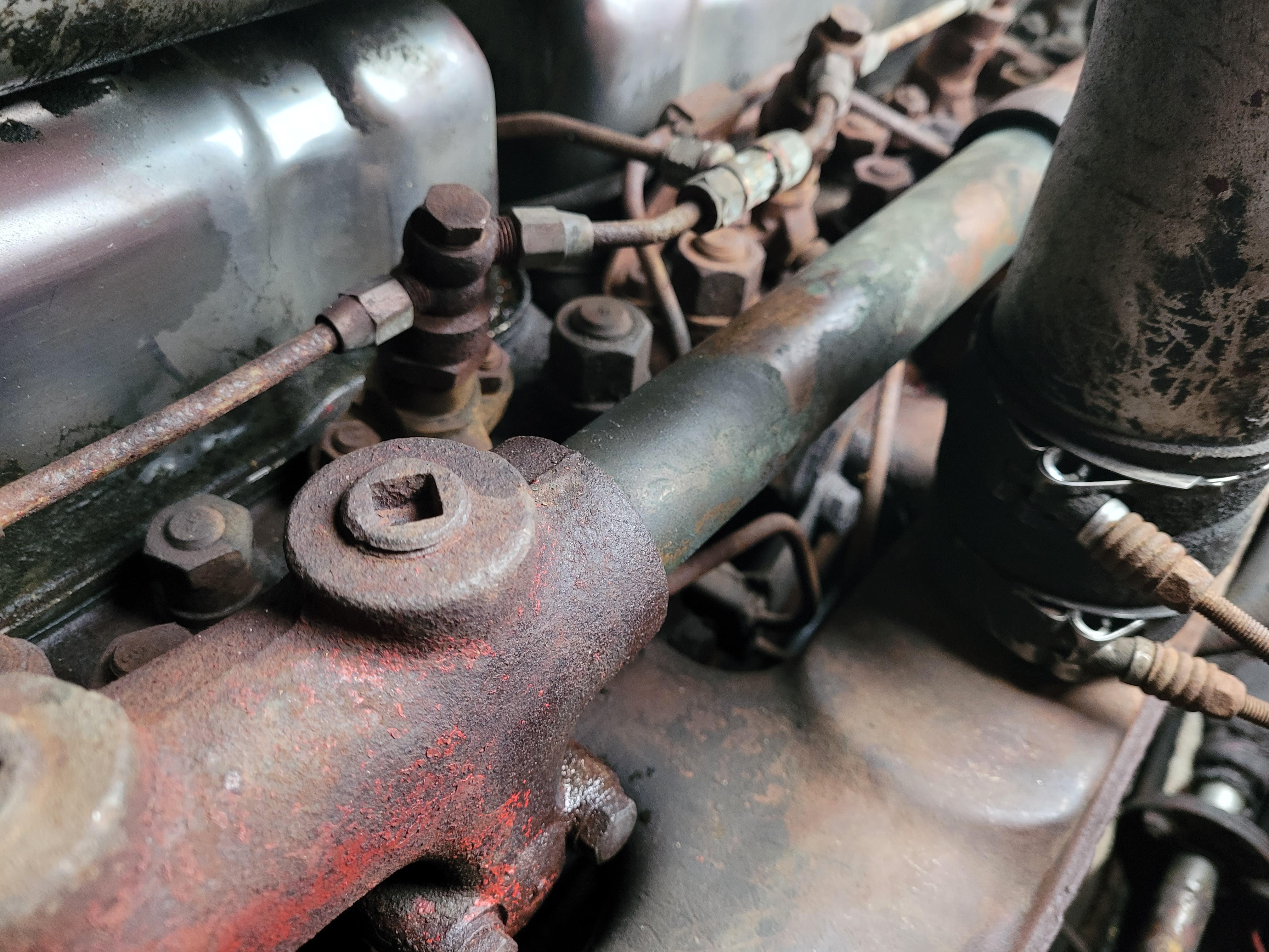

Anyone have a part number or any info on this?. The housing is leaking between the pipes and I am certain it has O rings however the pipe itself looks bad and it requires removal off the entire cooling system intake part or whatever it is called. Any help is appreciated. Thanks
Morning,
Those pieces are the water manifolds, the front one has the thermostat in it. If you pull the back one you can take out the pipe and see what the problem is. Most likely just the O rings cause those are the cast iron manifolds. If the brass is gone you have to get one from a junkyard. Or make up your own pipe with a combination of rubber hose and the brass pipe.
6 hours ago, muncieman said:
Ok thanks. Any idea where I could get a gasket set for the manifolds. It appears I'll need to take 1 end or the other off. Thanks
piece of gasket material and a small pall pien hammer and tap lightly on the edges! will punch it right out.   terry:MackLogo:
