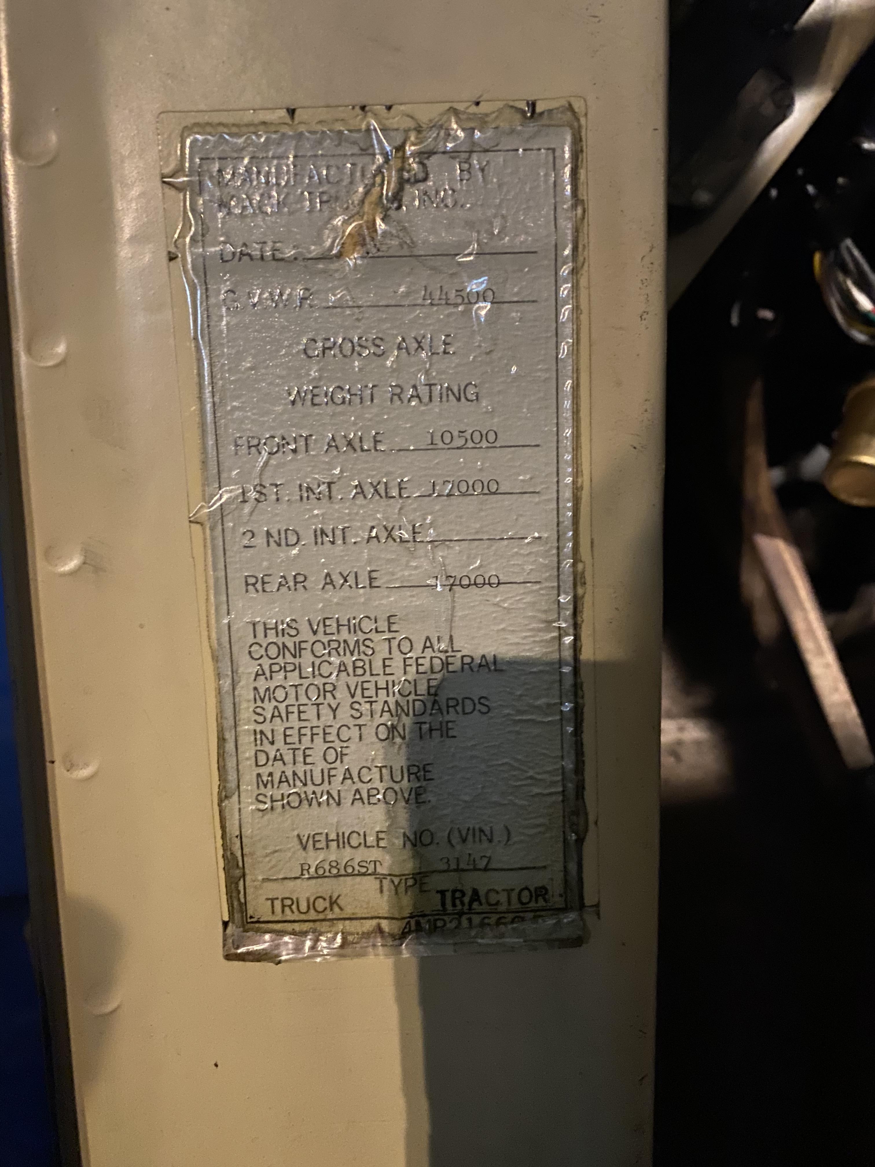

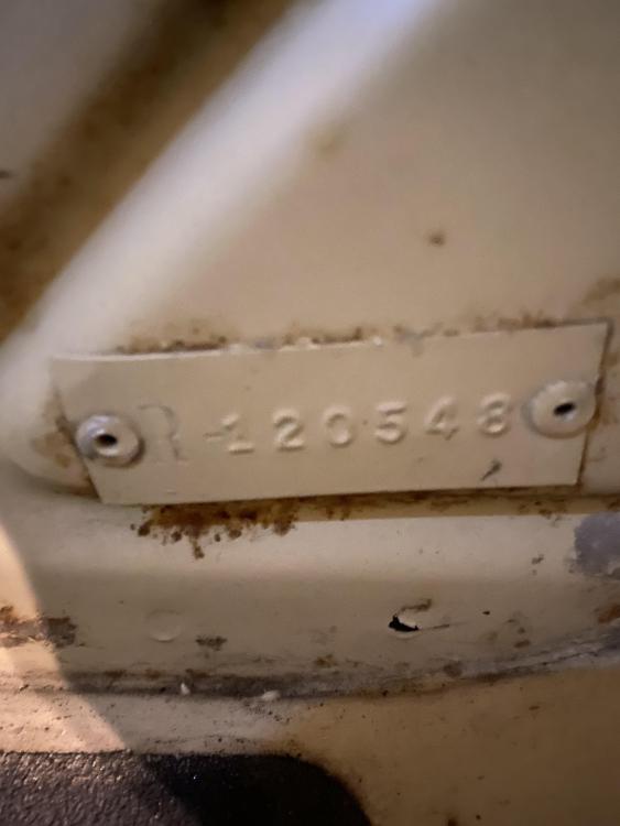

I have recently been tasked with helping a family member liquidate some vehicular assets to help avoid financial hardship. He has an older Mack R Series day cab tractor that I'm trying to get some info on. Don't know where to search for the 17 digit VIN-or if it even has a 17 digit VIN. I have a photo of the VIN/GVWR sticker from the drivers A-pillar and a tag that is riveted to the drivers B-pillar. Photos attached.
From my 3 hours of googling thus far, I haven't really been able to come up with much info on it, especially since I don't know what year it is. The local dealership was of no help since its an "antique" to them. I was hoping to get some more solid info/guidance on where to look and what to look for to get this truck properly identified and inventoried for future sale if need be.

go to the front of the frame rail behind the left drive tire, you should find the whole vin. stamped in the frame there should be a "Bulldog" stamped before the no.  ... jojo

That "R686ST" on the sticker (if that's the original number) tells you a lot.  Like Jojo said, check on the RH frame rail and see if the number matches.
I think the 686 uses a 283 HP Maxidyne engine.  That information is on here somewhere (wiki?).  Normally, there is a plate on the engine that lists HP and valve clearances.  Maybe it's 2 plates.
The "ST" means it is a Six wheel ("tandem axle") Tractor.  Or, at least that is what it started life as.

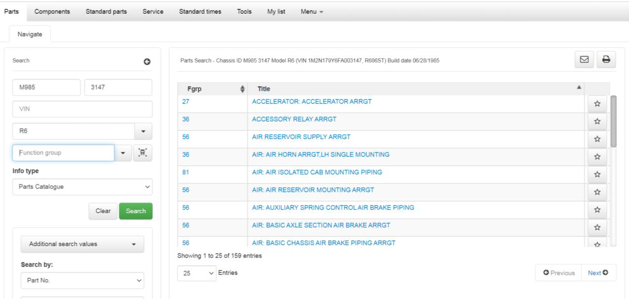

This is what I was able to find with the info off of the picture.
 VIN 1M2N179Y6FA003147
Model R686ST
Build Date 06/28/85
Engine EM6-300-4VH

I was able to muster this info up on the build sheet. According to the Mack/Volvo mainframe this vehicle came up with a 17 digit VIN. I am sorry if I am misleading anyone.
V
The 17 digit VIN should be right if its post 1981. I know the R-series trucks were mid-late 60's to early 90's production so I really wasn't sure what to expect in terms of VIN # format. I'm not near as big into TT stuff as I am older Ford/GM/Mopar stuff..

Sorry. Had to step out for a while. I was thinking it was sometime in the 80s when the 17 digit numbers came out, but wasn’t sure exactly when. On my ‘70, the title had the vin listed as R611ST5525. It had no 17 digit number. Maybe vmac can confirm this, but it looks like, on the truck in this discussion, they HAD the 17 digit number, but just listed the last 4 digits on the door plate.
