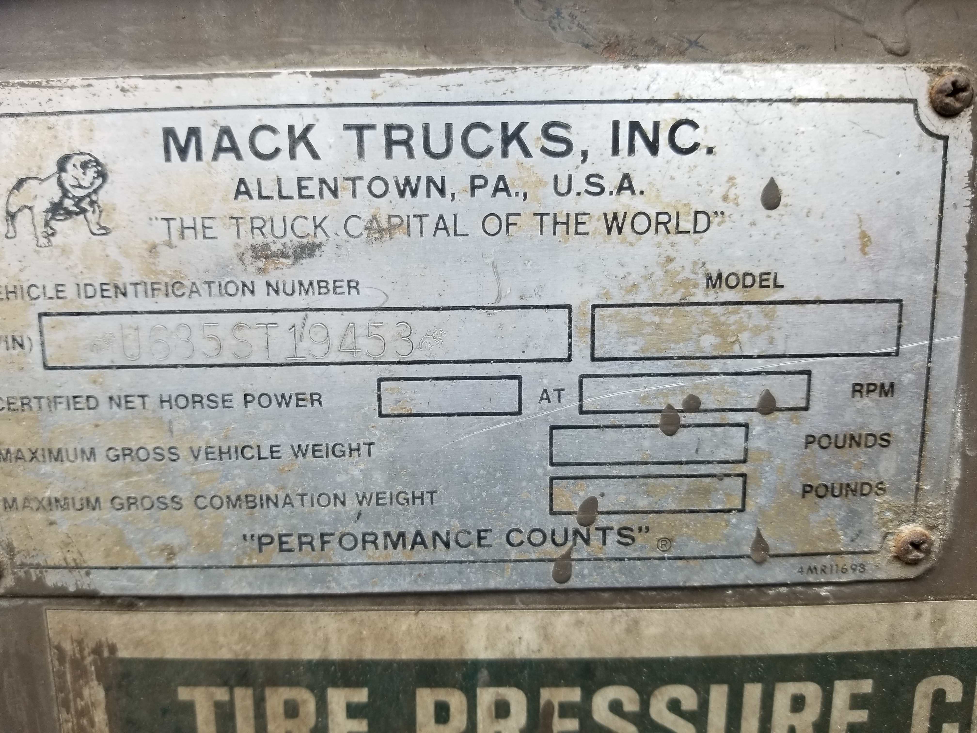

Ill be posting pictures soon when I get her home. Title shows it as a 1980 Mack, and thats it. The vin is u685st19543 and matches the door plate. Door plate also shows Allentown PA. Only the vin is stamped. Everything else is blank.
I believe this to be an U, but thats as far as I can come come up with and thats simply comparing it to pictures in google. The cab is offset. So my understanding is this is an R series, U model. Being shorter than the R and an offset cab.
Anyone have resources they can point me to in order to decode the vin? Also looking for shop manuals so I can start wrapping my head around this Mack platform.

Welcome aboard and congrats on your new to you "U" .
There is a lot of good info and helpful people here.
Here is a useful link to some info on VIN numbers.                                                                                     https://www.bigmacktrucks.com/topic/51420-r-model-vin-decoder/?tab=comments#comment-382830
If nothing has been altered, you have a U model tractor with tandem wheels. A Maxidyne 237 engine that is absolutely bullet proof.
I think most 237 's were backed with either a 5 speed or a 2 stick 6 speed tranny . But could be wrong about that.
You will have yourself a cool project . Hopefully you post lots of pics .

Thanks for the response. It is a five speed the best I can tell. Or at least I could shift into five slots and I could not locate a splitter and it did not have a second shifter.
Hoping to find some shop manuals for her. Cant wrap my head around Macks naming and numbering system yet.
We are putting batteries in her tomorrow to get her home. Only 57000 original miles and the engine looks super clean. So im hoping she is solid mechanically.
