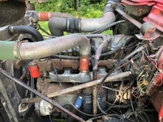

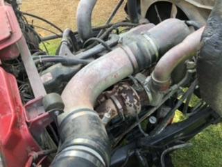

I’m looking for the engine info for my 89 RD688. The number on top of the timing cover is 8P1393. I have tried and tired to figure out what this mean with no luck. Any help would be appreciated!
Should be an E7-350 or an E7-400.    Paul
possibly  ! have a look It could be anything from 275 to 350 what trans does it have?
If it has a 12 speed behind it ! will likely be a 350 ! if it has a 8 or 9 0r six speed it may be a  285M   300 M !

How can you tell?
Pretty much what FJH said.   Few years ago I bought a sight unseen 82’ R model that the seller stated that he had an E7 installed into it and new frame rails 5 years prior.  Get there to pick it up with the lowboy and low and behold it was not E7 but an old 2 valve motor.   That’s when the renegotiating started.  The cab was shot and I was essentially buying it for the frame and the engine.
8ll trans
Yeah this is my first big truck and don’t really know what I’m looking at and having a heck of a time getting any numbers I find to match something on the internet.
