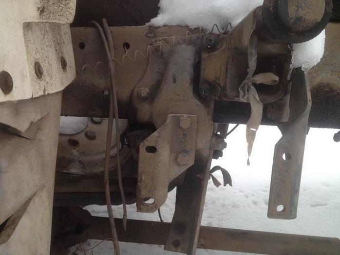

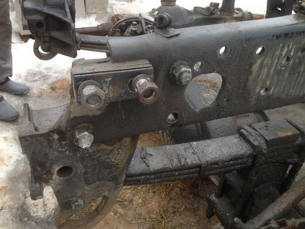

The pics are what my RD690 donor truck had. Difficult to figure all original specialities since the truck was modifyed by installing of a front drive axle and the rears put almost below the main rails as a section of a DM (judging by the rail heigth) chassis. As you can see the rear brackets were generally similar to R-model style but slightly different and cast iron. The front ones were completey another story. The hood attachment was also another but that makes sence since it was for a newer style square hood. Now seems it worth to me to measure the heigth of the frame rails at the front and relate to your figures. So far I expect the same range figures but it's a guess. The rails are separated and stacked aside a barn. So very easy for observations.
You're right. Those RD rails are absolutely decent. That was a double frame and the truck spent the most of its life at extreme North with about no public road driving being an oilfield equipment carrier. So no salt and probably not much driving at all. But the VIN stamping doesn't suit my needs and the front spring bracket differences adds salt to the dish.

Maybe on a positive note. Maybe the bolt pattern is similar to your R688 ,even if the brackets are different.
Looks like they are. And the rear ones also. I was wondering the cab mounts position but after you investigated the rail goes down there that's not a problem either. The problem could be the rears since mines are Neway and the lever brackets fit to the rails by the lower flange. I suppose RD's with Neway are a seldom view if any but that story must have working solution in RW700.

Seems like you're almost right. My R688 of 1988 has rad sitting lower in the chassis being attached not almost the way you described yourth (I suppose you just didn't figure those points completely) but on a pair of brackets which are a thick bent still bolted to the inner side of the front spring brackets. They're not at the top of the frame rails but just a lil bit lower. Actually I don't expect to see anything else on your R and RD688 but I can never be 100% sure.

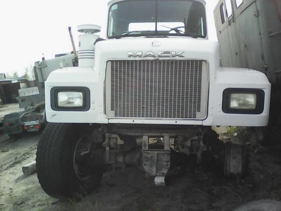

My RD690 you shared a pic of the front bracket of indeed had a different rad which seated higher off the frame. It was not exactly the same style as in your truck but also had a pair of legs it standed on the crossmember. Actually there was a rad support bracket the legs were attached to. You can see it hanging down in the picture when the truck was still looking as a truck. The crossmember also holded the front of the engine by a kind of shelf welded to its inner (rear) side. The previous owner stole the engine to put in his Freightliner so he took the crossmember off for the install. The rad bracket was bolted to the front (face) side so it stayed hanging on the rad which occured laying on the front frame rail ends.
