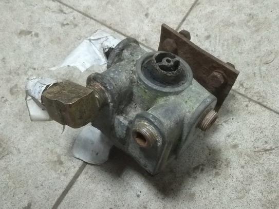

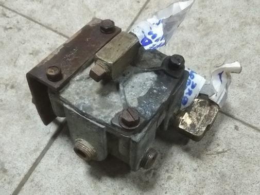

Bendix R12 brake relay valve
Vladislav
Going to buy a new pair of such ones to put on my R-model.
Went through flea-bay and found they differ about port locations and some marked as 4 pci crack pressure.
Also I noted there's plenty of different (Bendix) part## which didn't have much in common.
A question - what should I look for making the choice? My originals valves have tags gone. The truck is a long wheelbase R-model tractor unit which is most probably supposed to drive without a trailer and just for hobby reasons. The pics are what I removed from 31 y.o. chassis and they looked being installed there at the factory.
Thanks in advance, Vlad

Thanks for the info support and the offer. I will keep Bendix one in mind. Would like to go with two almost similar ones. And I have no less than a year to find them. Just slowly collect parts required for the project.
Ok, a point to note - 20QE458 doesn't cross to 103009 (4pci crack) but to 065125 with 5,5 pci. Wonder how that difference in crack pressure is sufficient for brakes operation?

Swishy, mate, thanks for clearing me up. Now I'm not that blind in part ## jungles:)
