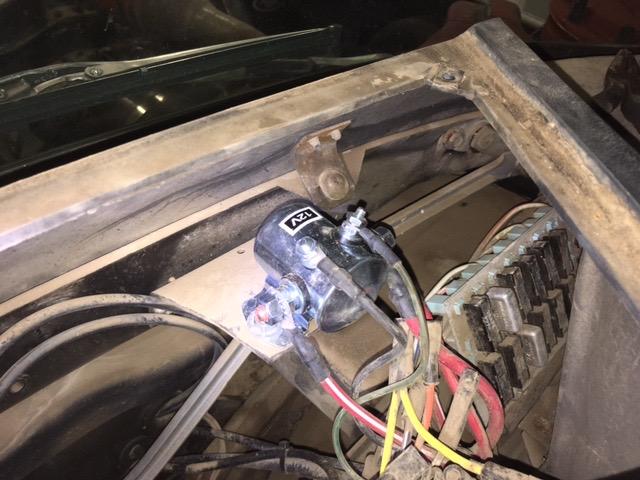

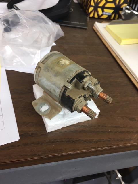

I just replaced the dash solenoid in one of my Macks . I told the parts man I wanted a 2MR2114 solenoid. He gave me a Mack/Volvo part # of 8609-98226WR, the same part # as the very first post. The part however looks nothing like the original. I just wanted to share this and some pics for the next person that thinks they may have the wrong part ( like me ) .  Good news is it goes on no problem, and works like it should . :twothumbsup:
This is the original
This is the new one
